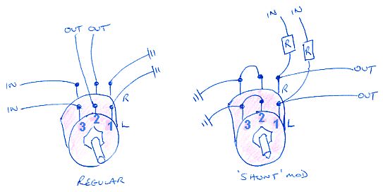

I did not see a resistor in the DACT link. I want to add a Allen Bradley NOS carbon composition resistor somewhere before or after the potentiometer to add a cheap softness for the sound. Something that will slightly mimick the concept of the Decware Zbox but spending $1.50 instead of $549.00?
CD player is an Onkyo C-7030 and the amp is a Dalaudio Retro 3886. This amp has no volume and requires a control. Why 10K vs. 100k?

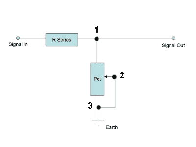

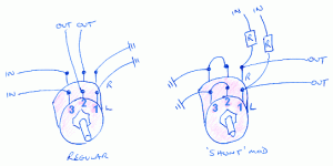

If you want to use a resistor to add character then connect it in "Shunt mode."

NO, read the article!
The shunt resistor should be close to the value of the potentiometer.
So for 10k a shunt of 9.5k would be appropriate. (1/2w is appropriate)
Read and understand the wiring diagram, it is reversed from conventional pot!

What value of resistor for a 100K PEC?
(I will be transferring the POT to a cathode follower buffer a few months from now.) Has to be 100K POT.

For a 100k pot
use a 91k shunt. (or as close as you can get)
