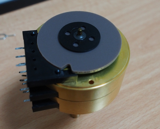

Hello everyone,

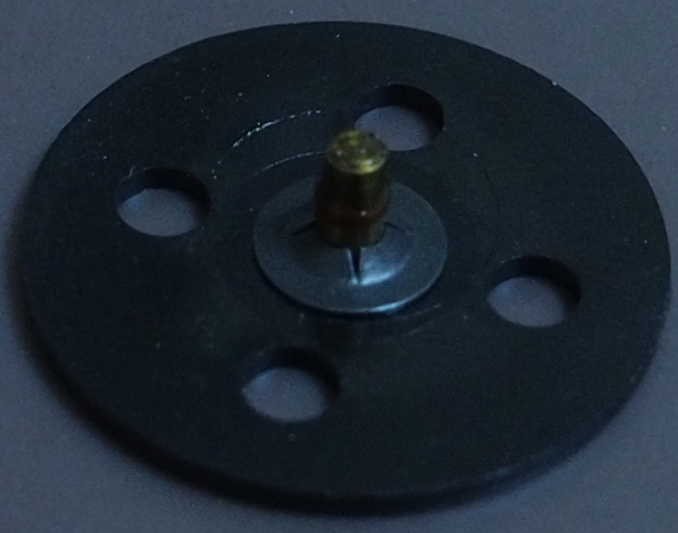

I have a rather special potentiometer that I want to disassemble and clean. Unfortunately it's held together by some kind of friction plate that's been forced onto the shaft. I don't even know what the thing that's holding it together is called so I can't look up ways to remove it safely. Does anyone know what this thing is called and how it could be removed without damaging the potentiometer (see the second picture)?

I do not know "why" you want to clean it...is it a noisy? Because if it is not, do not open it. if is not broken...Do not fix it😉 But to take out that thing out( it looks like a safety washer), you can use a small thin flat screwdriver and open some of the "wings" that are holding on. do not worry if it brakes, you can always find it at any big hardware store.

Them thar things are called "retaining washer"

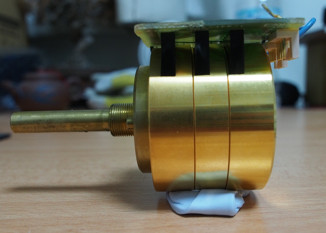

The pot is a stack of three metal cups, with each one containing one plate/brush assembly. The back cup is held on with three long screws and can easily be removed, but the rest are held together by the tension from that retaining washer on the shaft.

I've attached a picture from the side for those that are interested. As far as I can tell the casing is gold plated brass. This was pulled from a Sony TA-ER1.

This unit ought to come apart, as it did go together. Your image does not show the method of construction. Do not drill it, that will likely put metal particles inside the housing.
Snap rings can be removed. Show the snap ring?
If you take it apart you may find this is a fancy housing over a standard pot unit inside. May.

The second picture in my first post shows the retaining washer. I may be able to get it off, but will probably destroy it in the process, so I'll look for a replacement.

The first picture shows a retainer that holds what looks like a gear - that is not part of the potentiometer itself.
