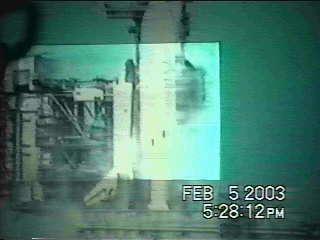

Successful test...
You all got me thinking about screen possibilities. Someone mentioned about silver screens so I did some surfing. It seems that silver screens are used more for 3D projections ( at least that's what I read). But I noticed there was some talk about pearlescent screen materials.
First I called Screen Goo to see how much it would cost to get enough goo for a 100" screen. They said $137. Too rich for my blood! So I started researching pearlescent screens.
I went to the paint store today and bought some white pearl lustre paint and painted half of a piece of foam board.
The pearlescent side was much brighter and the colors had more excitement to them (they were brighter) It looked great! The only problem I had is I had some streaks on my board. Hopefully when I do the real painting I will put more coats or do it more evenly and it will be more uniform. I know the ideal thing would be to spray my wall. But I am terrible with a sprayer.

great comparison m8, first I gonna use blackout cloth, but gonna
test bright white jeans also, it's bright white, and should be good use. I saw it in the shop and the man said he used it for his dia projection
yeah, looks very good man...

I did some more testing on the pearl luster painted screen today. It works well except when viewed at an angle it looks a little darker. Unfortunately because of the way my theatre room is laid out, half of my sofa is away from the centerline of the screen. But it's hard to tell because the dumb foam board that I painted as a sample is curling up so I don't have a flat surface anymore.
I think I will paint the wall bright white first and see how that goes. The pearl luster gives the colors more brilliance, but limits the viewing angle.
More testing needed.
