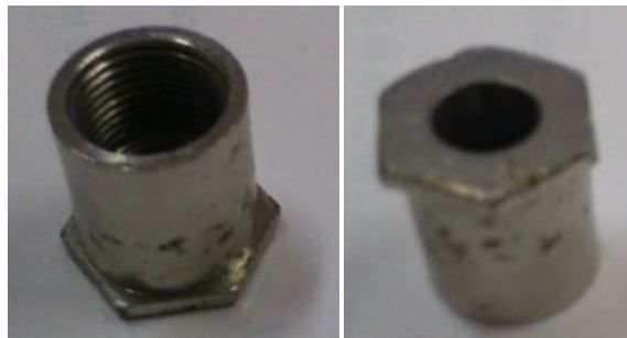

Looking for a stereo 100k pot with 1/2"+ of thread. I'm planning on mounting this on a 1/2" thick walnut chassis and I don't want to fuss with a big countersunk hole on the backside. Digikey and Mouser searches aren't turning anything up.

Long threaded pipe nut(?) can be used.
Gajanan Phadte
Edit:it is a threaded pipe nut (one piece) with internal thread.
Gajanan Phadte
Why not mount a piece of ally (or any other material for that matter) behind the wooden panel and affix the pot to that. The shaft of most pots will be long enough to protrude through the wooden panel so that you can affix a knob.
