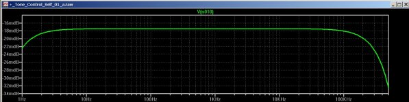

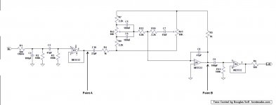

Below is a shameless rip of a tone control circuit by the same Mr. Self, or actually his circuit is between points A and B, the rest is me fooling around with inputs and outputs. This circuit doesn't really meet your requirements, but I happen to have the images lying around and I thought they might be of interest in a general kind of way.
The first image is the circuit, of course, and the second is the LTspice frequency response plot at Point A.
The third image is the plot at Point B, both bass and treble controls being turned from minimum to maximum. Both being turned at the same time, which is why there are multiple plots. In real-time there would be a single plot for the bass response, and a single plot for the treble response.
All of which might be of interest because this is pretty much similar to the plots of all the tone control circuits I've looked at, which is several. I don't know how accurate LTspice is when plotting these (I expect very accurate), but they all come out pretty similar, which makes me suspect that regardless of what a manufacturer or designer claims this is what you're going to get.
