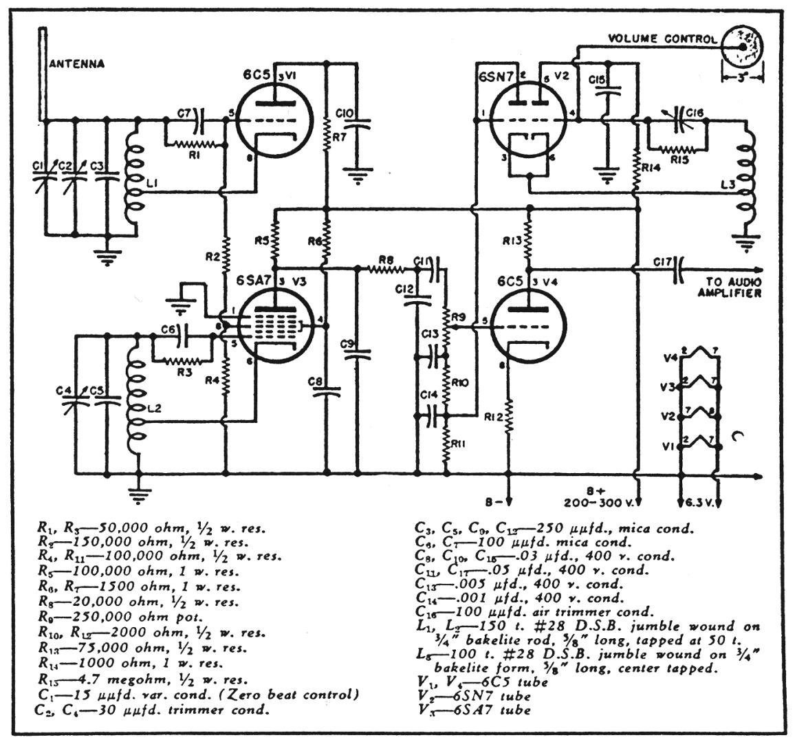

I would kill for that schematic!!! Please please please!

This one from October 1949 of "Radio & Television News" uses the pentagrid valve (tube) as both one oscillator and the mixer.
