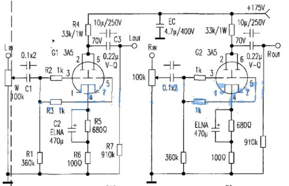

Aliexpress claims they have a SRPP curcuit with 3A5.
So is it possible?

No, this is not SRPP, I have worked on this board, schematic is here. Some things to note:
The circuit is 3a5 with both triodes paralleled.
The PCB has no heater input - you must wire to pins 1/4/7 and you can run it with heaters in parallel or series 1.4/2.8V operation
You need a dedicated filament supply. Some batteries will be fine to try it out. A regular regulated/adjustable supply will give you hum but you can at least hear it working.
I am using it as the IV converter after a DAC, and ended up using Rod Coleman filament boards, and Ale Moglia gyrators for the plate load in a filament bias set, exactly as per Bartola valves. It sounds wonderful in this arrangement. I mean seriously good, the realism and soundstage is just fantastic. Beware these valves are microphonic, so you will need to sit the board on some foam or something.

And on the schema:
How did you connect the Coleman regulator?
Did you use the pin 4 to the 680 ohm resistor or?
In reverse order:
The Coleman regulator connection: join pins 1 and 7 together on the valve socket. Remove all the cathode components from the schematic above - C2, R5, R6. Fit 10R resistor between the junction of pin 1/7 and ground. Then positive of Coleman supply goes to pin 4, negative of his supply goes to ground (bottom of the 10R resistor). Then you need to adjust current on the Coleman to get 1.4V across pin 1/7 to pin 4. If you are using the bartola schematic, you will end up with about 3.6v or so at pin 4, 2.2V or so at pin 1/7 above ground.

A transformer that puts out 9-12V should be fine (if you are using the schematic with gyrator etc from Bartola). My recommendation would be to use different transformers for the filament regs and the B+. The current is not high for either, so some nice r-core transformers would fit the bill nicely.
Also, if you are building your own raw DC supply (ie not using Rods raw DC kit) then don't use a 317 type regulator - I had buzz when I used one. Just a simple rectifier - 10,000uF cap-10r-10,000uf cap will do nicely. I used a common mode choke on another build and it worked nicely too, but I don't know if it actually made it any quieter. Rod recommends 10,000uF but I know I have used 6800uF and they seem fine.
