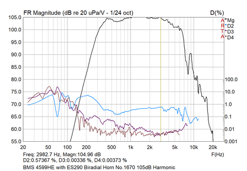

Just had a look into the 1" drivers measured for my cinema project - I get about 2% THD at 110dBSpl. But that's mainly 2nd harmonic, 3rd harmonic is down at -60dB. (BMS and B&C ring radiator drivers).
But even the Bliesma T34A has about 1-2% at 105dBSpl - so this is a pretty hard task. Maybe a big AMT can do it (with other downfalls of course).

The answer is no. But the BMS 4599HE comes close at -45dB (0.57%) at 105dB.I would add to that, reasonably constant directivity above 1kHz, with 90-ish deg beamwidth in the horizontal plane. HD products restricted to the audible range.

But I have experience with BMS 2"/1" coax driver neodym version - cause I built my main PA speakers with them. When you crank them you get plenty of 2nd harmonics. They never sound harsch or resonant as most 2" drivers but they add some "sweetness", hide finest details. This is no problem with recorded music - but it takes away a little the direct "connection" between musicians, mixer and output. Mids & highs are more polished as real life. Some colleagues don't like that driver for that purpose - I still prefere it over all the other 2" drivers of that time (that's a few years in the past ;-)) cause of the detailed high frequencies (I mixed a lot of percussion ensembles - great for that).
