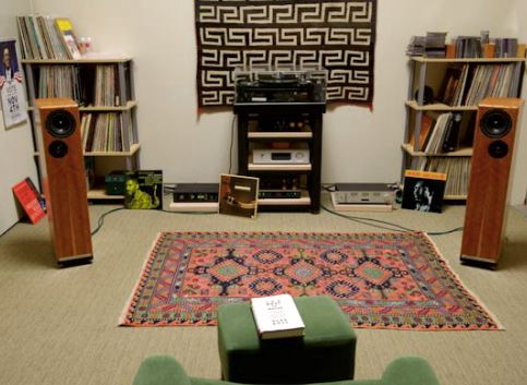

Hello,
I am designing a two-way speaker (7" woofer and the Dayton Audio AMT Mini-8 tweeter). I will likely use a first order x-over (6 DB).
Typically in this type of design, if one considers the woofer as a clock, the tweeter would be above the woofer at the 12:00 position.
Are there fundamental reasons for this?
The reason I ask is that I'd like to position the tweeter at the 4:00 or 8:00 position.
Any feedback would be much appreciated.
Thanks!
Mack

It depends on speaker/stand height. People put it above to get tweeter closer to ear level. If you have an unusually high placement of the cabinet it makes sense to keep it lower below woofer. Offset at 4 or 8 o'clock provides the asymmetry to reduce baffle diffraction effects be preventing any two distances from tweeter to baffle edge being identical, thereby preventing deep cancellation interference by baffle edge. The polar response will be asymmetric though.
If you have a well behaved wide band woofer with no nasty breakup peaks, and a wide band tweeter (like a full range driver) a 1st order xo, if done well, with time alignment, it can be used to achieve a phase coherent, transient perfect xo that sounds eerily good for natural soundstage and imaging with realistic percussion like a live performance. In practice, it is much more difficult than a second or fourth order xo to do right. Some very good expensive high end speakers use first order exactly for these reasons. The AMT is not wide band enough.

1200 o'clock will project the +3dB lobe down towards the floor.
0600 o'clock will project the +3dB lobe up towards the ceiling.
This is what you get with a true acoustic single pole crossover.
If you want to avoid pointing the phasing lobe above or below, you need to time align the drivers for the forward beaming. But this still leaves the phasing lobe in the forward direction. Anywhere off true forward will sound different, including reflections.
LR removes the lobing effect. Read Linkwitz.
Either LR2 using cascaded single pole passive filters, or LR4 using at least some active filtering. Passive LR4 requires too much absolute accuracy in component and speaker values.
4/8 o'clock does not remove the lobing, it just rotates (~60degreees) it into a different plane.
The pic in post4 shows ~0515 o'clock. The reduced rotation of the lobing plane may be less noticeable and the gain in different diffraction distances to all the cabinet edges may help in hiding specific colouration peaks in the signal.
Before I knew about diffraction effects, I did a 1245 o'clock to distribute the distances. I did not compare to 1200 o'clock so can never know if it was a success. I copied the idea from the HiFi mag reviewers of the time.
+1 what AndrewT posted.
Moving slightly away from the 12 or 6 positions will probably improve the smoothness of the tweeter frequency response due to baffle edge diffraction.
This is because in the 6 and 12 position the distance from the tweeter to each side is the same, so the diffraction effects from each side will pile on top of each other. If you move to say 5, 7, 11 or 1 o'clock, now the distance to each side of the baffle is different so edge diffraction effects will partially cancel and the +3dB lobe is still in an almost vertical plane.

Rounding off will attenuate the re-flections. I doubt that rounding removes them entirely.
Offsetting will spread the re-flections over a wider range of frequencies, especially if the three nearest edge distances are all different. eg, 50mm from the top, 70 mm from one side edge and 110mm from the other side edge (=180mm wide).
I see that as meaning that using both techniques add to give better response and are not exclusive to each other.
Offsetting the tweeter mitigates the issue by smoothing the response errors, but only over a small radiation angle (at others it may be worse). Rounding will fix the issue once the round over is sufficient to reduce the diffraction below the threshhold of audibility.
Yes, but separate from the edge diffraction issues there is lobing from the fact that you have the sound moving from one driver to the other with frequency, with different dimensions, so you get changes in the directivity (and sensitivity). You want to keep those changes horizontally aligned.
