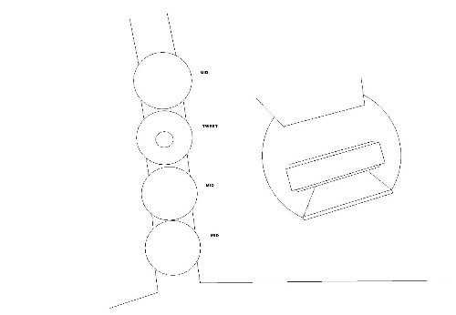

Perhaps you could gang together multiples of these three inchers for the mids......you could string several going up the pillar.
The low impedence capacity of most all car amps would easily drive multiples.
Without using these a "Pod" at the pillar would be ugly at any size bigger than a 3". You would then need to rethink WHERE am I going to use a bigger driver.

I'm not going to use a regular car amp. I'm going to use two channels of the 41Hz amp9basic kit which is a 4 channel class T module with around 50wrms/ch at 4ohms.
more mids won't be an option as I was hoping for a smaller pod but looks like I'm stuck with the 4" mid.
I was thinking of going 3 way since the imaging is a mess in my system. taking the midrange off the doors and taking them up to the windshield could eliminate the boxiness caused by the center console in the footwell. image gets stuck between my legs.
I've tried everything from messing with the crossover freq's and slopes, time delays and tweeter mounting.
