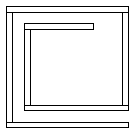

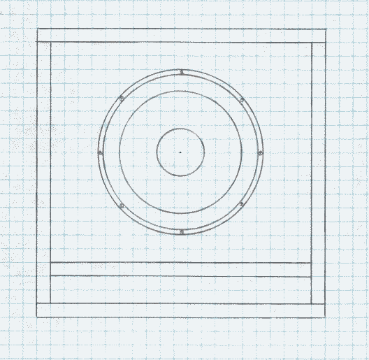

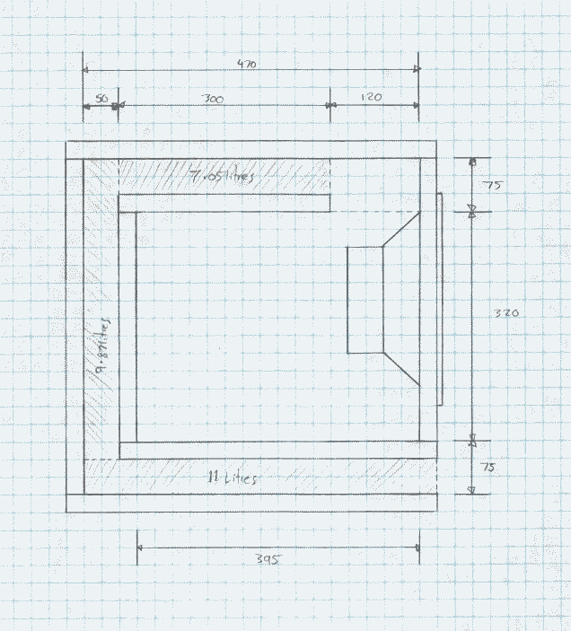

Okay... I have designed a 60litre for for a Peerless 12inch XLS sub (830500) The total internal volume is 100litres, due to the volume taken up by the port....
Below is a picture..
I have a few questions, is it okay to have a 90 degree angle in the port??
BTW. It took me about an hour to work out how to do this... the final total internal volume is 63litres... then you have to account for the speaker.. 🙂 the box is tuned to about 29 - 31 Hz.... the final thing will be a 52cm X 52cm X 52cm cube with a slot port the full width of the internal dimension, which btw is 47 cm as I designed the box to use 25mm MDF walls... is there any problem with the design? I thought it was pretty good.. 🙂 got the volume spot on, and I believe I got the tuning right....
THE OTHER QUESTION!!
How do I measure the length of the port? I personally worked it out by the volume... I knew it had a constant cross section of 47cm X 5cm so I worked out the same volume for straight as bent.. 🙂 ALSO!! is the gap between the internal end of the port and the speaker baffel big enough? is it a bad idea to have the port sortof facing the rear of the woofer???
THANX! 🙂

Umm... no one? lol yeah yeah.. lol I should wait.. lol just someone post to say they have read this..🙄 lol
personaly i hesitate using a driver that wants such a tiny box with mid tuning and a LONG port.It wastes the 18hz Fs and low efficiency which accompanies the low resonance.
adrian mack <www.geocities.com/adrian_mack >
mentioned this to me,about his PR'd XLS12,how its nearly impossible to build it with a port to optimum specs.
i attempted a ported design,but i always ended up compromising it.
if your using winisd,you could save the project,and add as attachment so i can look over it to ensure im using same inputs.
i expect Group delay to be abit high...
personaly id go for the lower quality shiva in a more comfortable sized box tuned to 22hz without 4metre long ports

thats fineWINISD calculated the air velocity through the port to be 13m/s tops at 400watts
yesI have a few questions, is it okay to have a 90 degree angle in the port??
also i think for shelf ports you minus 0.5x port height from the total length because it has different loading to usual.
if im wrong,my jbl2226h is still tuned exactly right with a shelf port anyway😛

also,your group delay is alittle high. 27ms.
i would think about using a smaller sized port for only 75cm length approximately.<trade off port speed,but makes it more managable>
it will never be the best, why not save for a PR and tune 19hz?

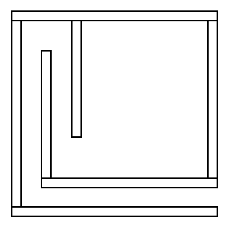

Use Smaller port
try using a smaler port as sugested and build it with flared ends. If you need a way to do it I'll explain it later. I have to go now.

Using:
Fs=28
Qts=.3
Qes=.32
Vas=81L
Re=1.8
Dia=24.75 (guess)
Xmax=12.5
Ql=15, Qa=30, Qp=30
I modeled in my spreadsheet a 60Liter box tuned to 30Hz.
I got:
F3=32
Power handling 28Volts RMS+ (450watts+ into 1.8 ohms) at 26Hz+.
Excursion at 40Volts Peak (28VRMS) was 11mm at ~41Hz (this is the max above resonance). Excursion follows voltage so at 20V peak it would be 5.5mm.
Vent velocity was 14m/s peak at ~27Hz. with 40Volts peak input, assuming a 47X5cm vent.
Group delay was ~45ms at ~29Hz. This confirms insidious errors still exist in winISD - unless a different box/tuning were used by "mikeported" 😉
Group delay is not important anyway, so I wouldn't worry about it. The resonant decay in your room is probably on the order of seconds, not milliseconds. The room decay is usually overwhelmingly worse than box group delay. The audibility is still a contentious issue among those who think they know what the term means.
Your mileage may vary.
Please note: Peak=RMS*1.414

Whoa!
I screwed up and used the wrong driver - Peerless has another 12" XLS autosound sub with different specs...
Using: (830500)
Fs 18.1
Qts 0.2
Qes 0.21
Vas 139
Re 3.5
Dia 24.75
Xmax 12.5
Pe_max 300
and Vb=60L, Fb=30
I got: F3=29
Power handling more than 300W over 26Hz
Excursion max above resonance 7.3mm at 39Hz with 40V peak input.
Vent velocity 10m/s at 29Hz with 40V pk input.
BTW, Group delay shows 85msec here. for this design, with these specs.
Depending on the goals, I might try this design just to try a folded port - or I might try to tune lower to get rid of the peak in response by either sacrificing port area and living with the possible noise or going with a PR, as others have suggested.
The peerless 12" PR (830548) would be perfect in a ~45-60L box with no added mass. Group delay would be in the 100msec range with the PR...
Have fun - hope I got the driver specs right this time 😉

i really am not sure about such long ports. taking up half the box volume, with high GD ,and in the end it only does 30hz....
