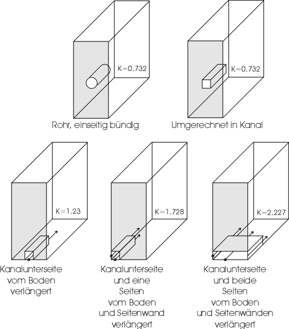

Hi, in addtion of what was said, even the position of the port will influence the tuning frequency.
I've had a problem with end correction factor and I got help from members here who posted the following picture and site.
WinISD considers k=0.732. You have to adjust it manually if you position your port close to one or more enclosure walls.
http://www.calculatoredge.com/new/ventlength.htm

I can work out the volume of the ports pretty accurately - my question is: if I replicate the volume and depth exactly but change the 2 x round holes into 1 rectangular hole - will the frequency still be 35Hz?
The Fb should still be pretty close to 35Hz, but the high aspect ratio port's pipe resonance(s) may increase in amplitude and be a different frequency than the circular ports:
You can easily adjust Fb up by shortening, or down by lengthening the port a bit, but you can't easily change the pipe resonance of a wide, narrow port.
