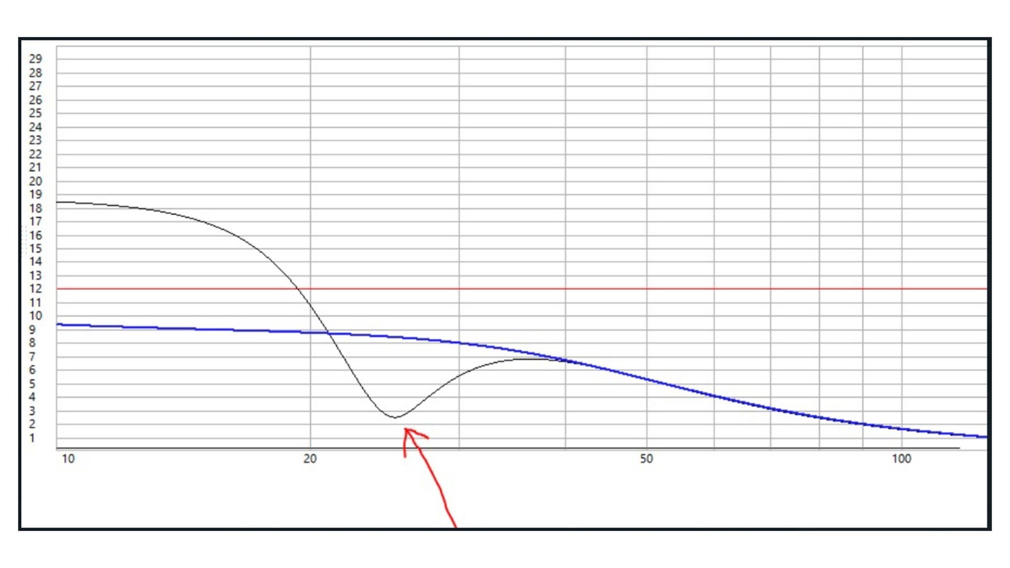

Hi all please see the attached cone excursion image.
In this ported sub, the driver excursion is minimum at 25Hz and then the port generates the bass.
What happens if you apply EQ and boost the 25Hz by 6 to 10dB?
How friendly are the Ported subs for EQ boost?

If you boost atr the box tuning frequency, you will still get an increase in excursion, but as it will have been low anyway, it may well stay within Xmax, so not necessarily a problem.
However, it will increase the power demanded from your amp (particularly as electrical impedance is low at tuning frequency, so it really will ask for good current delivery) and it will increase vent airspeed a lot too.

Asking more power, or higher vent air velocity is pretty obvious.
As long as there is no negative impact on the overall driver+port system it's fine.

you basically use a high pass filter with a q = 2 at the tuning frequency.
I like to use low qts drivers, then tune to the Fs if qts = .312 (or box's f9 if you tuned to Fs) then use the filter above.
It boosts output by 6db at tuning (now -3db there) and doesn't bottom out because the filter acts like a subsonic filter, and the driver isn't moving much at tuning frequency already.
If anything, the sub now " gets up and goes" because it isn't trying to reproduce the really low stuff.

To stress this some more: At port tuning frequency, the cone excursion is little, while the impedance is at its lowest. Meaning that you are pushing most power where the coil does not move as much, lacking cooling effect. Then some DJ wants to feed your intestines with solid bass line right at the port tuning frequency of your box for few minutes, and you can rest assured there will be some cooking sooner or later, and then silence. If you are lucky, the amplifier might shut down sooner. Many just don't...
Regarding BT speakers radiators, this is true, but very general. Firstly, small cones move quite a bit more (in proportion), secondly, it is not such problem to dissipate 4W against 40W, compared to big subs with 400W/4000W ratio.
