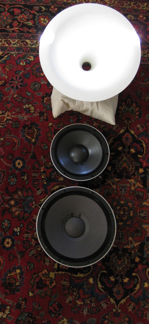

I pulled my driver out of the boxes... this is the basic config i was thinking except adding a small ribbon or horn for the highest range just below the 330 hz horn.
any advise on alignment? can the 12 be pretty close to the 15 if i am crossing at 150hz?
was going to split at 150hz 600 then around 9k to the tweeter

ARK:
Hey, we have the same carpet! Crazy!
Just out of curiousity, why cross over the TAD so high to the tweeter? Which tweeter? Will that TAD 1102 even get anywhere near 9k?
Mine is set up to cross the TAD 1201 to a JBL 2344A "Butt cheek" midrange at about 1000, and then to a JBL 2404 "Baby butt" at about 5-6k. I have all those drivers already. My TAD 1201 is holding up the whole thing, because the boxes are just too big as a 4 way. I'm thinking about an AE 15" dipole woofer (or a pair) on each side, or an AE 15" TD-M series to play up higher, and just eliminate the TAD 1201 from that speaker. John at AE suggested that idea. It isn't a box volumn thing, it is a height thing. The TAD only needs a 1 cf box.
That's why I'm trying to figure out what to do with the 1201's. A long time ago, Magnetar stated that the 1201 open baffle would only get down to about 600, which would be a big waste. I think a really nice monitor, to be coupled with a sub might be great for the 1201's. I'd like to hear any ideas. I hate to sell them...they are just so beautiful!

persian carpets are way under-appreciated these days, thing this one is 80yrs old i just can't hurt it. I mentioned the tad 1102 before by mistake.
What I have here a tm-1201. So my crossover points will be:
< 150 hz = tad 1603
150-600 hz = tad tm1201h
600-9k = JA6681
<9k (or 6k) = tbd (JBL 2404's like yours would be a great option)
Yeah.. the 1201 is beautiful but I'm having the same issue its so big, needs a tiny enclosure really wants to cover a narrow range. When i bought it I intended to use it for a humungous upper bass horn - now space prohibits.
all but the 1603's are 16ohms and over 100db efficient... this project is begging for two more 1603s in push-pull huh? they would be hitting the ceiling of my small room.. ugh. problems problems ha ha
