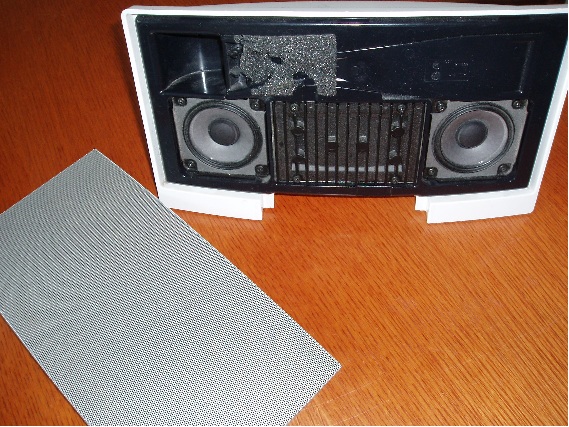

Instead, I systematically removed the peripheral circuits: the iPod docking bit, including what appeared to be a DAC, and some other stuff.
Next, I opened up the main compartment - where the speakers are housed - and disconnected the internal amplifier, chocky-blocked the internal speakers to some wires running through the "waveguide" (seems like a long BR port of varying cross-sectional area), and hooked it up to an amplifier.
, I thought. The bass sounded like it went all the way down, the actual detail through the midrange and treble was far superior to what was expected from a device of such diminutive stature. Of course, such systems retail for a rather pretty sum of money, so half-decent drivers were expected. Also went rather loud, without cone excursion becoming a problem.
There's definitely a peak before the bass rolloff, with nothing at all below 60Hz, so I shall add a high pass there later on.

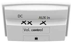

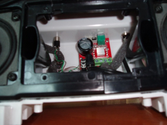

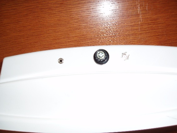

Proof of concept complete, I mounted the class D board along with some connectors to the back of the dock (see attached - actual picture later) for more permanent use. The front grille is now re-attached, as it had previously been power and signal cable running through the waveguide.
Cost so far: £15, including connectors.

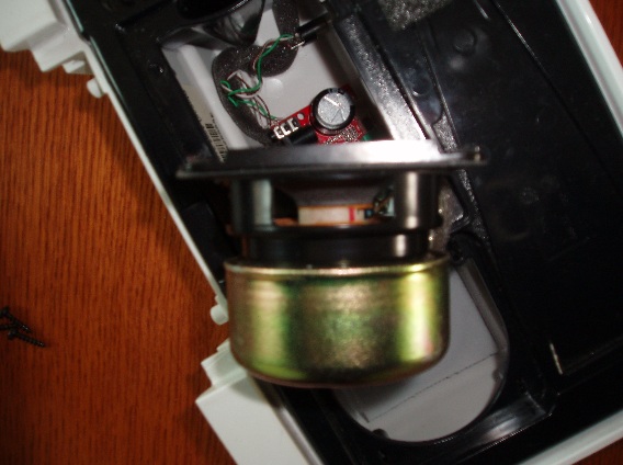

As promised, here's some pictures.
Chris
