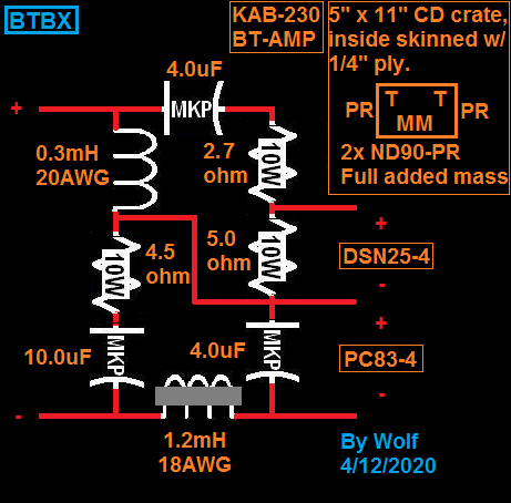

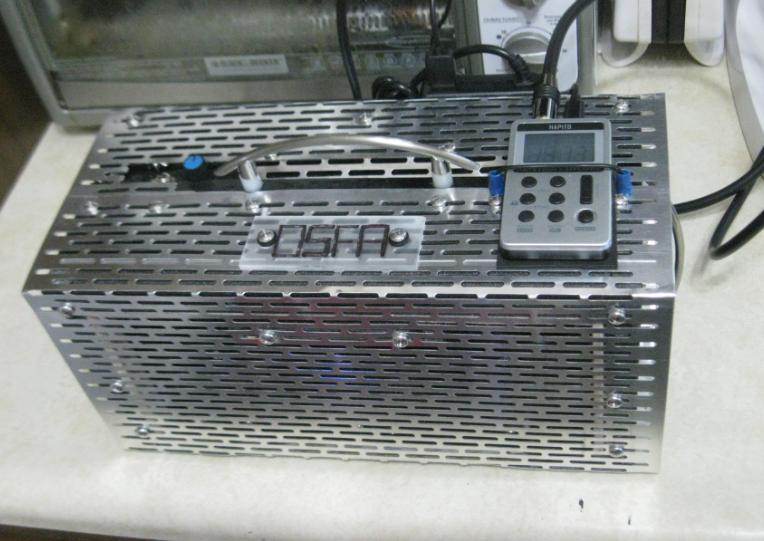

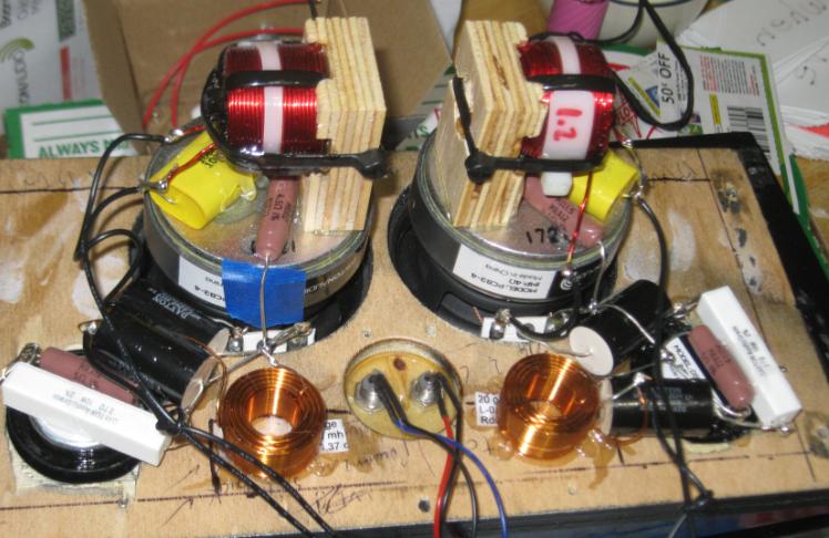

If you'd like some ideas, I built one myself into a wooden crate meant for CD storage from a local supplier, and it has wowed a good many people both in my family and not.
OSFA:
Theorized and built: "OSFA", one size fits all bluetooth speaker... -
Techtalk Speaker Building, Audio, Video Discussion Forum
Photo below,

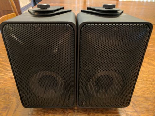

The project consisted of a pair of Radio-shack minimus sevens with the factory brackets, the "component" Pioneer head & amp, the head, I don't recall, the amp was the GM120, old school design, way before digital.
Since the cassette/AM,FM head was approximately the same height, faced up, as the Minimus sevens were tall...I found a sealed lead acid (SLA) battery appx. the dimensions of the head..
Built a thin 1/2 inch! plywood box, battery on the left, head on the right...screwed the Minimus sevens to the ends, the top-o-line amp on the back.
Handles, corner protection plates, terminals to recharge the battery, little hooks to wind up the slack wire as I could unscrew one of the Minimus speakers & get all the separation I wanted...
It was heavy with that SLA battery, but would last 2-3 days or so...it was kinda hard to balance it on my motorcycle at the time...my only transportation.

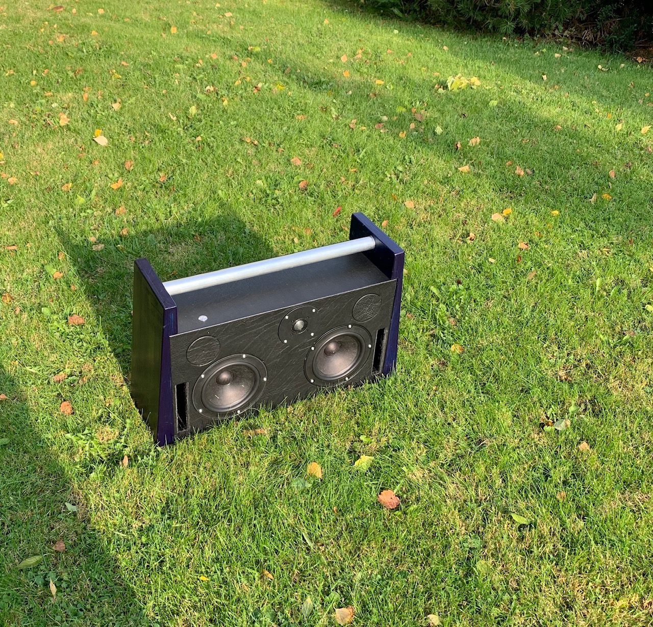

it's alive😎
key components:
-peerless ne180w-04 woofers in 24L box tuned at 40hz
-seas h1212 tweeter
-diy tpa3251 amplifiers with class-H boost converters and pcm5102 dacs
-adau1701 dsp
-diy bluetooth receiver based on a microchip BM64 module
Even though this was a collaborative project with my brother, building it took so much time that our juices just ran out with the battery solution. For now this runs fine on a very beefy laptop power brick. Sounds good for the purpose, dispersion is pretty wide and and these woofers have a nice kick to to them.
