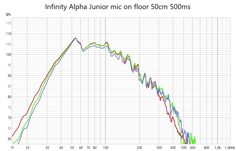

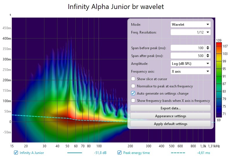

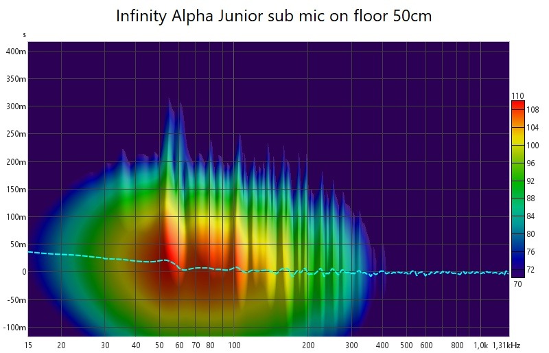

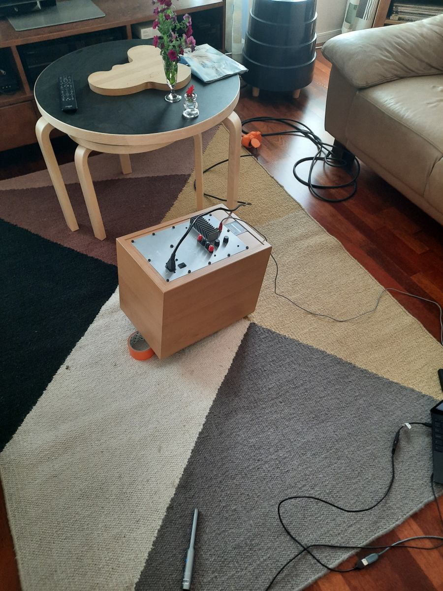

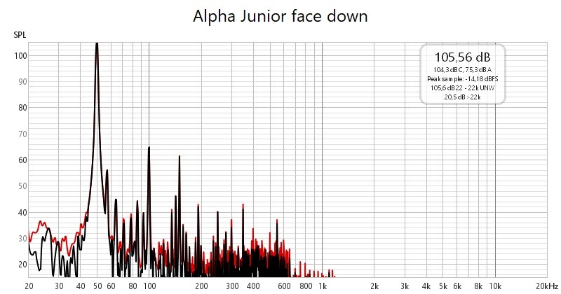

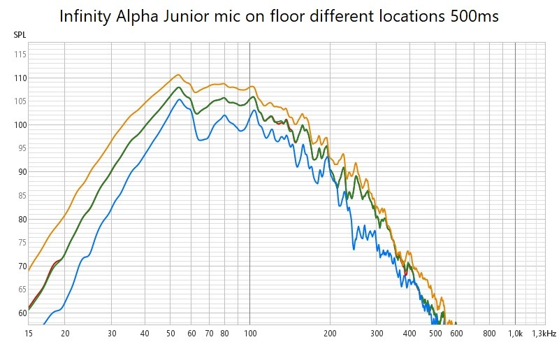

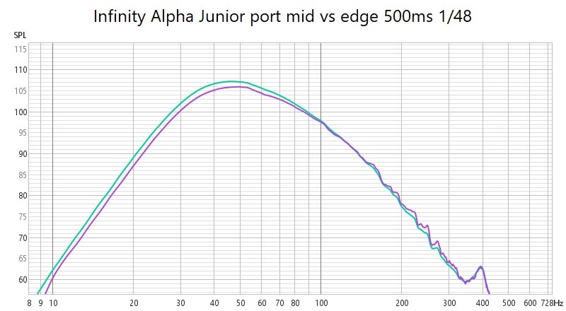

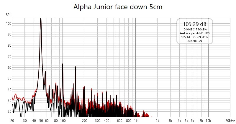

So, I got my loaned little "sub" back for testing...
Infinity Alpha Junior from early years of this millenium. Port tuning 50Hz, 8" driver and the flared port are both on frontside. Speaker was on a thick carpet indoors, middle of the room. 500ms gating shows also room modes but represents well what we humans hear.
Indeed - there are measurable differencies when driver and port are downfiring vs.front. Port down has less problems. As well mic in the middle or edge of the port gives differencies.
But differencies in my measurements are totally insignificant. Mic location changing a few centimeters gives more differencies. Wavelet spectrogram shows room modes.
Go ahead and prove me wrong, please!
Ääh, the most significant picture missed notes
ps. In previous post's pics, spl of whole speaker and port only are not comparable. Port measurement signal was 20dB lower but mic closer to source

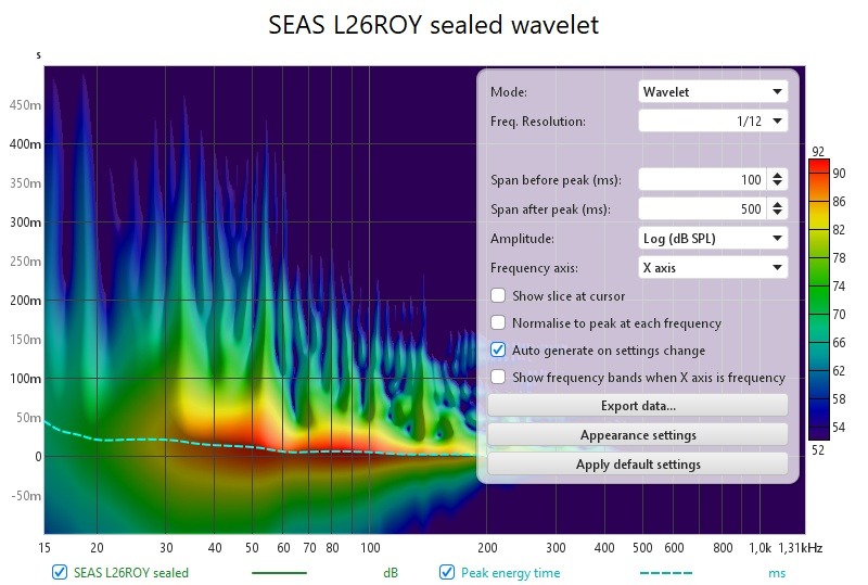

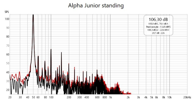

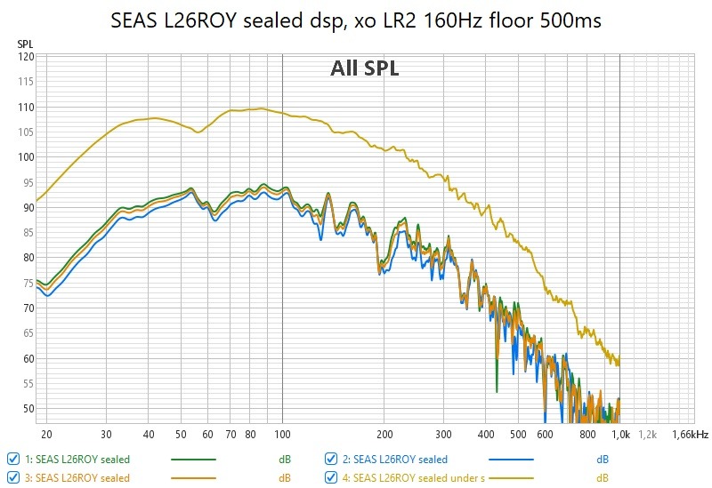

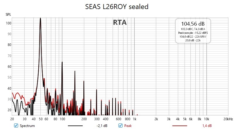

Out of academic curiosity I measured also my sealed downfire subwoofers of AINOgradients is same way.
From sweeps we can see the room mode peak at 50Hz, but also the eq I have set on dsp - neg. peak at 50Hz, low end boost (pos. peak at 30Hz) and acoustic LR2 xo.
Sine sweep at 50Hz and 105dB is much cleaner of noise but harmonic distortions are pretty similar
Edit time over... distortion signal is of course steady 50Hz sine wave from REW's generator, not a sweep!
Wavelet spectrograms of br vs. sealed subwoofers, measured same way in same room. BR was standing ie. driver and port towards the mic. Sealed is downfire. So there is a small difference in how they excite room modes. Placement for listening is different.
