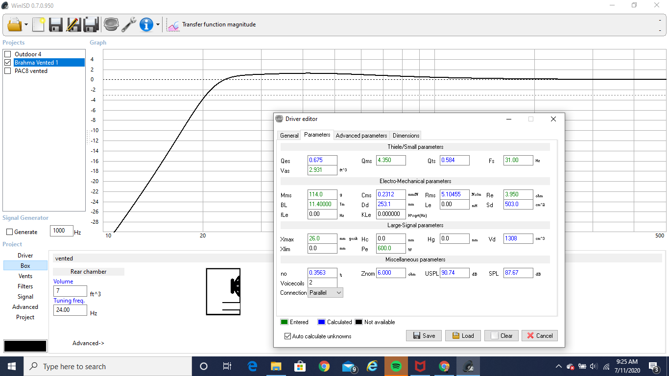

I have a 12" driver and building a ported box of approximately 4.3 cubic feet and tuning to 22Hz. This could be fed as much as 600 watts of clean power from a Crown pro amp XLS 1502. Using WINISD to model. In that program I am concerned about port velocity numbers it is throwing out. Some say don't go beyond 17m/s while others say up to 30 or so will be just fine. I have modeled using two 3" ports and a single 4" port. Not too much difference between the two, so given the choice I would use a single 4". But with either of those choices the port velocity is as follows.
At 300 watts of signal the port velocities for two 3" or a single 4"
at 20Hz 35-40m/s
at 30Hz 16-18m/s
Having two 4" ports solves the problem, but I am thinking two 4" ports might be overkill. Seems like a lot for a single 12" driver, although the Xmax on the driver is 26mm so pretty substantial. I just don't want chuffing during a low rumble in a movie. I will flare the ends of the ports using a 3/4 roundover router bit.
Will a single 4" be fine?
Thoughts?
at 20Hz 35-40m/s
at 30Hz 16-18m/s
Thoughts?

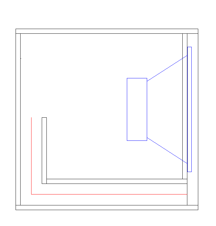

1- I need to use an elbow in the ports. Need ports front facing and box is only 12" deep. Using regular schedule 40 PVC tube and elbows. Any advice about how to calculate length incorporating a typical PVC elbow?

The length of the port should be calculated by the middle line.
How might one do that? Is there an online calculator or website that describes the method? I Googled it real quick and didn't find anything

Also - does anybody know if WINISD takes into account the ports in the box volume? I am assuming it does not. For instance if you put 4.2 cubic feet into WINISD as the box size, it is assuming that is the net volume after any ports and drivers have been accounted for.
Re: Port Centre Line, the attached image should show you what you want to be doing I hope.
Re: WinISD and box volume, the Volume used in WinISD (and every other box modeller I know of) is the net volume of air that is free to resonate in the box ie, after accounting for the port, backside of the driver, bracing & any other inclusions in the box.
