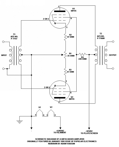

Back in 1995 Popular Electronic published an article on building a 60FX5 push pull amplifier. Has anyone built it? If so how does it sound?
IMHO, single-ended 60FX5 is a very sweet Watt. I don't see that cancelling its curvature with push-pull is worth the small complexity (and not-cheap grid transformer).
The issue is on-line:
POPULAR ELECTRONICS: Consumer Electronics and Experimenter magazine
http://www.americanradiohistory.com/Archive-Poptronics/90s/95/PE-1995-01.pdf (12MB PDF)
I may have found the source page for the re-draw:
Build Your Own AdamAmp II!
