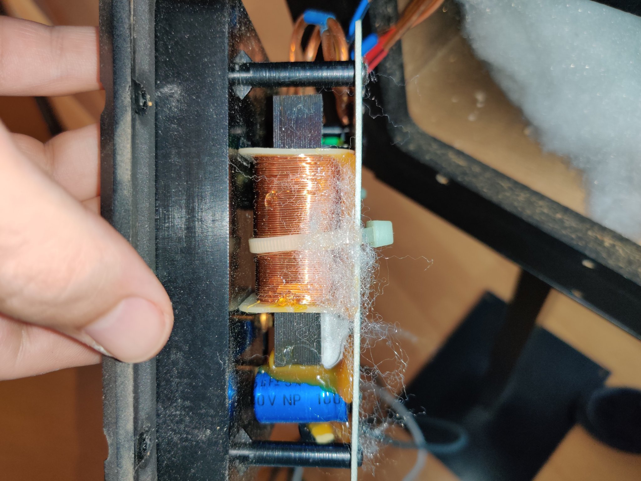

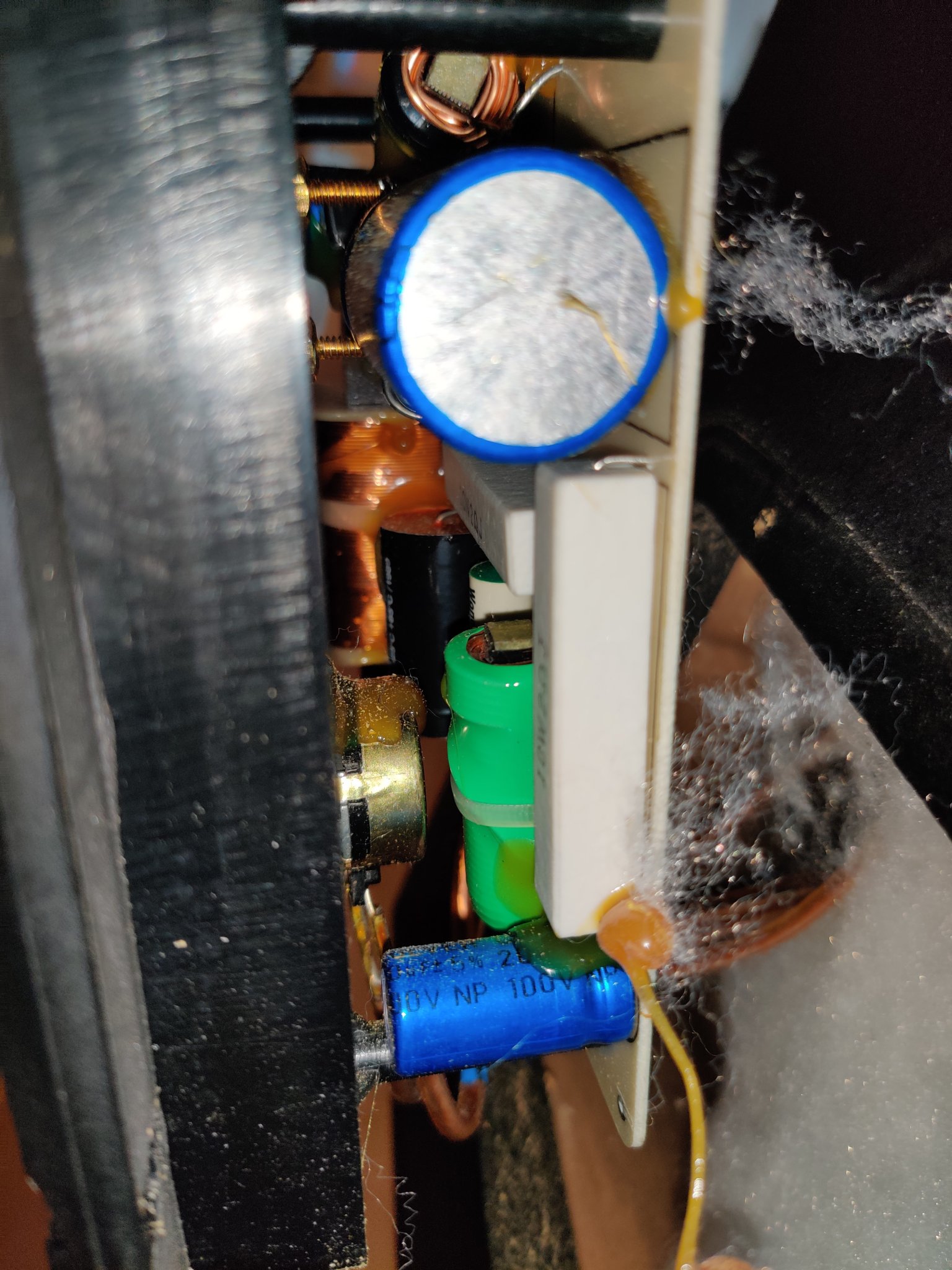

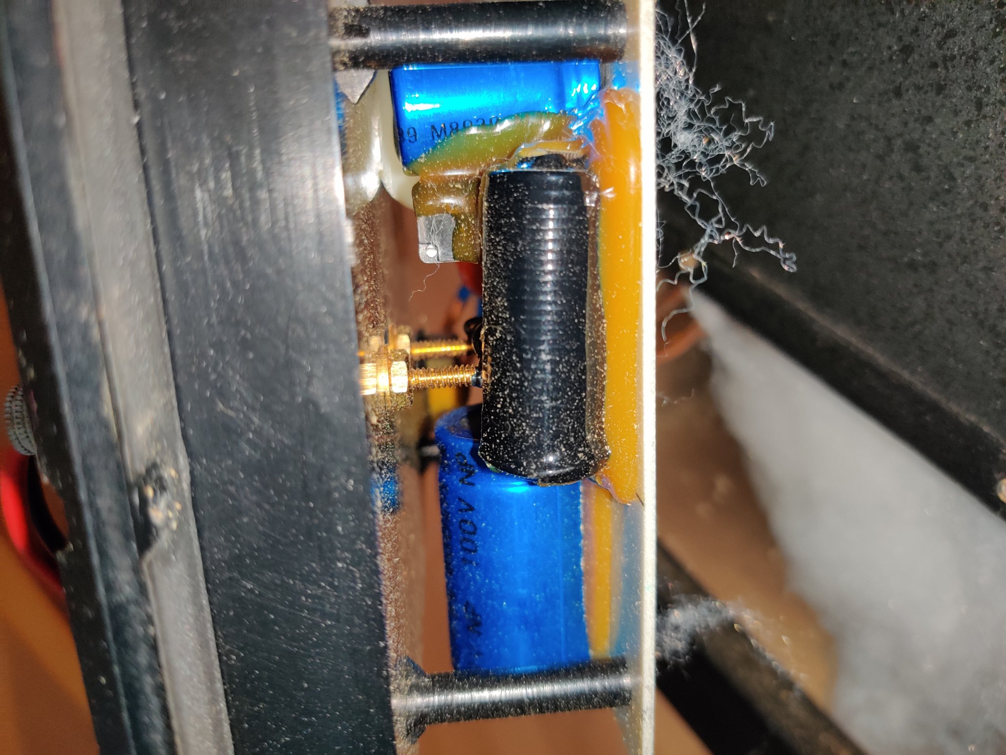

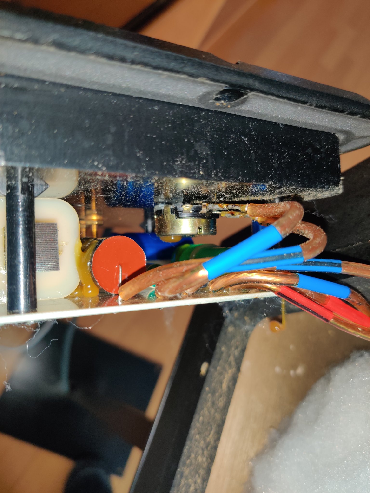

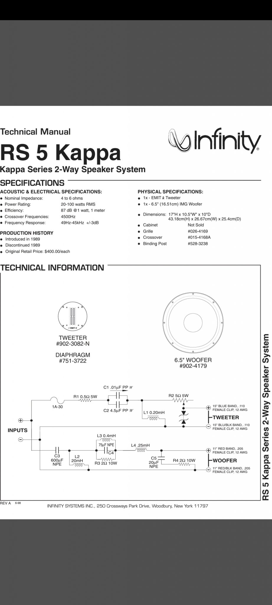

Well, I opened them up. The crossover looks fine and measures fine. It's quite a complex one for a 2way system. It has a high pass for the woofer, a potentiometer for the Tweeter level and even a tvs diode.
The caps look new so they where indeed replaced by the service company, I don't recognize the brand though and they are electrolytic but I mean film caps would surpass the cost of the speaker itself.
I will attach a couple of pictures in case someone is interested,though I didn't disassemble it further because I could measure the caps.
The speakers have been refoamed after the original surround had been completely destroyed, so expect if the service company did a big mistake that shouldn't be a problem. At least that's what I can see.

Could it be the tvs diodes?
