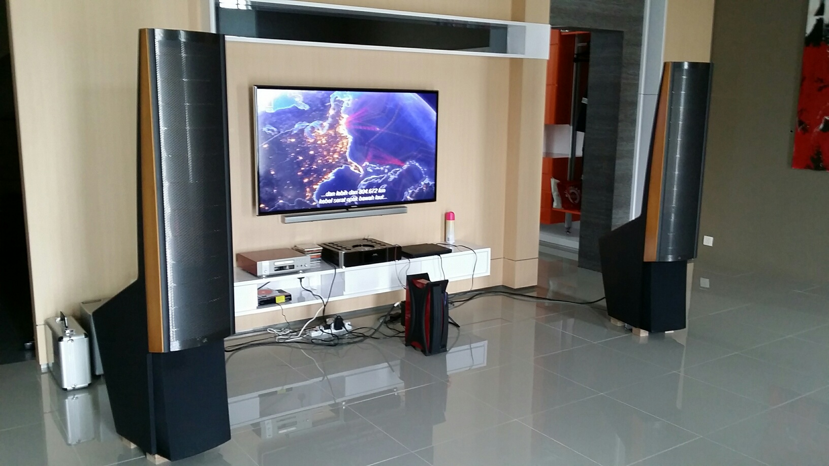

Hi Bear,
It's my new home. Have only just testing the set up. Acoustic treatment will be added
