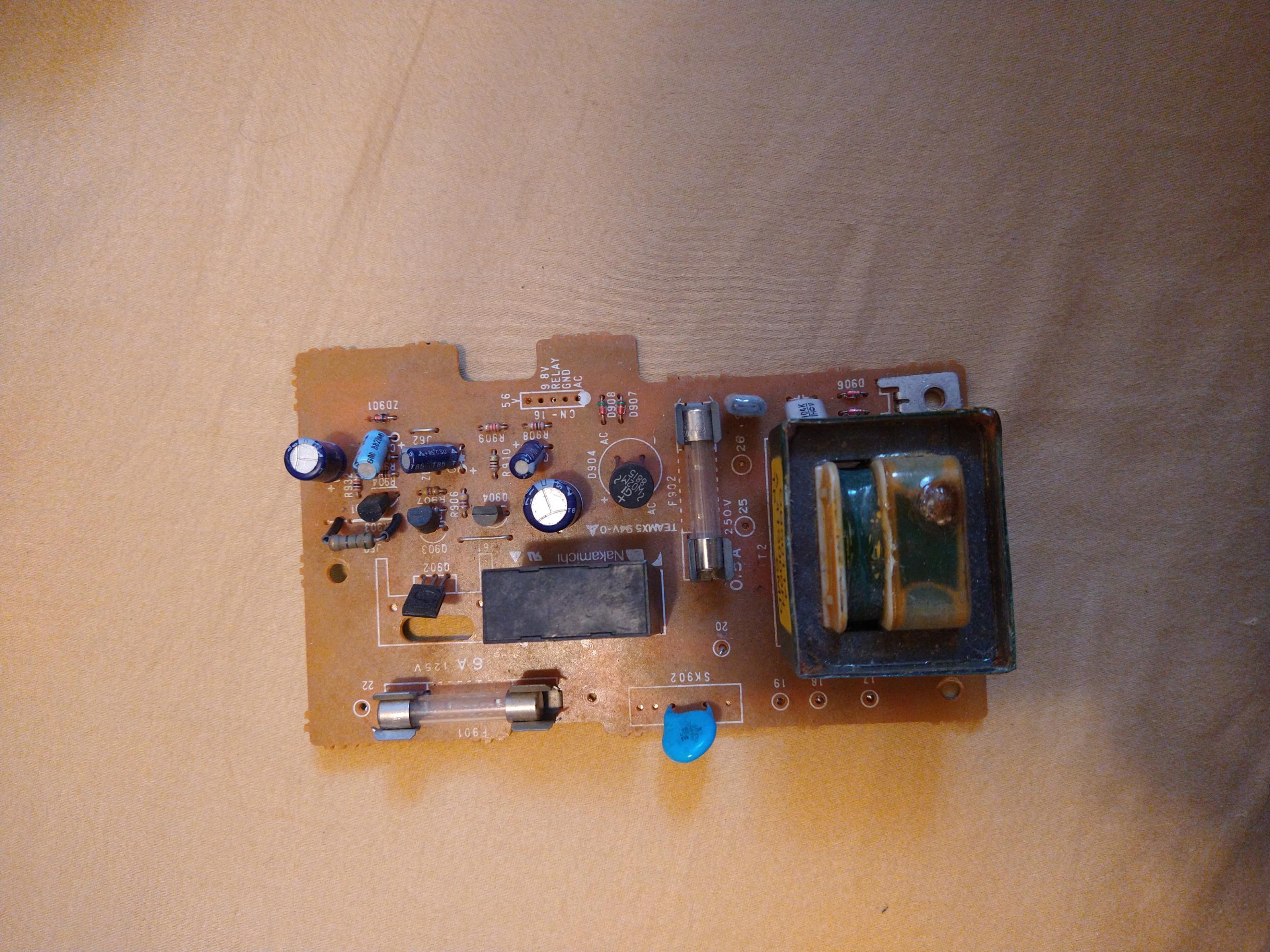

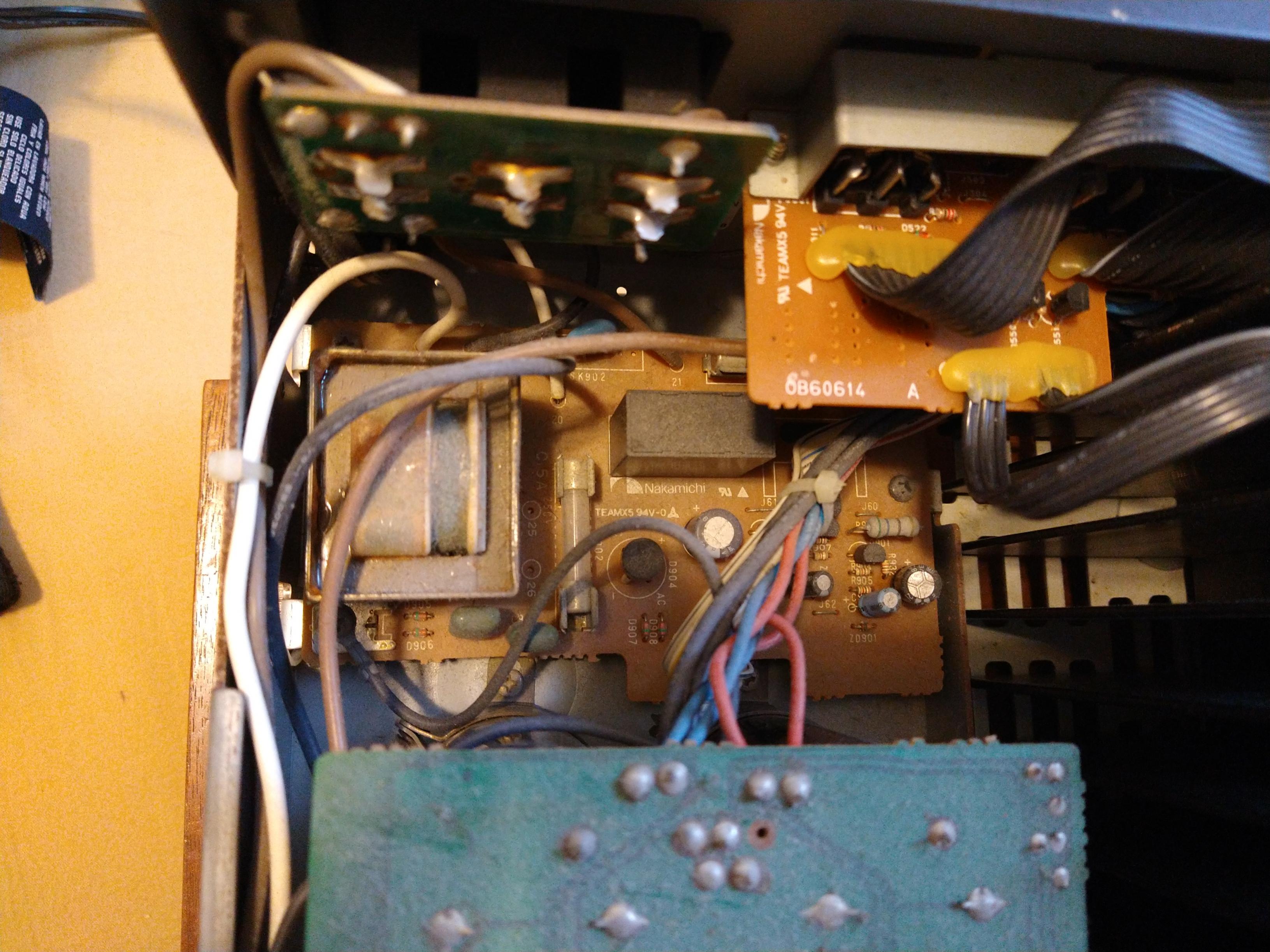

So I also have ta-3a that started to have this issues. Occasionally turned off completely. Not protection mode . All lights turn off.
And another ta-4a that used to work fine has the same issue mentioned above
Attached are images of the board.. the key to issues is here
Not a lot of components. I don't have capacitor testers.
Is there another common component that goes bad. Is this a rectifier diode there? Black cylindrical semiconductor

not much to think
re-cap
test continuity of xformer windings
you can test diode bridge (that black thingy ) with diode test of your DMM , without desoldering
you can also test relay winding
if it clicks, and it doesn't power up receiver, relay contacts are shot
