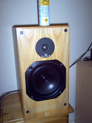

When you transistion from an 8" bass to a 1" dome tweeter, as in the Audio Note AN-E, whatever it's other strengths might be, you hear the dispersion transistion from a narrowing dispersion 8" bass to a widely dispersing 1" tweeter. It has the effect of making the top end sound overly bright. It's in the secondmost ignored, after phase, effect of overall power response.

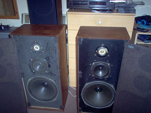

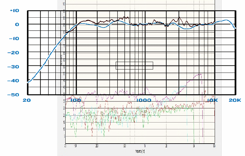

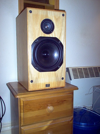

Three-ways tend to have excellent power dispersion. As in my Celestion Ditton 44 below. Once you limit yourself to two-ways, the dip in power response becomes audible around 3kHz with 1" tweeter, illustrated below including approximate power response. A waveguide tweeter however matches up better on dispersion than flat baffle 8" plus 1" solution. Currently I'm also trying flatter power response BW3 and 2" cone tweeter to solve this.

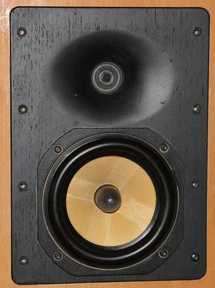

An elliptical waveguide on a flat baffle is a negative thing as I see it. Take a ribbon tweeter as an example, tall for narrow vertical directivity. A WG is not only taller but longer, so narrowing one behind a flat baffle increases the needed crossover frequency and increases dispersion below this point.
The Mackie shown above gets wide (shallow) at the edges which is a better way to deal with it's limited space.
