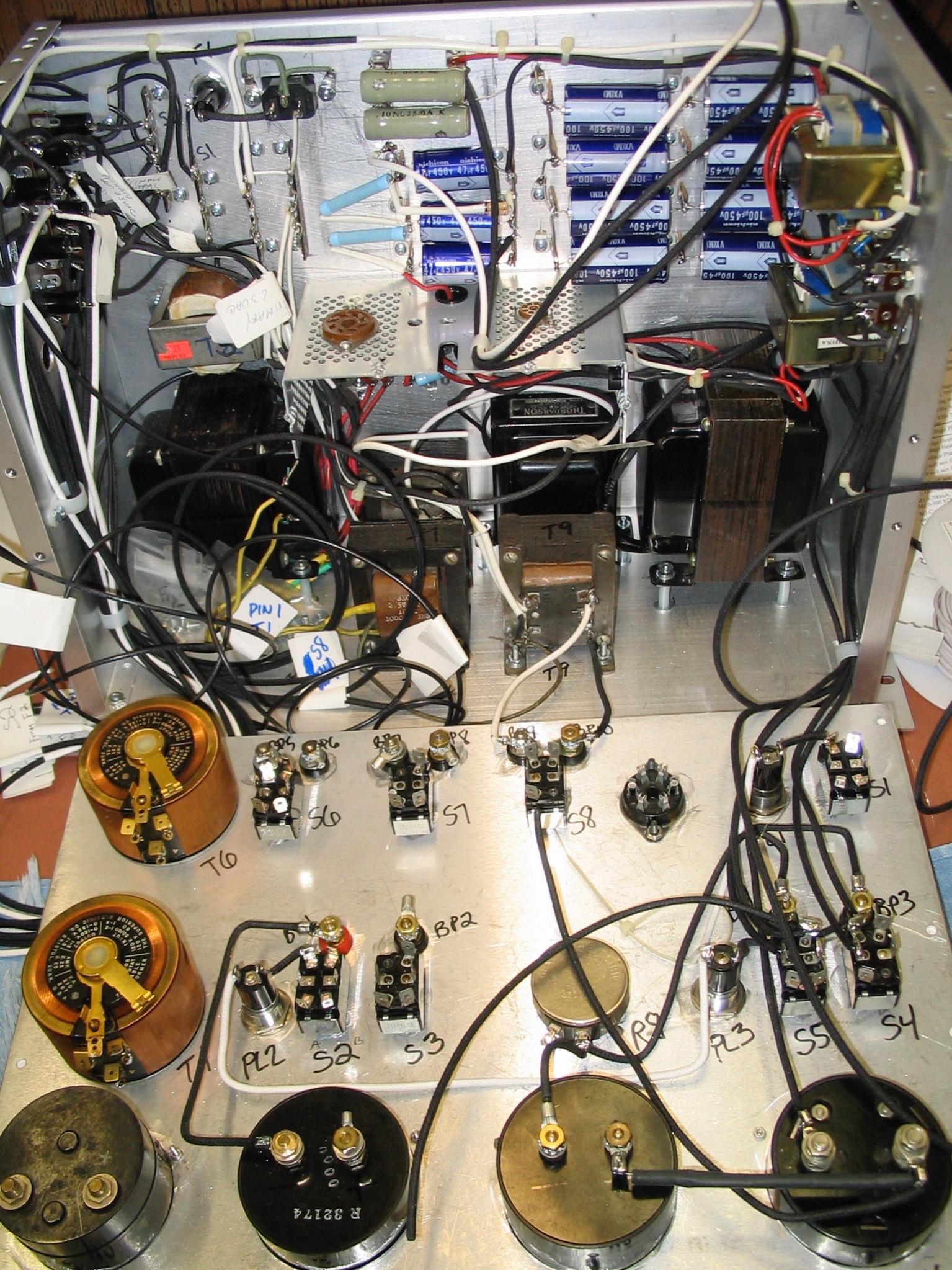

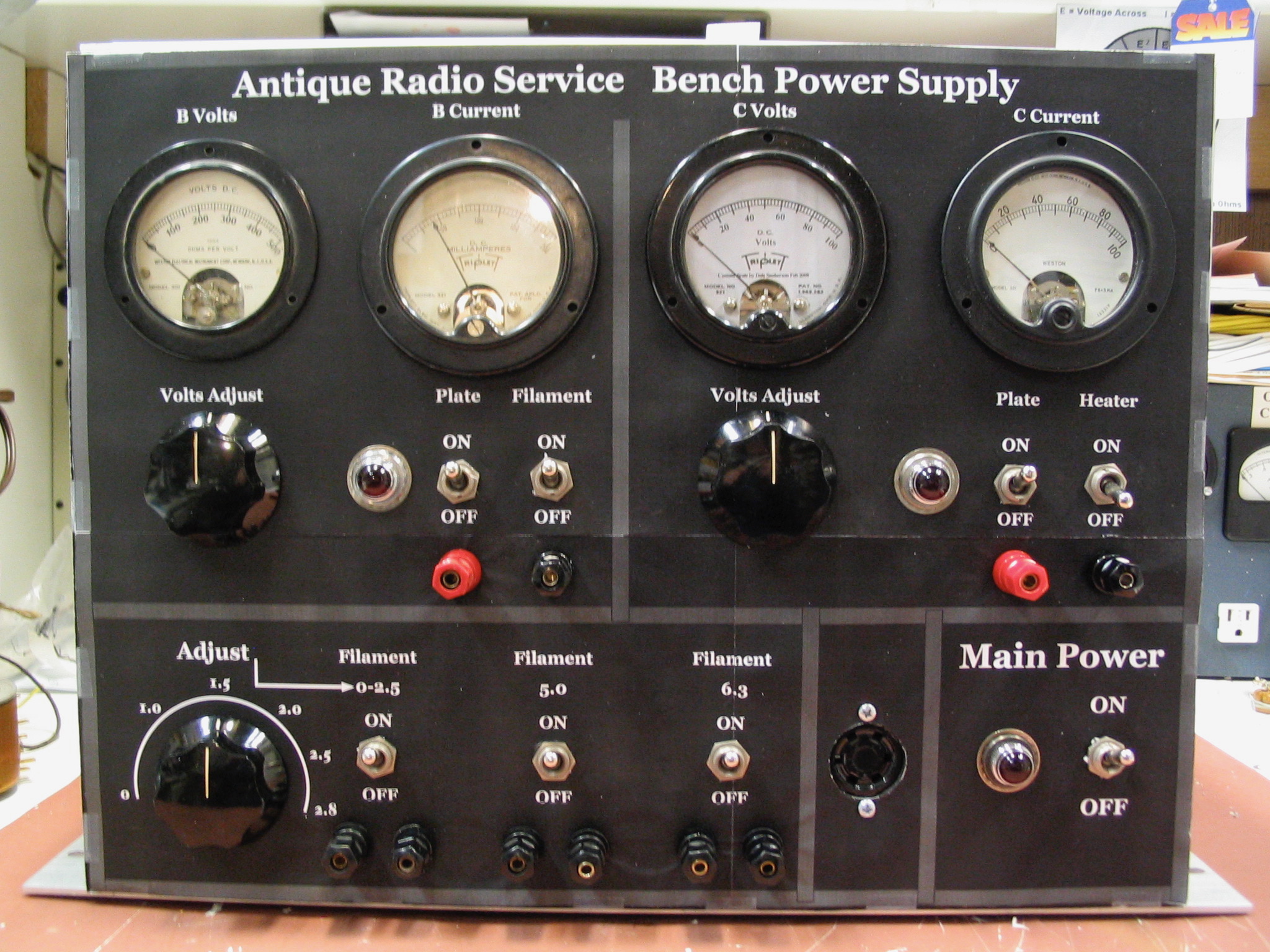

This is what happens when you let a simple DIY bench supply go a bit wild.
18 x 8 x 14 inches. 2 chokes, 2 variacs, 9 transformers, 10 fusees, 60 pounds.
Goals, man. Seriously. Very nice.
