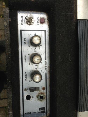

In the attachment there are some images of this device, which maybe I get in the next three weeks for looking.
Thank you for your advices.

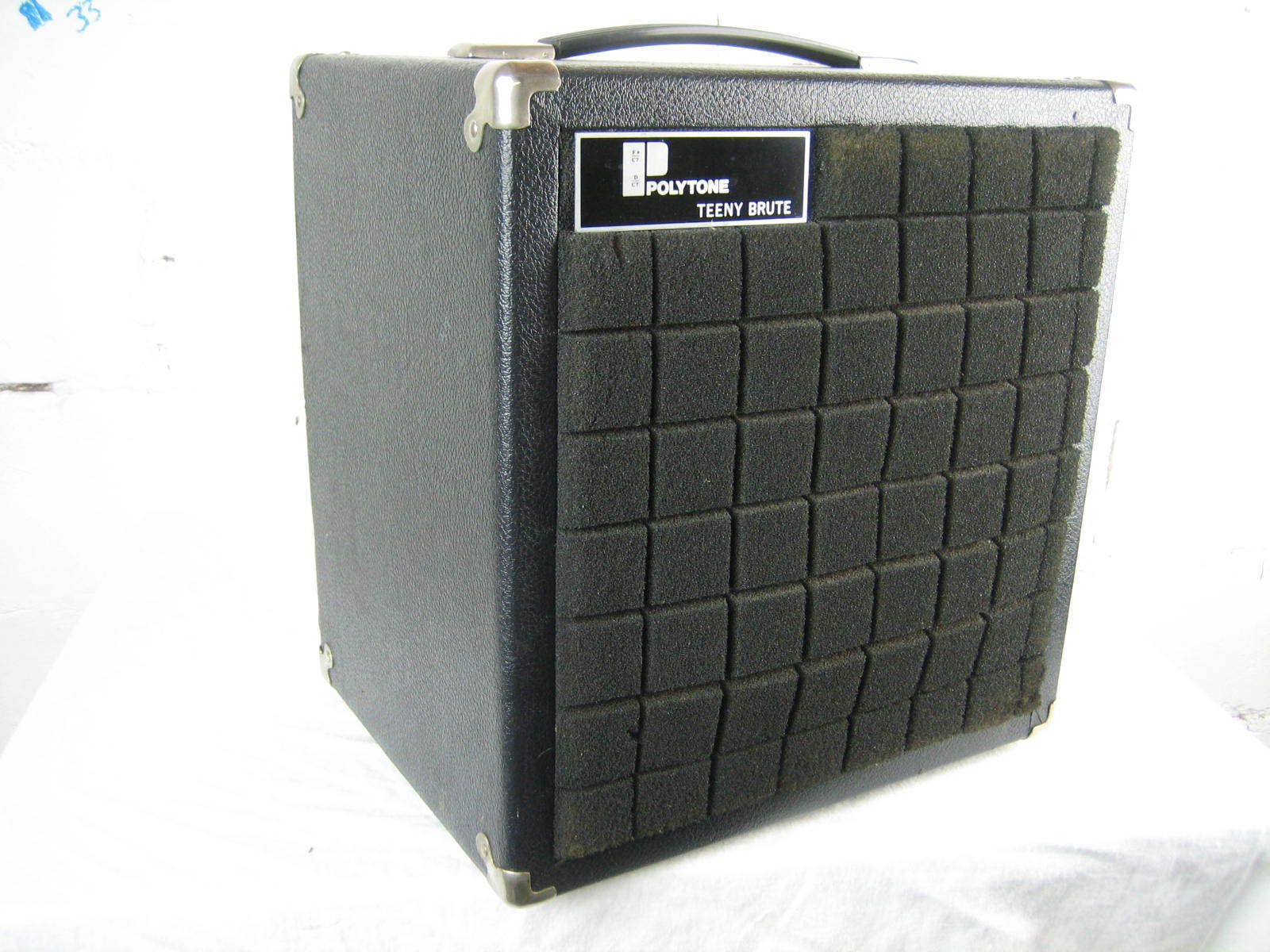

In the meantime I have the version here, from which are you find the pictures in my previous post and the describtion by German ebay auction
Scheunenfund Polytone Minibrute 12" Basscombo | eBay
Therefore I will post some technical details, which I have find out by troubleshooting :

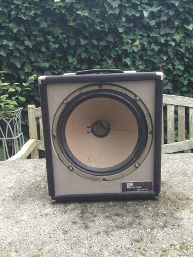

The voice coil DC resistance of the used transducer is 3 ohms and between power amp output and transducer I have found a serial resistor of also 3 ohms with 10 watts (ceramic version).
On the magnet of the used transducer are to read two numbers:
1) "12-0147"
2) "137 7942"
The voice coil diameter is approximately 45mm and at the basket I count only 4 windows instead 6 as mostly by currently available Eminence models.

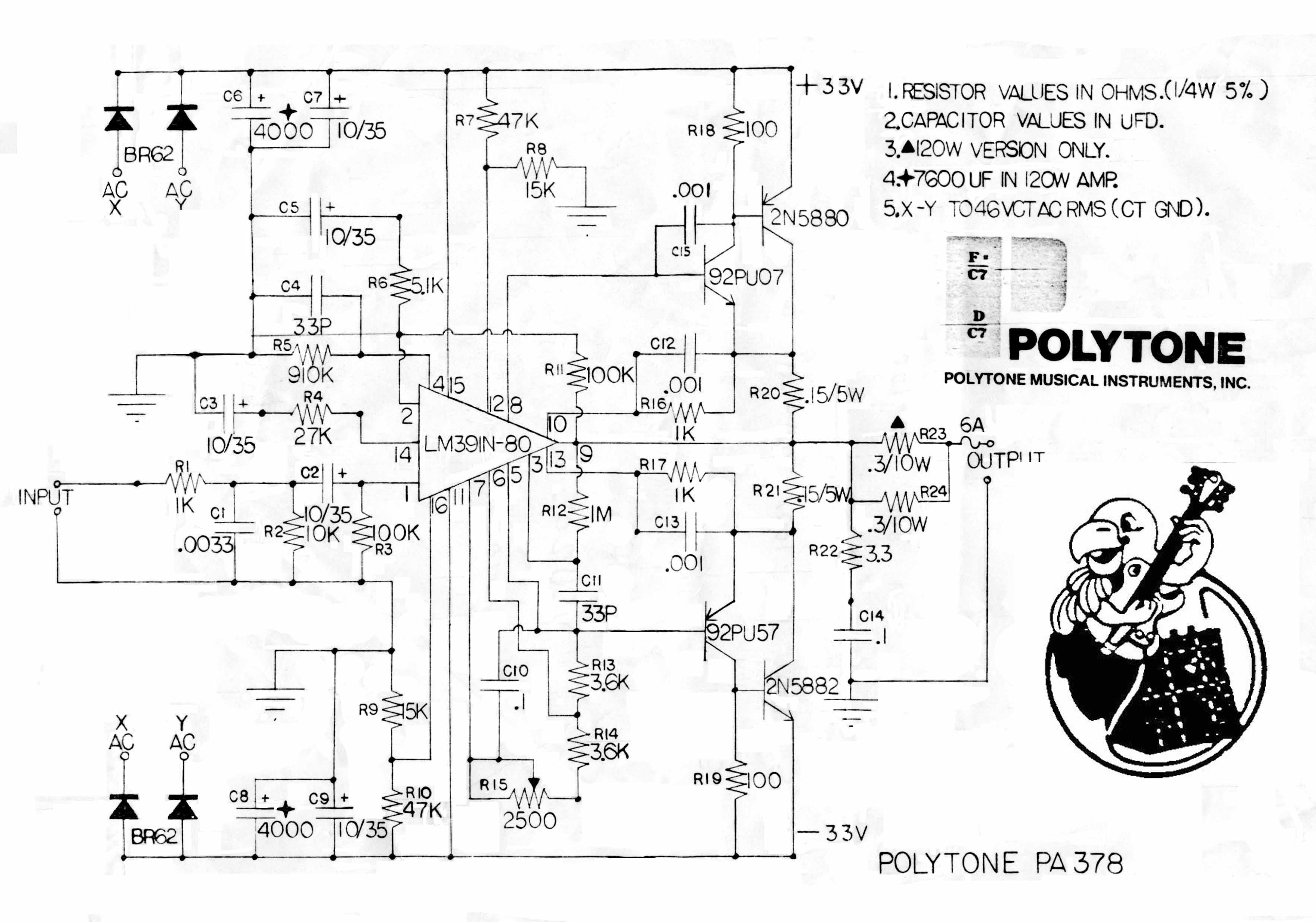

Here some informations about the used power amp in my version (I have create a schematic and I measured the voltage on the supply rails).
In the front-End works a LM391N-80 (include Vbe multiplier for BIAS in the output buffer stage) and the output buffer stage is a Sziklai (compound) darlington - 2N5880/MPSU07 in the pos. half and 2N5882/MPSU57 in the neg. half. Supply voltage (measured without input signal, i. e. without sound from the speaker) = ±33VDC.

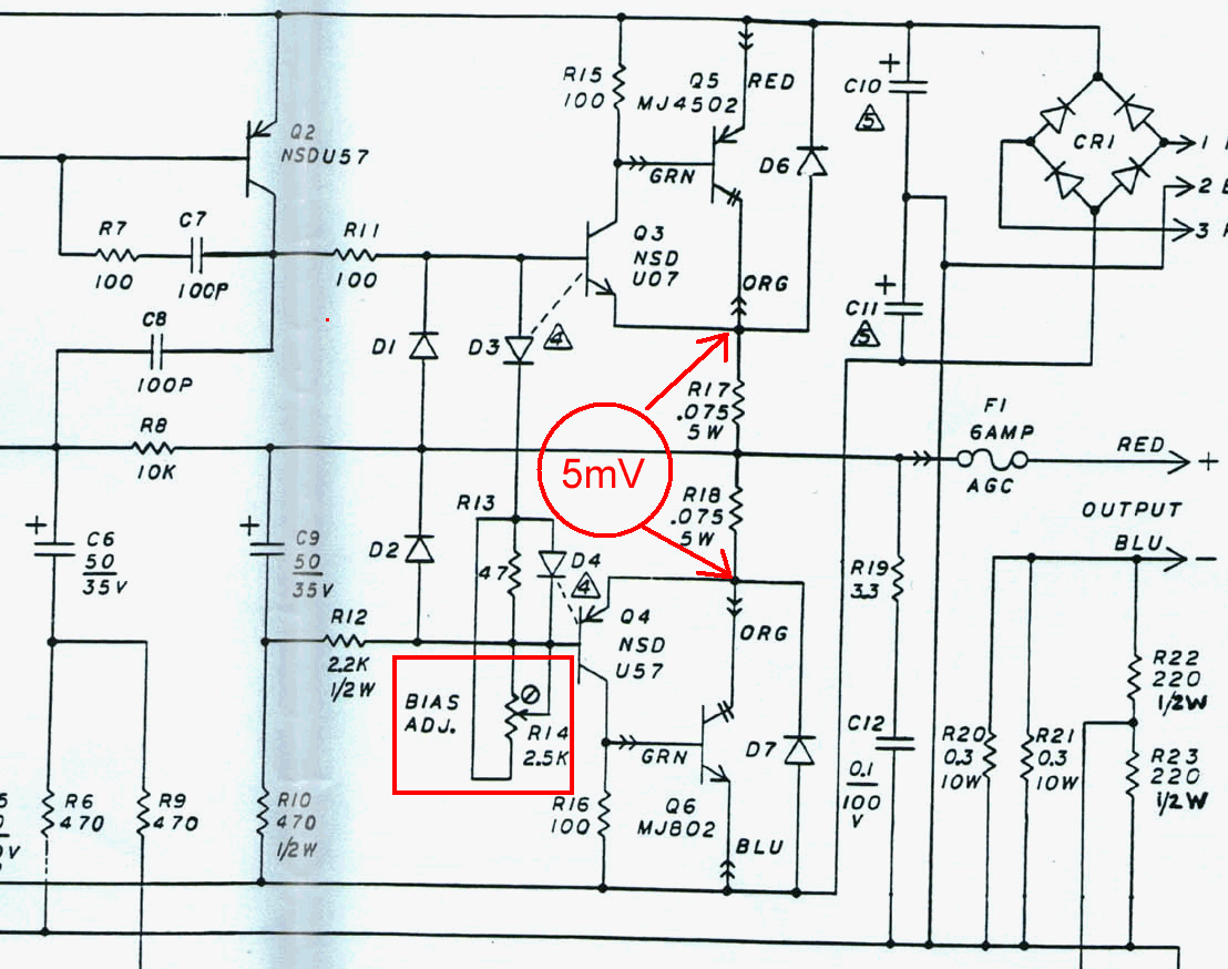

Idle (quiescent) current in the power transistors are only 1 mA.
The power amp main board is follow version: "PA378A" manufactured according imprint on the component side at 12.05.79 M
The Preamp with baxandall equalizer (bass treble) works with two pieces of RC4739DB (quad operational amp from Raytheon). Input voltage for the on-board votage regulators 7815 and 7915 are +/- 20VDC.
The differences between the version which I have and the version from ebay auction
item No 261299452085 about the URL
Clean 1978 Polytone Mini Teeny Brute Guitar Upright Bass Amplifier 10? Amp USA | eBay
(comes from the same time area - unfortunately pictured only with dust cover) are follow:

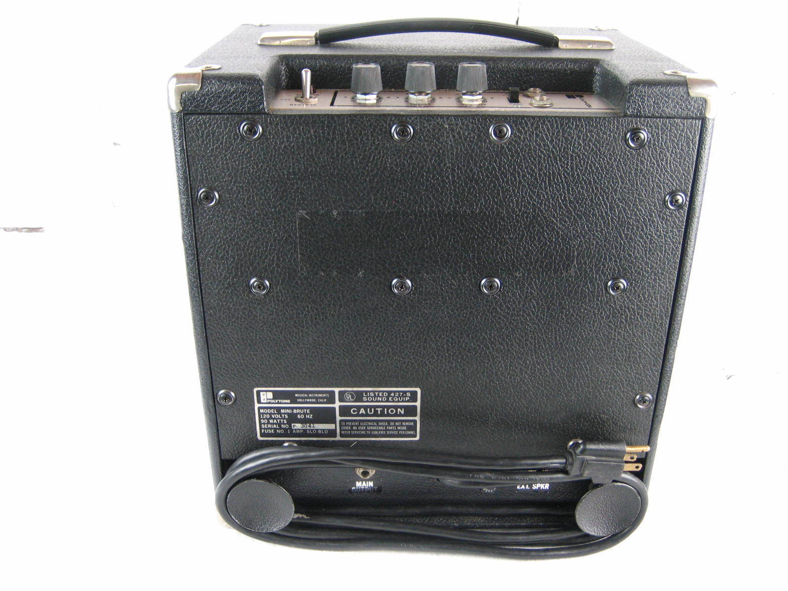

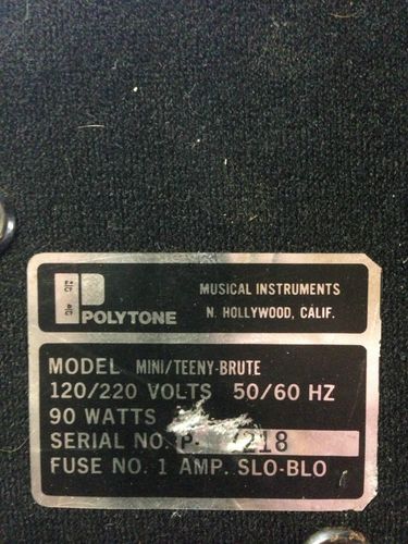

1) Sticker with serial No:
On the device, which I have for service, I read:
MODEL: MINI/TEENY-BUTE - 120/220 VOLTS 50/60HZ 90 WATTS SERIAL-NO. "P. 7218" FUSE-NO. 1 AMP.SLO-BLO
On the device from mentioned us ebay auction I read:
MODEL: MINI-BUTE - 120 VOLTS 60HZ 90 WATTS SERIAL-NO. "P. 3041" FUSE-NO. 1 AMP.SLO-BLO
Additional I read follow: UL LISTED 427-S SOUND EQUIP.

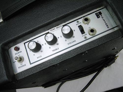

2) Front-Sticker:
On the device, which I have for service, in the right corner at botton model MINI BRUTE
On the device from mentioned us ebay auction in the left corner on top, model TEENY BRUTE
3) Operating panel:
On the device, which I have for service I read: model MINI BRUTE
On the device from mentioned us ebay auction auction I read: model TEENY BRUTE
Sometimes there is to read "Mini-Brute", sometimes "Teeny-Brute" and sometimes "Mini/Teeny-Brute". This I don't understand. What means that exactly?

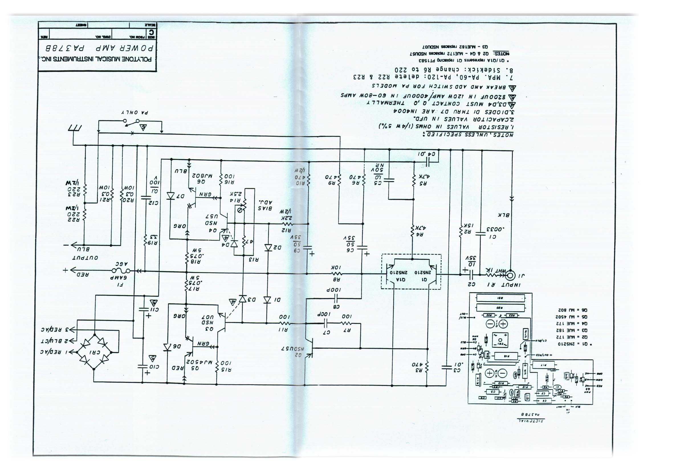

The only electrical difference between this both versions, which I can say, is the mains transformer itself - version from mentioned ebay auction is an us model with only 120VAC mains input voltage, while version, which I have, is suited both for 120 and 220VAC (mains transformer uses primary windings for both voltages).
The schematic from attachment is not the same, which I have - maybe a newer or older version - only the output buffer stage topology is the same (schematic is helpful for discrete replace of a defective and no longer available LM391N-80 (out of production).
Here the pictures from the ebay us auction:

1) the regular Polytone speaker is an Eminence, think one from the Legend series, check which one is available in 4 ohms, shown by your reading of 3 ohms voice coil DC resistance.
Way back then they were made by CTS , of which Eminence is the "heir" , Mr Bob Gault used to make speakers at CTS and when the Company was in financial trouble, he continued on his own, that's why old speakers on both brands "are the same under the skin" .
That speaker was OEM/custom built , a very close modern version may be:
US Speaker - Eminence Texas Heat speakers - The Eminence Texas Heat is a 12" guitar speaker with tight bass and good top end bite from the Eminence Patriot Series. The Eminence Texas Heat speaker is an excellent upgrade or replacement for guitar cabi
This one is also very close to the original Polytone speaker:
Jensen C Series guitar speakers. The Jensen C12K 12" speaker. Great choice for lead guitar cabinets. 4, 8 or 16 ohms.
the codes you read mean:
1) "12-0147" <-- Polytone in-house part number
2) "137 7942" <-- 137: CTS EIA code ; Year "79" , Week "42"

The series resistor you found is 0.3 ohms, and the intended purpose is to reduce amplifier damping, for a smoother looser sound.

2) You seem to have the infamous LM391 driven power amp:
not because it's bad, far from that, but because LM391 are no longer made (for decades now) and very hard to find.
FWIW I think I have 1 or 2 , from the old days, which I keep in case a dead Polytone visits my shop.
But if yours works, fine, it won't die on its own, amp death is generally caused by shorted speaker cables or plugging 57 random cabinets, the toaster and the freezer in the poor output, not your case 🙂

*Might* be 44mm diameter but that would be quite unusual in that time and age, because it's a typical "British" size: 1 3/4" or 44 mm, way back then popular "American " size was 1 1/2" (38mm) for almost everything and 2" (50mm) for high power speakers.The voice coil diameter is approximately 45mm and at the basket I count only 4 windows instead 6 as mostly by currently available Eminence models.
Resist the urge to "improve" the speaker with a more "advanced/modern/exotic" one , the amp was equalized with the one you see there, by modern standards it would be considered more of a fat Guitar speaker than a deep Bass one, but a real Bass/PA woofer will be wasted there, the box is way too small for real Bass and the heavier cone and voice coil will kill mids and treble, you will lose definition big way.
Plus a heavy speaker will be hard to drive for the internal 90W amp .
Respect what the original designer intended.
And if the original speaker works properly, leave it there.
3) as of Mini/Teeny/Maxi Brutes, all of them have the same basic preamp and 2 flavours of Power Amp (LM391 and discrete) and all sound the same, model names refer to different size and speaker complement, you will find from single 8" (Tiny 😉 ) to single 12" (Mini) to 2 x 10" , 2 x 12" , single 15" , even a monster (for their standards) 2x15" , and some adding a couple Piezo tweeters for Voice or Acoustic Guitar use, but by far the most popular was the single 12" one.

Hi there, I have a strange problem with this amp. It burned down: R17 100ohm resistor, drivers, LM391, one 0.15 5W resistor, power transistors. I replaced the resistors, the LM391 and the drivers. I checked the voltages with bulb limiter inserted and without the power transistors. I got:
MJE 182 (NPN)
E 0
B 0,6
C 29
MJE 172 (PNP)
E 0
B -0,6
C -29
I know the MJEs have a different pinout than PU57s.
The bias potentiometer works, I can set the -0,6V on the MJE 172.
On the pin 7 of the LM391 is cca 1,2V.
and now the strange thing:
When I put the power transistors the bulb starts to light and I have about 90mA on the power resistors (0.15 ohm). The bias potentiometer has no influence on it. The power supply voltage gets down from +-29 to about +-8V.
When I take the LM391 out and connect the pwr transistors on, I get these voltages:
MJE 182 (NPN)
E 28,9
B 19,8
C 29,4
MJE 172 (PNP)
E 28,8
B 28,2
C -29,2
Any suggestions please...? Thank you
MJE 182 (NPN)
E 0
B 0,6
C 29
MJE 172 (PNP)
E 0
B -0,6
C -29
MJE 182 (NPN)
E 28,9
B 19,8
C 29,4
MJE 172 (PNP)
E 28,8
B 28,2
C -29,2

I’ve read some of your posts about polytone amp. I got a MbII from 1980. I would ask if is normal to have hum, even with low volume. Plus, the amp sounds flat, no dinamic, very very flat sound. What’s the cause in your experience?
thanks in advance for your patience.
Hadn't seen it 😉 <snip>
No, it shouldn´t hum, not with nothing plugged in and volume on 0.I got a MbII from 1980.
Is it normal hum, annoying but you can still play or **LOUD** hum, and you can not play, no instrument sound comes tjhrough?
Because in the latter case you may have a blown power amp.
Post a couple pictures, one showing the back top control panel, one showing the bottom cable/jacks/etc. bottom panel, specially showing the model/serial number plate for better identification.
Do volume and tone controls work?
Polytones are designed for*Jazz* , so dull dark flat sound compared to "Rock" amplifiers.Plus, the amp sounds flat, no dinamic, very very flat sound.
What instrument are you using?
In my personal point of view, they are flat amplifiers, driving flat speakers, circuit is very similar to what you find in a Home Hi Fi amplifier, basically same tone controls, inside **tiny** closed cabinets, not much larger than the cardboard box speakers are shipped in, not kidding.
Such a cabinet tends to sound "boxy" (I wonder why 😉 ) so Polytone chock fills them with tons of fiberglass damping ... that also contributes to typical sound.
That said, that "mostly midrange" sound is great to deliver acoustic/double Bass sound, better than a modern one:
Here they compare a very modern and powerful MarkBass amplifier, 300W RMS 😱 modern Kevlar cone speaker, Tweeter , a second "Acoustic" specialized amplifier, again with woofer and tweeter for wider range, to an ancient, 40 years old design Polytone, with a standard Eminence speaker in a closed box.
The Mark Bass sound fine, but the Polytone produces a better, more "acoustic"/realistic version of what the unamplified Double Bass sounds like ... and that´s the idea behind it.
No wall shaking bass, no glass breaking highs, just "same sound but louder".
YouTube
Cool, now do the suggested tests: what happens to hum at variousvolume levels,do tone controls work, what instrument are you using, etc?
You set EQ to "Dark" ,what happens if you set it to flat or bright?
I’m using Gibson L5. In dark position seems more quiet, less hum. Even when I down the treble.
but still there. The reverb also is hum but I can live without it.

hi JM
Do you know how to adjust bias ?
here is the scheme :
/Users/pascalmollet/Documents/Elec/Schématics/Polytone/schem2.jpg
Broken link above, this one?
https://music-electronics-forum.com/attachment.php?attachmentid=26069&d=1383079112

Carefully (it´s sort of jumpy) adjust bias pot until you read some 5mV across both emitter resistors, end to end (I measure them that way because they are very low in value) , which means an idle current of about 33mA .
It´s high enough to free you from crossover distortion.
