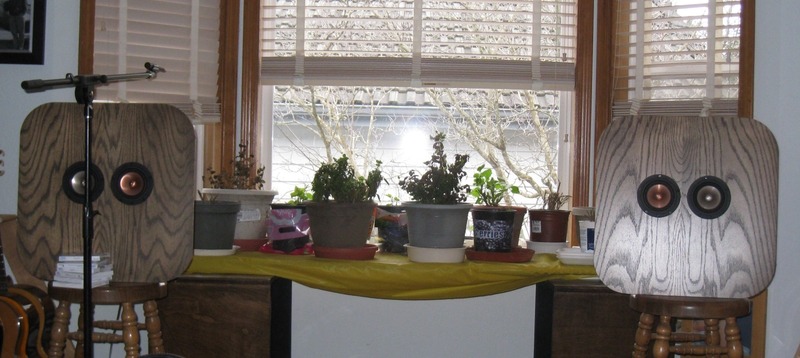

My system has no balance control - just volume. The SDA driver (silver) is wired in series and out of phase with the main driver (copper) on the opposite baffle; I could add a DPST switch to disable the effect; maybe pull the cable between yours to see if the imbalance goes away in "normal" mode, if Polk's circuit design supports it.

Any crossover in these?Mine is SDA-OB
If not, you will have tonnes of comb filtering effects which at times will be so strong that the balance will be totally off. This is exaggerated by mounting the driver pair horizontally.
Nope. The SDA drivers run full range, sometimes with the SDA driver padded down in relative volume to the main driver.Any crossover in these?
I know Polk eventually discarded the idea of SDA tweeters in his designs and limited the bandwidth of the SDA cone drivers. I'd need two more channels of DSP / Amp to do that, or go to a parallel connection with passive crossovers. That would put amplifier load down to 2 Ohms for some of the frequency range, which it could supposedly handle.
I've no idea what frequency range I'd want to design the crossovers to, to prevent the combing. Apparently Polk's design evolved so that all the audible frequency range wasnt necessary to provide the effect. I havent had the chance to measure a real modern Polk SDA, to see what bandwidth comes out just the SDA drivers.
