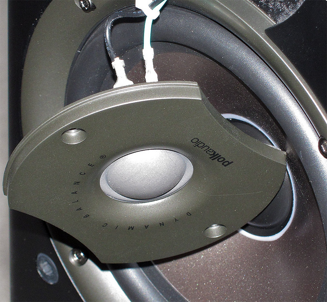

due to a holiday impulse buy (lol) I have a pair of polk monitor 70's.
I tried them and didn't like the sound but thought that maybe the cabinets are salvagable and with some driver replacements and active crossover (maybe eq) it could be passible.
is this is a fool's errand? tell me now that there's no way to make this into at least a mid-fi system and I'll stop and just sell them as used.
but I'd like to give it at least a chance. this is a tower config with 4 6" holes and one 'mtm' tweeter hole toward the top. there's also a port at the bottom/front. I currently do have an active crossover (dcx2496) and am building some chip-amps for the various driver channels. I don't really see the need for a passive crossover and that gives me a lot of freedom in picking drivers (no?)
the as-shipped config seems to be the bottom 2 6" drivers in series and being a bass or midbass system. there is a roll of padding between the lower 2 and the upper region (the mtm area). maybe I can have 1 *good* aftermarket driver in the lower area and have a 6" round mdf disc made to cover the other hole. that wouldd be a lowpass section.
on top the tweeter hole is non-standard and so its a loss for all but the smaller surface-mount style tweeters. maybe I ignore the factory tweeter hole, cover it up and put the new tweeter up in the top woofer hole, with a suitable mdf bezel plate made for it.
finally a midrange could fit in the remaining 6" hole. any size driver less than or = 6" would fit with another mdf bezel.
I took some shots of the drivers that come shipped with this speaker system. I'm not sure they are even worth using. the question is: is the cabinet worth using; or is it too backward to try to find drivers to fit just a 'chassis' instead of the other way around?

Try and send them back?? I think you may have already answered your own query, I hope you didn't spend too much money on them>
I hope I didn't come across as too flippant
I have made the same basic mistake myself too many times to count.
Perhaps you can Bi / Tri-amp but a quick look suggests that tweeter would have cost the manufacturer about $1- unless it actually is a Neo and my own feeling is that 6inch is too big for MTM set-up; although that is open to debate depending on the quality of the chosen drivers, how much bass do they have?
How do they sound to you "As is"

OK i am no expert but i can try ( and play devils advocate ) are all woofers the same? Do you have the ability to measure the parameters? can you find the makers parameters for the drivers if you can't measure them???

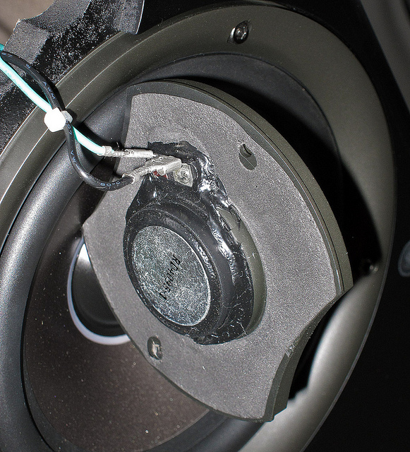

yes, all shipped woofers seem identical. very cheap, not good sounding, meant to look flashy is my guess. I am very willing to dump ALL drivers, in case that was not clear.
there's no way I can get specs on the included drivers. I almost don't care 😉 at best, I *might* be able to use 2 of the original drivers in the lower section as pok sort of intended. they came wired in series (those 2 6" woofers) and that was on the lower 2 posts on the spkr terms on the back. its possible that if they are crossed over low enough, they won't sound so bad and are left as a midbass system.
above those 2 holes is a roll of padding that polk placed in there. it seems they meant that as an isolation barrier. keeping with that idea, the lower region can handle the more air-moving bass and the upper can be a SMALLER driver than 6" (with a bezel adapter) and a tweeter in teh final remaining 6" top hole.
the tweeter factory hole seems useless and I'd put the factory tweeter back and just leave it disconnected. once the black cover is over the speaker system, all evils would be hidden anyway.
so, I am willing to order some tweeters, build a bezel adapter from mdf and try to make due with a good set of mid/tweeter in that upper region and see if that is at least listenable. then I'd power the lower section and see if the extra bass was helpful or worked against the system.
and again, I know this is somewhat backwards in how to design a system and I know that even if I pick decent drivers that work well together that they might need 'some work' to sound ok in this box. I realize that but I'd like to know if its do-able or if its just throwing good money at bad.
if I don't use the stock drivers, maybe someone who owns this set and likes them will buy them locally from me. who knows. but using the stock drivers is NOT a design goal and I'm happy to dump them. very happy, actually 😉

not sure if this image will show or not, but this is what they look like from the stock photo:
those drivers are going to be nasty at $199 for a pair of speakers with that many drivers and such a large box. Don't know what your driver budget is but I have personally thinking about using an Alpair 5 as a >800Hz driver in a sealed box with a decent 8" - 10" bass driver and a sharp crossover. However such ideas would require taking the box apart to modify it internally and $199 is expensive for a pair of middling quality wooden boxes.
Can you check the wiring again and the DCR of those woofers please? if they are all 8R woofers then i would suggest keeping them all, wire them series /parallel and mounting them clamshell.
Then use the top half of the box and buy a decent midrange and tweeter or even 2 half decent 3inch mids and a tweeter for WWMTM arrangement

I just measured DCR, its 3.5ohms per woofer. I didn't bother with this thing they call a tweeter as I know its going to be scrapped.
Well my suggestion still stands, use what you have for the bass, spend some money on a driver with good midrange and power handling There is an excellent Peerless 6inch that has a round face ( most are truncated ) the 830869

Hang on a sec. Before you throw out the baby with the bathwater..
Don't assume that because the Polks were $150 that the components are uniformly crap. For one, the Model 70's retailed at more like $500/pair, not $150/pair, so tossing all the drivers because you think Polk paid $5 each for them may not be the best conclusion.
You said you don't like the sound of them, but you didn't explain what was it that you didn't like. Too laid back? Too muddy? Too forward? You know that a lot of the sound of a multi-way system is in the crossover design, and a poor xover can make even "premium" drivers sound terrible. It may be that those drivers and cabinet sound good if crossed over properly. Unless there are serious, serious FR or distortion problems, a good crossover would probably make a huge difference. If you replace the drivers you're going to need a crossover anyway, whether active or passive.
What you might consider doing, and this might be more fun anyway, would be to get one of the woofers and the tweeter measured and get their FR graphs, then see if anyone here is up to the challenge of designing a decent crossover for it considering that data, the cabinet dims, your listening preferences, wattage available, etc. It's possible $30 of inductors, caps, and resistors will turn your speakers into what you were expecting.
In fact, I know someone (on another board) that does free crossover design if you just send them drivers to work with.
It may turn out that the woofers are fine but the tweeter has enough issues to be uncrossable, but at least then you know you just need to replace the tweet and can make the rest into something workable.
- polk monitor 70: worth any kind of upgrade or not?
