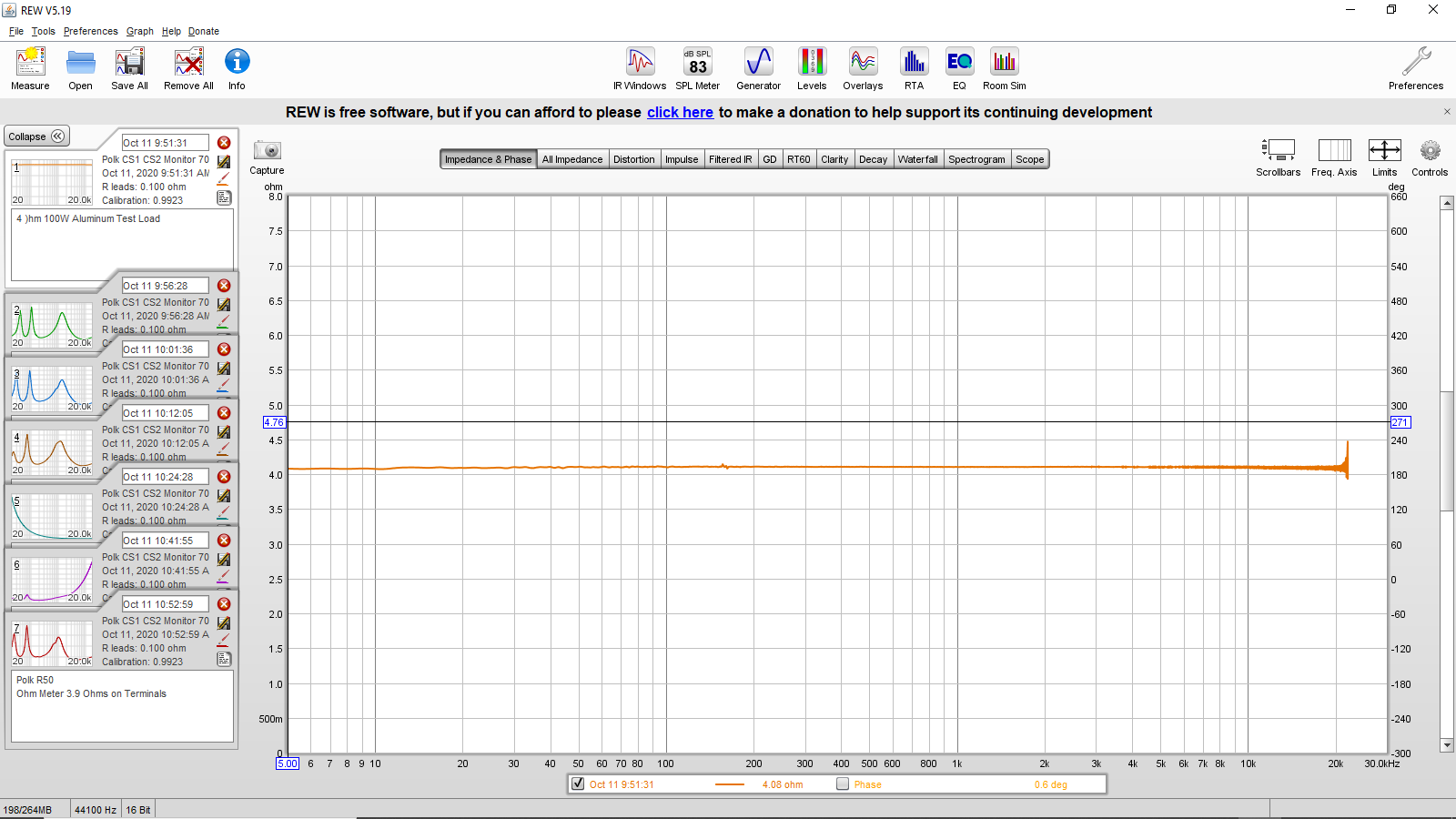

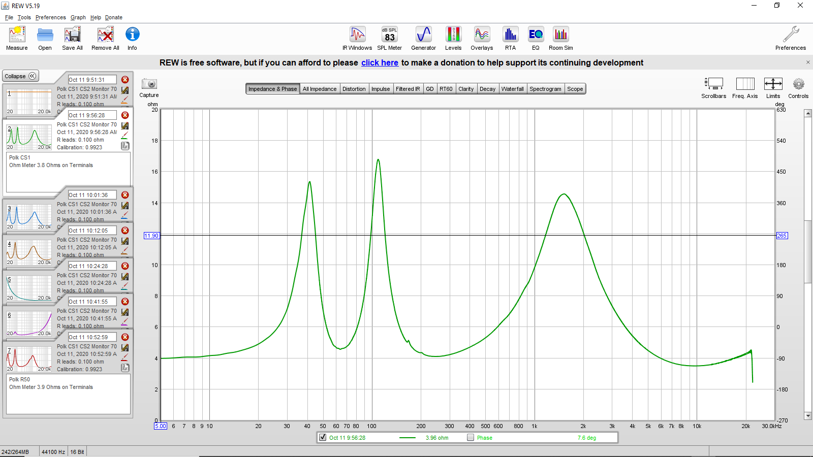

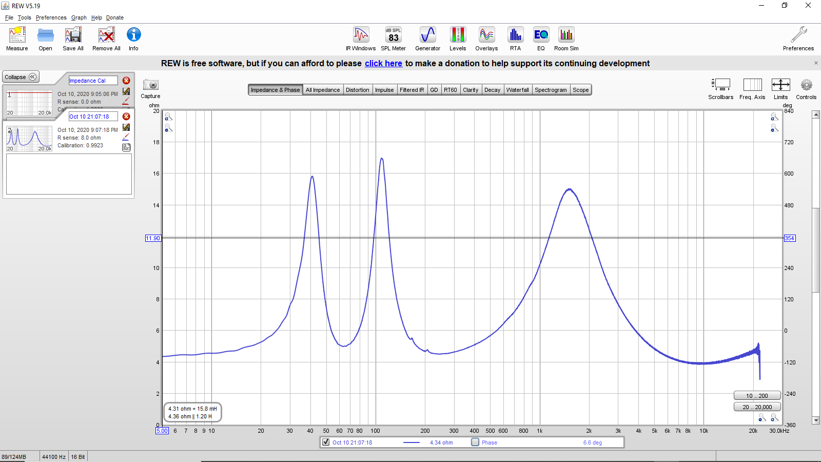

I tried to measure the Polk CS1 impedance today and I get 4.3 Ohms but with huge spikes to 16 Ohms.
Does this look right? I have never measured speaker impedance before. I am using REW and an 8 Ohm sense resistor.

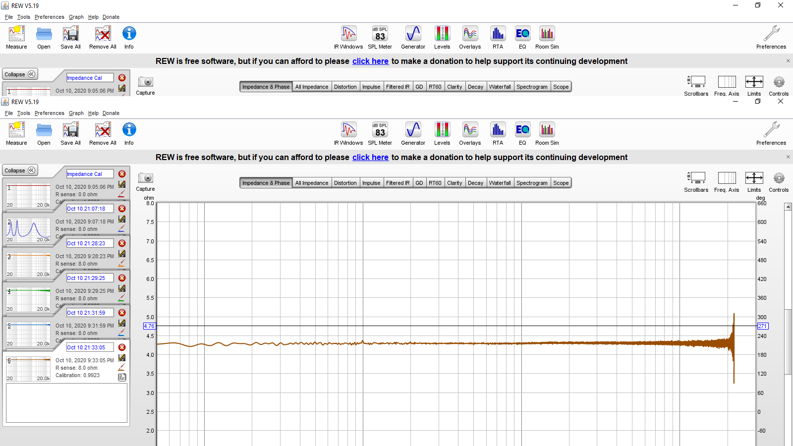

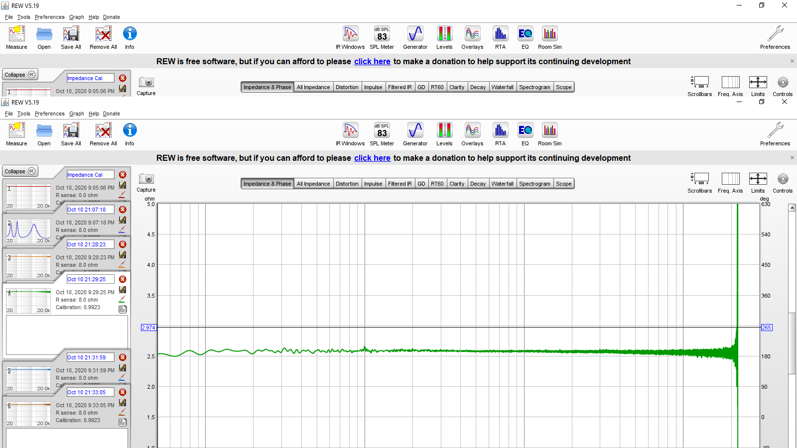

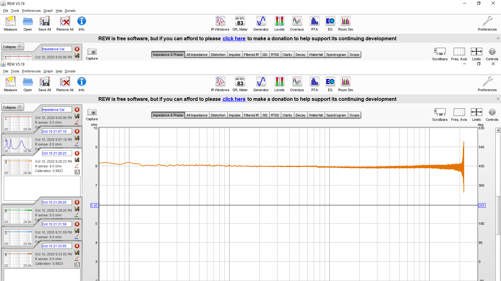

By the way I measured test load resistors with REW to try to make sure my measurements were valid. They seem to be ok for a 1/4W 10 Ohm Metal Film resistor and (8, 4 and 2 Ohm) 100W test load resistors. (Attached.)

  • 20201010 REW Speaker Impedance Test 10 Ohm Quarter Watt Metal Film Resistor.png

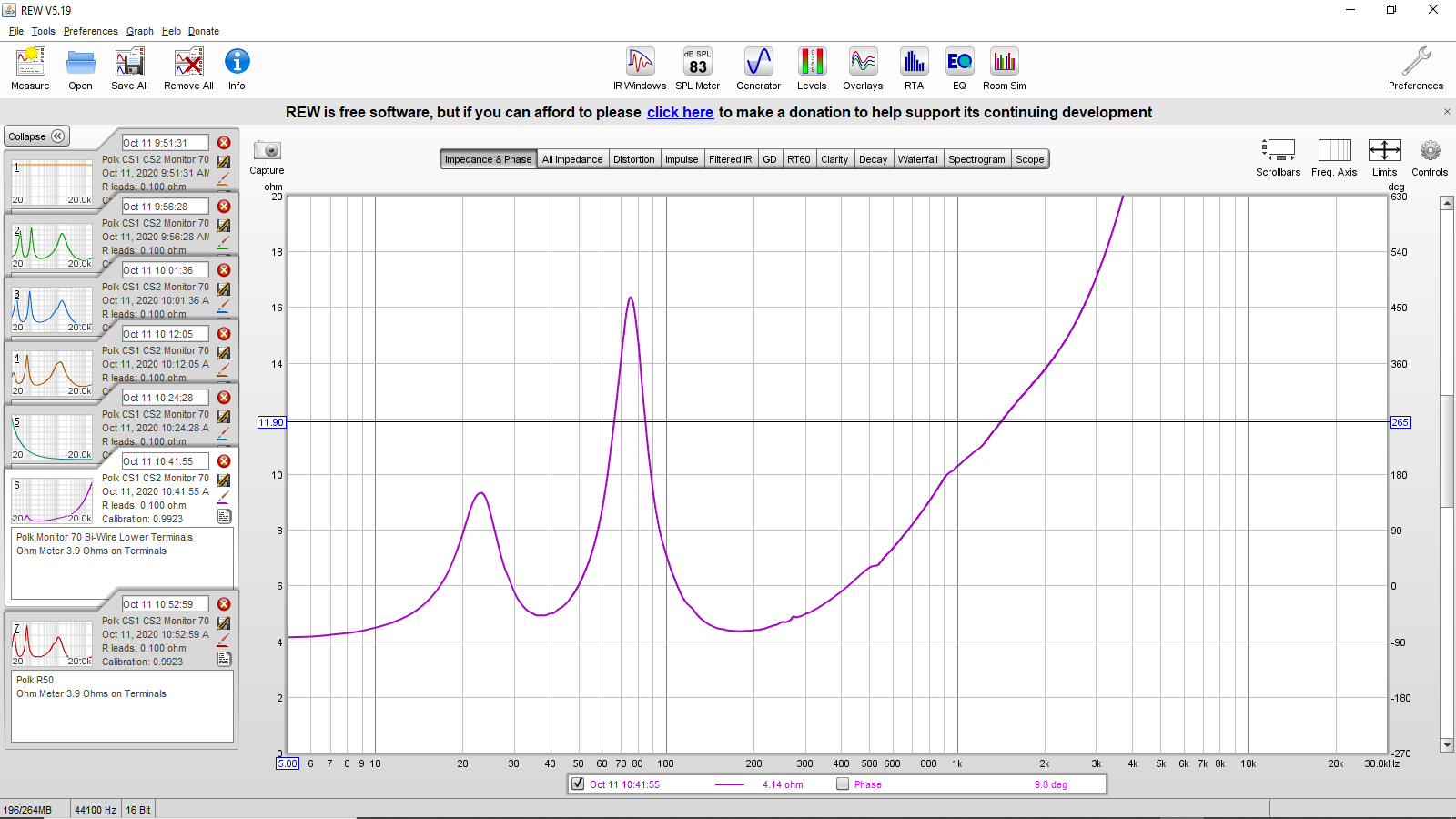

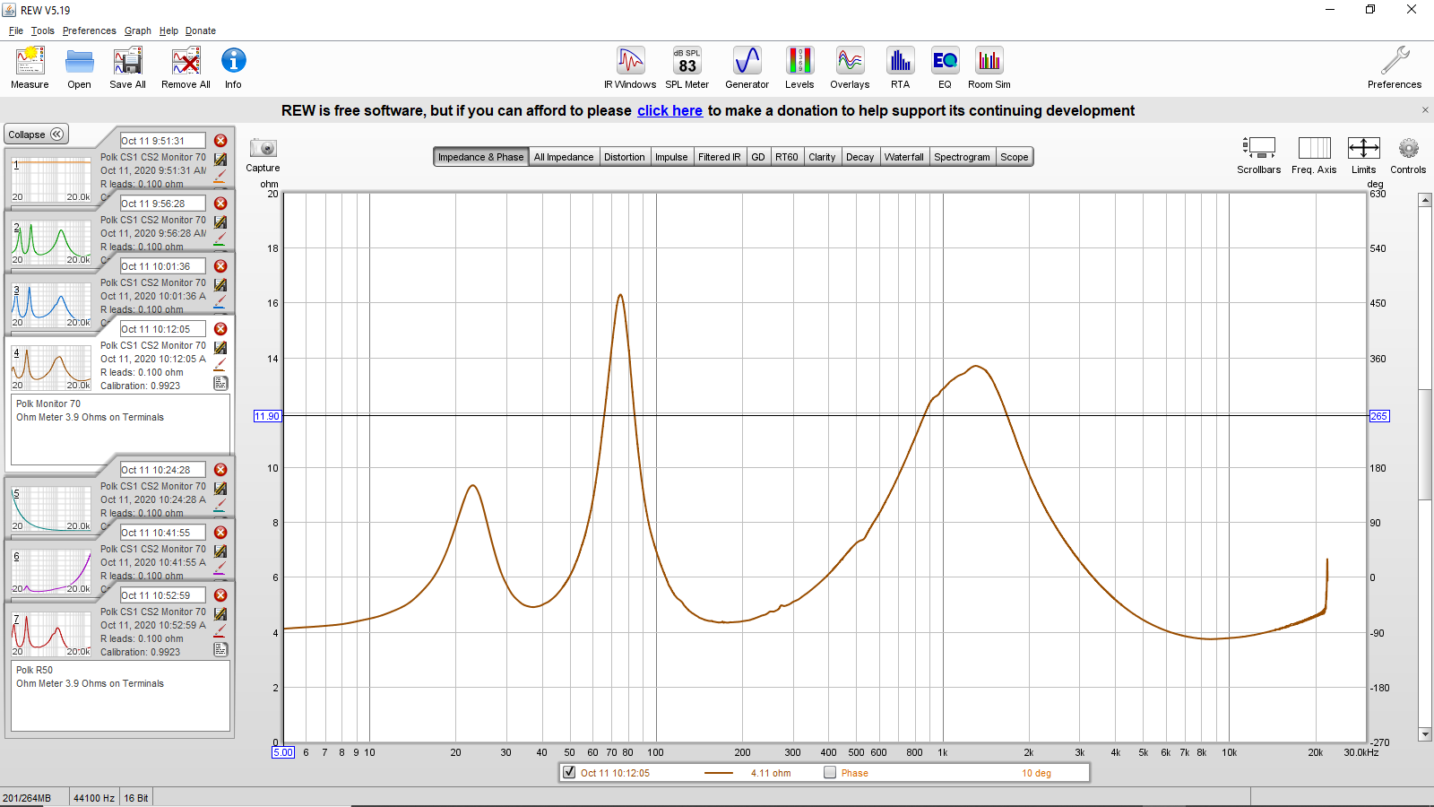

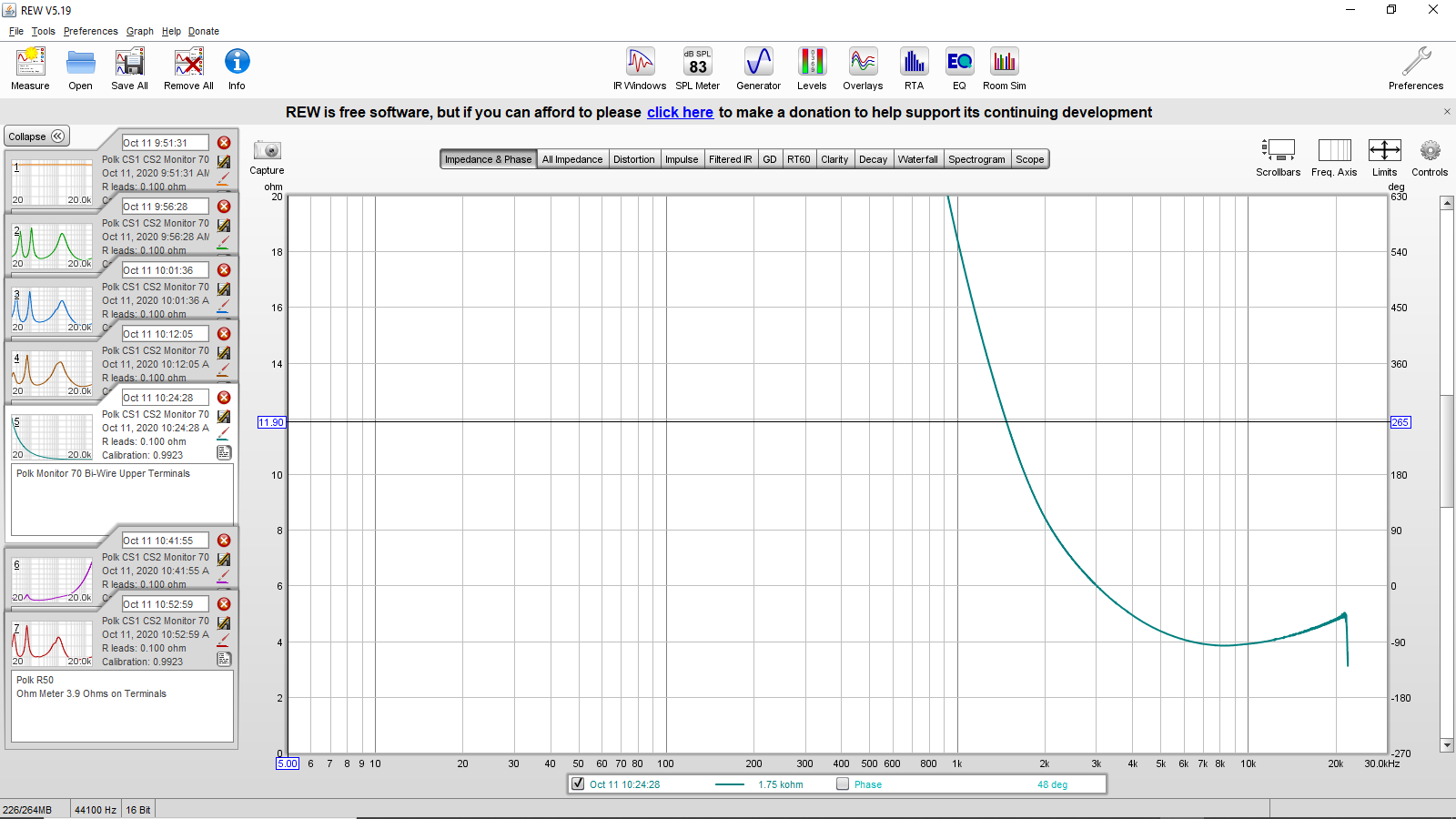

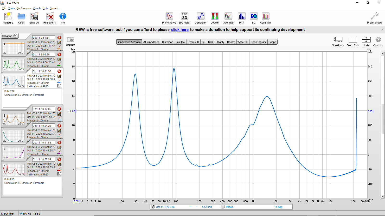

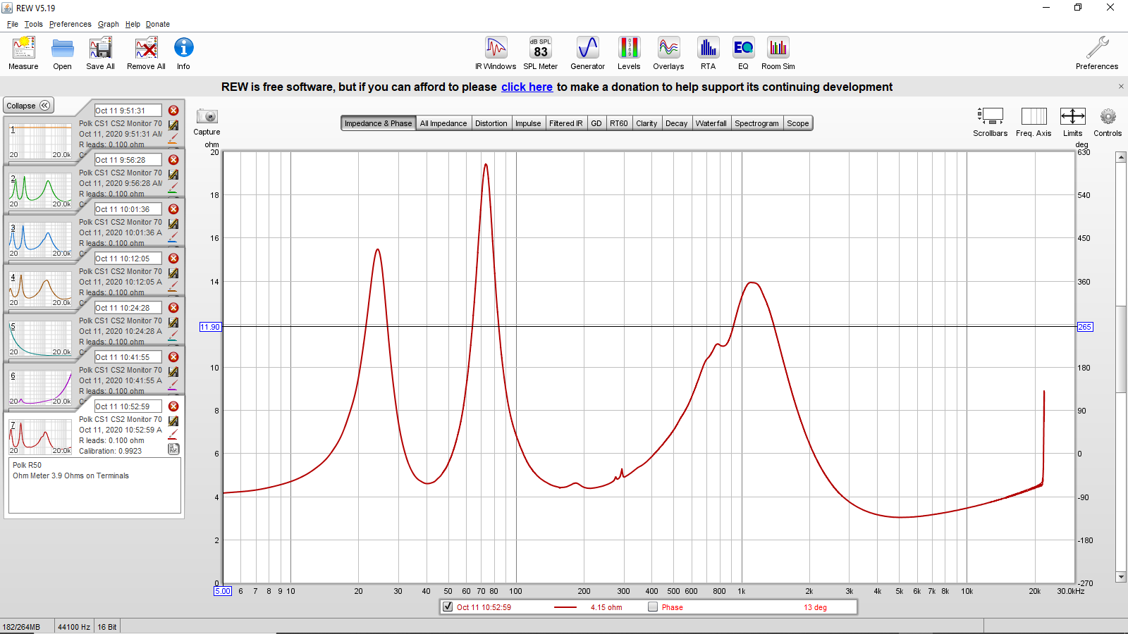

In case it is helpful for anyone else with a JLH or other Class A amplifier I have enclosed REW speaker impedance measurements for the Polk CS1, CS2, Monitor 70 and R50.
  • 20201011 REW Speaker Impedance Test Polk Monitor 70 Bi-Wire Upper Terminals.png

  • 20201011 REW Speaker Impedance Test Polk Monitor 70 Bi-Wire Lower Terminals.png
