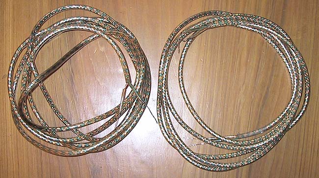

While browsing this site: http://www.high-endaudio.com/RC-SpkrCab.html I noticed interesting comment on Polk speaker cables. Yesterday, I met another local audiophile who had those cables and he indeed confirmed that they are one of the best.
Any idea about availability of those, as it seems like they are very rare now.

If these were the ones from late '70s/early '80s, they were total amp-killers. You can get the same result by hanging a 0.1uF cap across some zip cord- or, even better, orange Home Despot wire 😉
If you really want a low inductance solution with less capacitance than the Polk wire, try 4 parallel runs of RG-8. Connect all the shields together, all the cores together, and you have 0.018 uH/ft at 120 pF/foot. For an 8 foot cable that's 0.144 uH and 0.001 uF. Resistance is truly negligeable because each RG-8 is about 12 gauge, so the 4 combined are close to 6 gauge.

SY said:If these were the ones from late '70s/early '80s, they were total amp-killers. You can get the same result by hanging a 0.1uF cap across some zip cord- or, even better, orange Home Despot wire 😉
I was told that the secret to the sound of those was in special braiding. AFAIK, the HD wires don't use that technique.
SY was being facetious. The braiding which reduces series inductance also bumps up the parallel capacitance quite a lot, hence the remark about sticking a 0.1 uF cap in there. I like multiple fat coax for speaker cables because you get the benefit of low inductance with reasonable amounts of parallel capacitance. Note the WireWorld speaker cables are also coax, although I think my arrangement is more cost-effective than theirs.

Cobra cable was one of the very 1st exotic speaker cables. We sold them (for a while) in the late 70s. They were indeed amp killers -- one of the reasons we quit selling them.
I recently flogged off all 4 sets that i had.
They used 2 colors of enameled wire braided over a plastic core at approximatly 90 degrees with a sheath of clear plastic.
Besides the capacitance issue, there was a tendency for the enamel to scratch & short-circuit. They were also a pain to re-terminate.

Had a pair myself, the Bryston 2B never complained. 🙂 If I recall there was also an issue around internal shorting. The wire's ceramic coating could be damaged by stepping on it.
