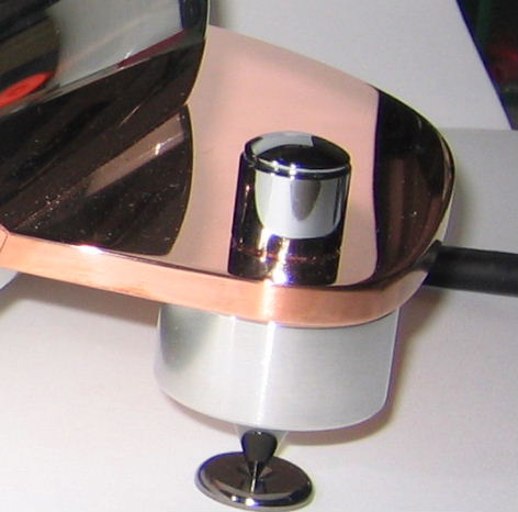

Once the major scratches are removed, I use #1000, then #2000 and buff with 3M #05973 rubbing compound. Then polish with Mothers Billet Metal Polish or similar. Other brands are fine, but Mothers is available everywhere. If you are doing small pieces, polishing by hand is quite easy but takes more time. I find that on small pieces, I get a more uniform finish than with my big buffing wheels. The piece gets hotter than hell and if it catches the wheel, it gets launched and destroyed. The photo is of a current project using copper plate. This was all done by hand.
