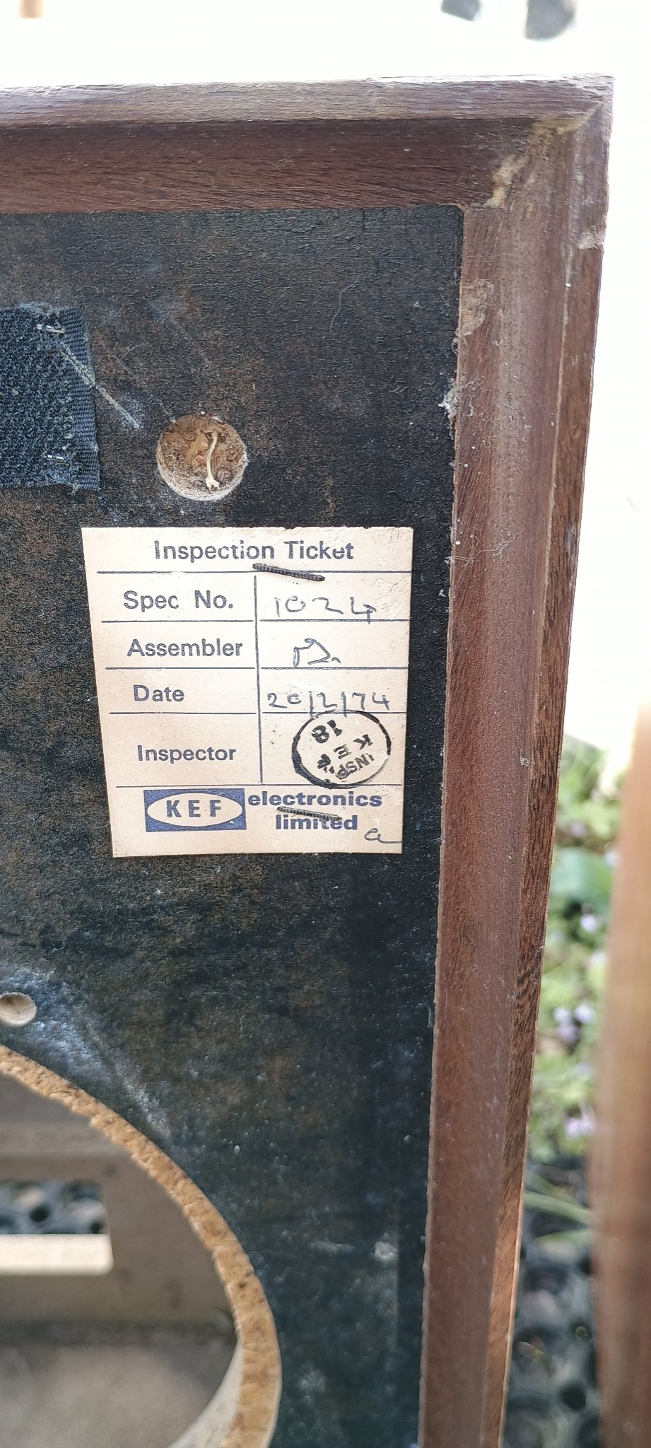

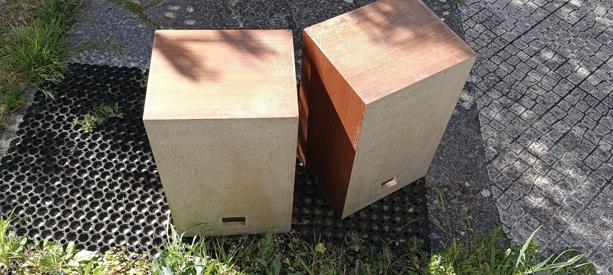

I asked AI. If there's something better please comment below. TIA
Question: Can you recommend good quality brands of wood polish mentioned in the list below for vintage KEF speakers from 1974?

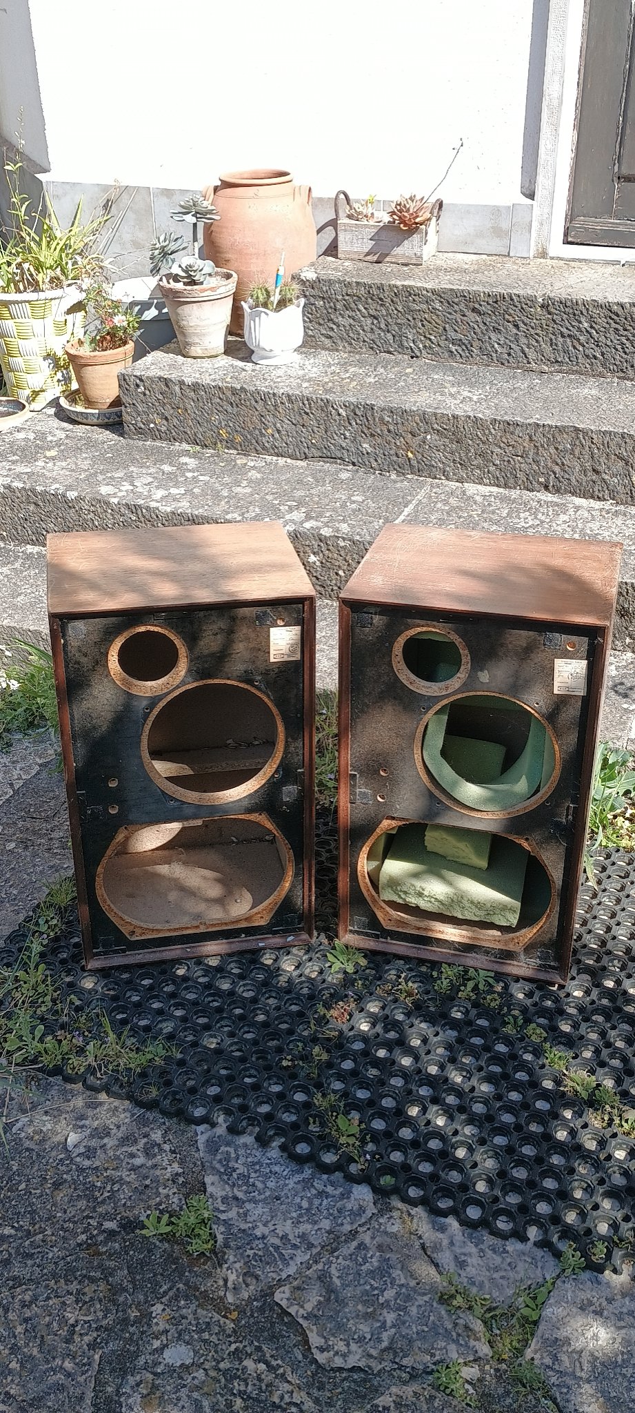

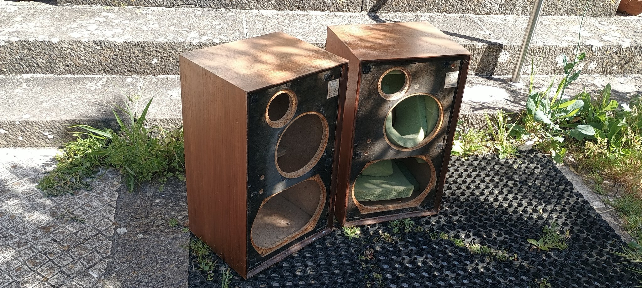

AI? What a load of malarkey!
Your speaker is apparently a KEF Cadenza (1970-1976) which sported a lovely teak veneer.
I find that a light sanding to remove any lacquer, and some buffing up using applications of teak or tung oil, works well in all but the most abused cases.
The trick is to build up the finish with multiple coats applied with a cloth after each successive coat has dried. The result is a finish that has a slight sheen.

AI has no taste…
A light sand, fill in deeper scratches with wax sticks and then oil.
Enough coats and it ends up with a chatoyant, lustrous satin finish which no varnish can approach.

New word for me, too! From bare wood, I apply three coats of polyurethane varnish with a roller eadch followed by a gentle rub with 600 grade abrasive paper, but on the final coat gently rubbed with 000 grade wire wool. A bit of ordinary furniture polish and it looks perfect. Perhaps not chatoyant, but pretty damn good, and certainly as good as most commercial finishes. And it's resistant to tea, coffee, beer, and whisky. I've done 40m of book shelves that way.

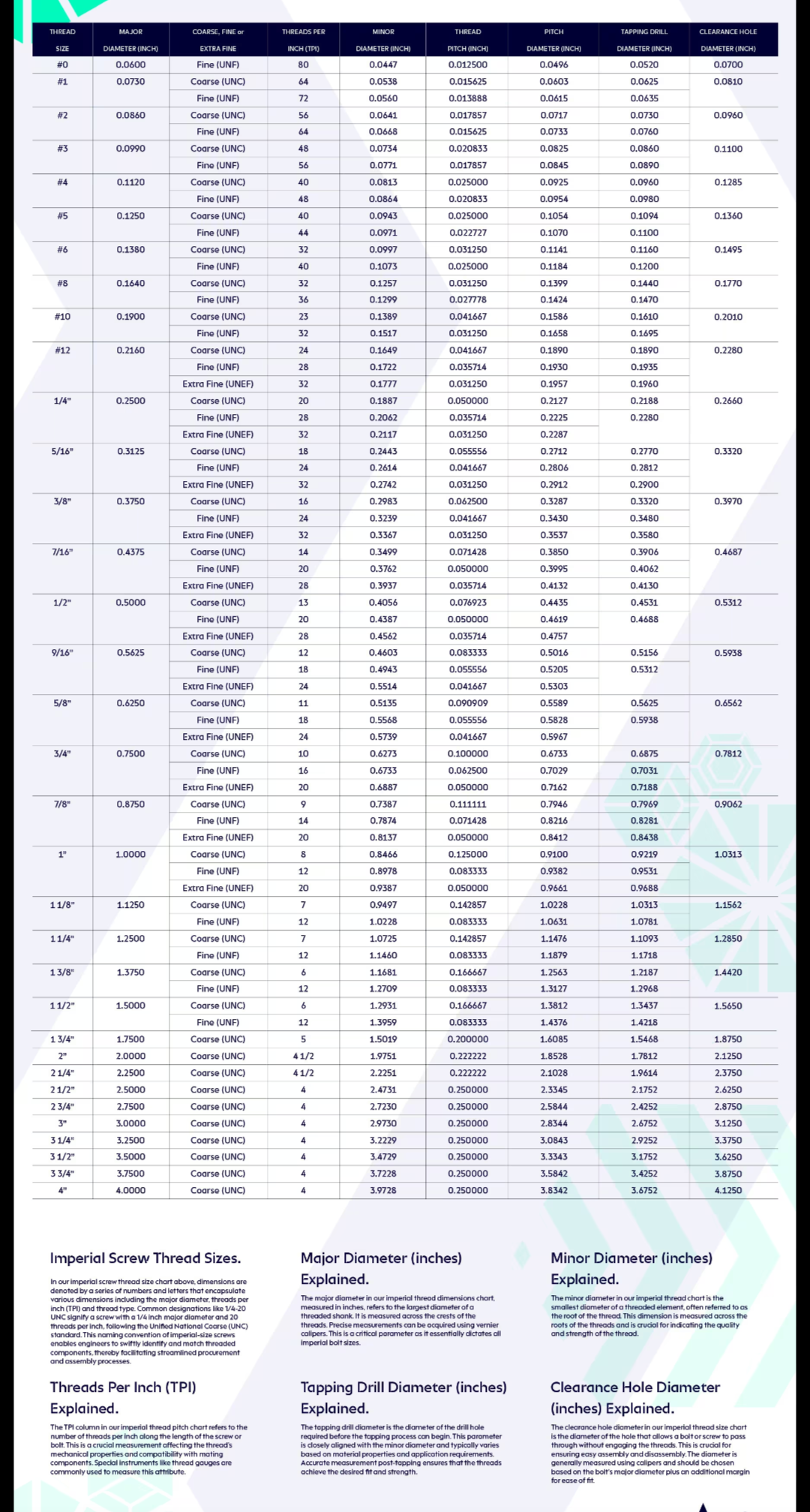

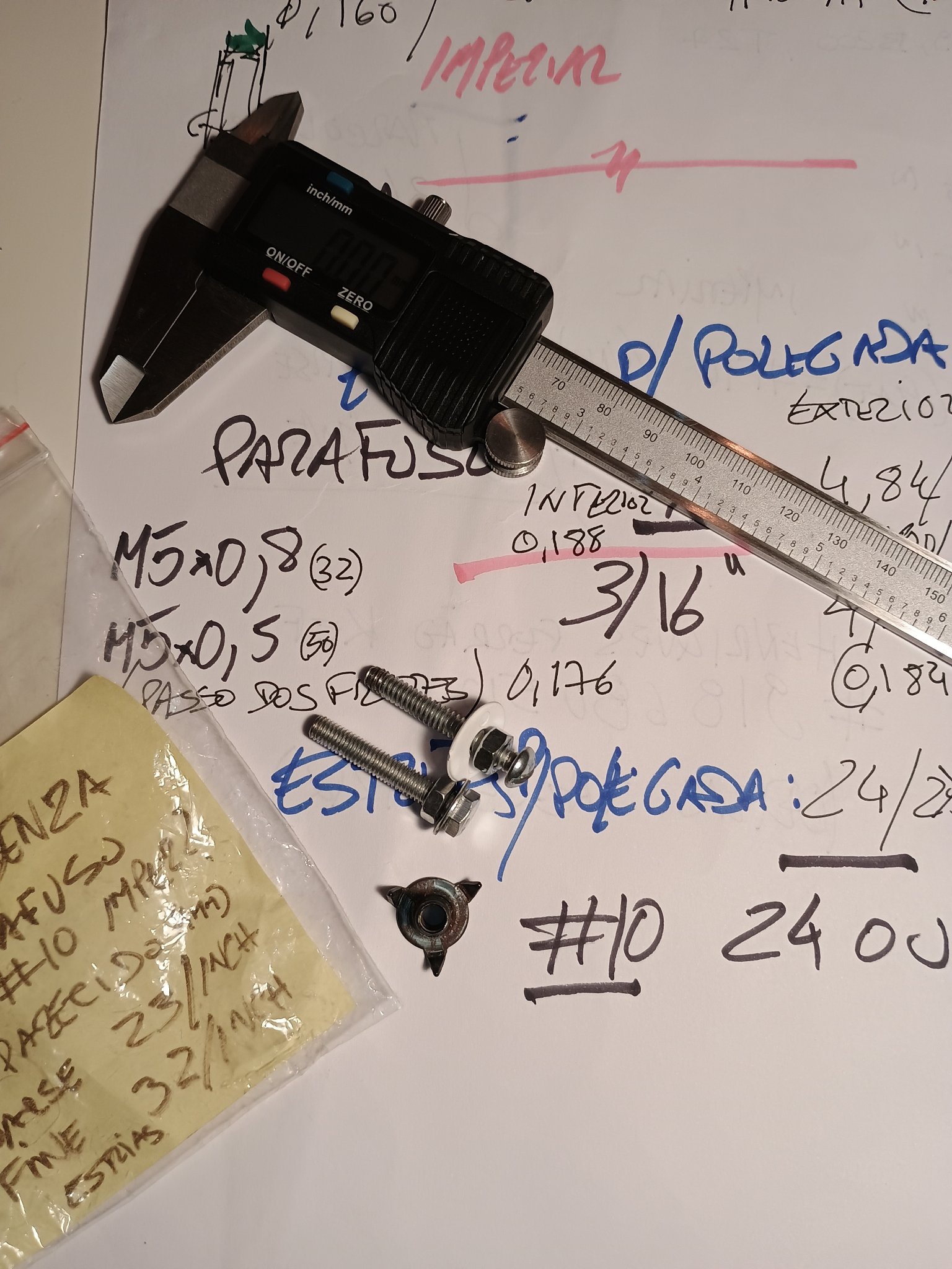

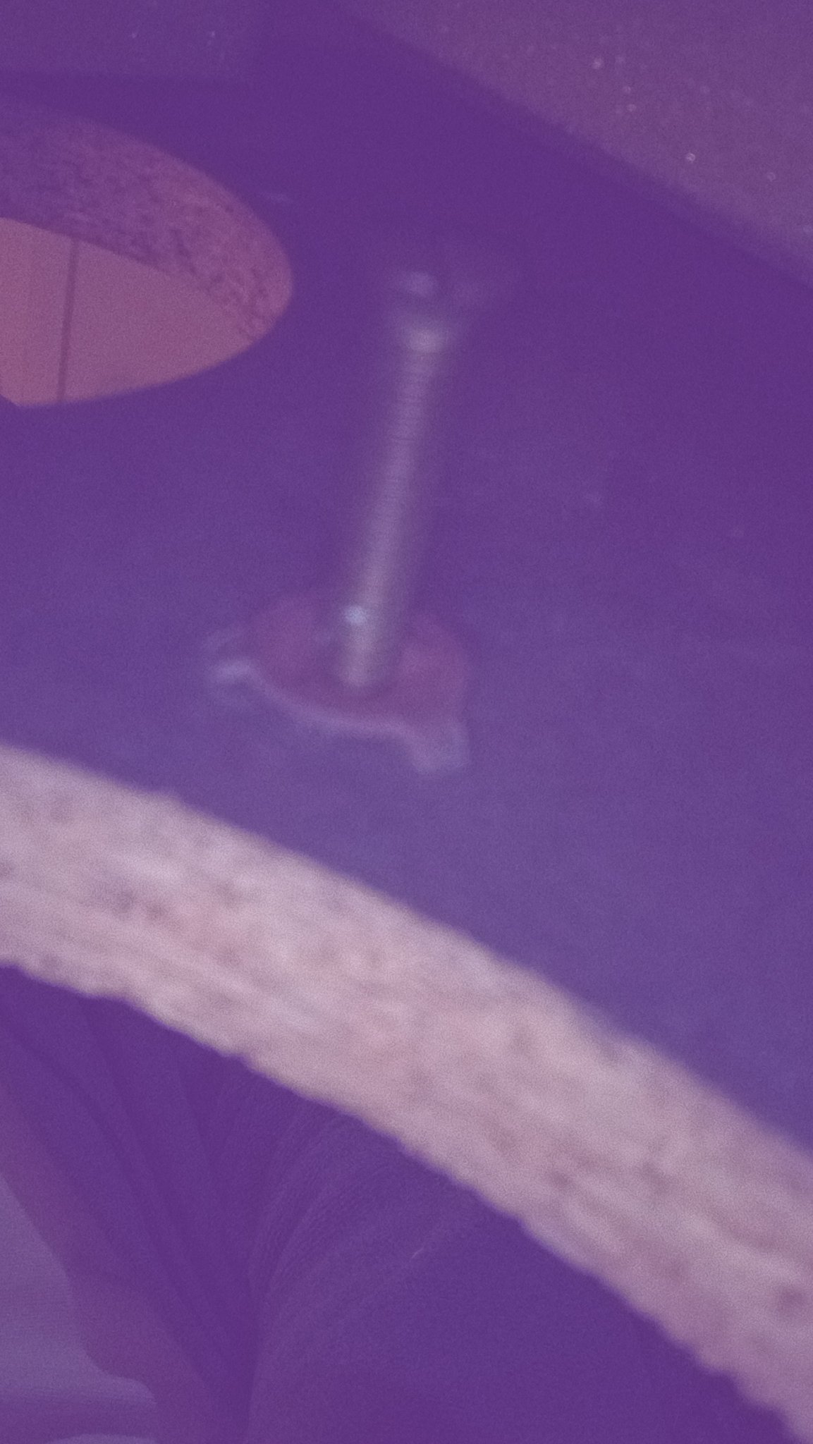

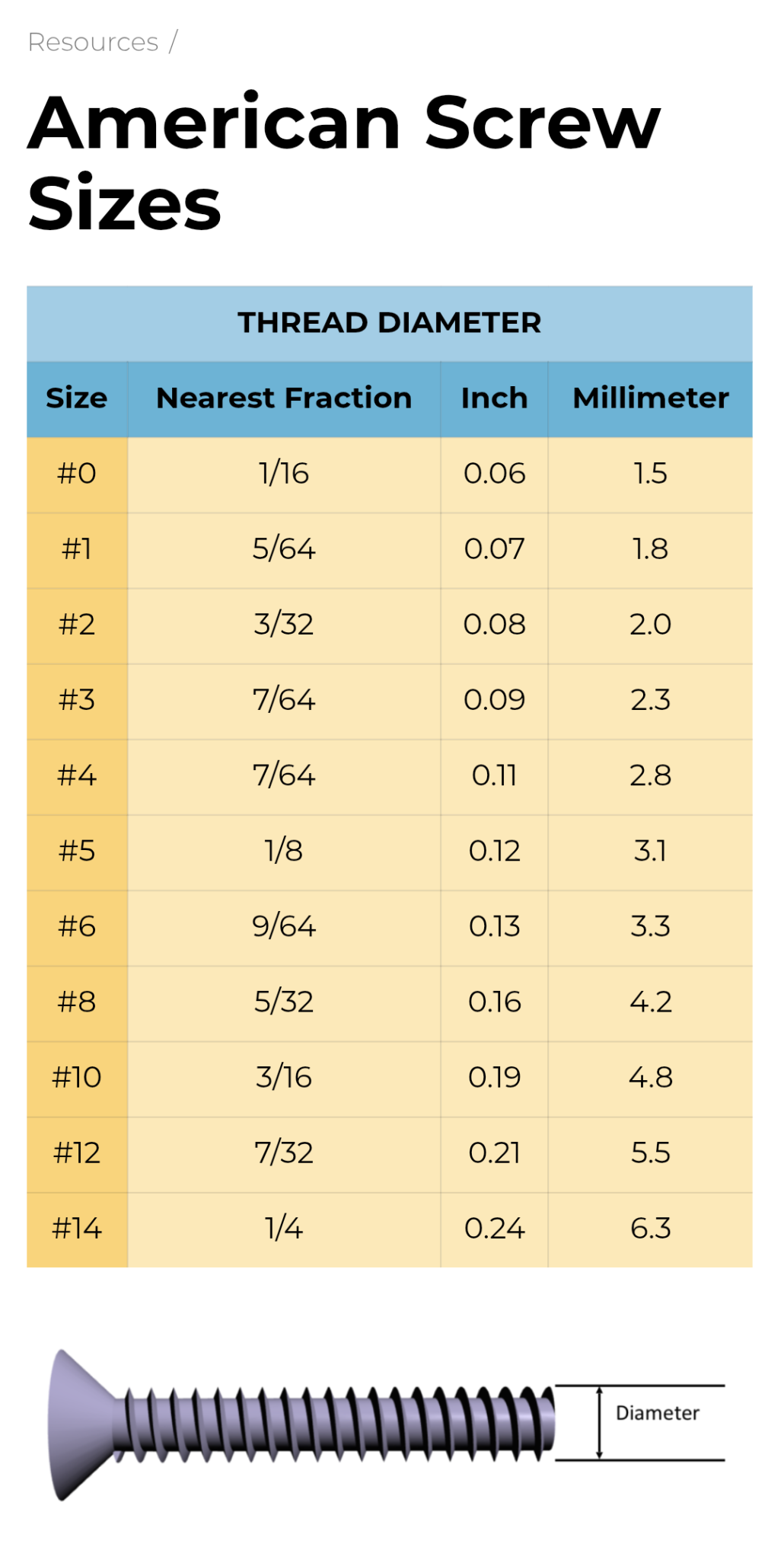

Now, I have a problem with the right bolts (UK)🔩🇬🇧
• Metric
M5x0.8 (32) - No
M5x0.5 (50) - ?
• Imperial
#10 3/16 (23) Coarse - No
#10 3/16 (32) Fine - ?
• Metric
M5x0.8 (32) - No
M5x0.5 (50) - ?
• Imperial

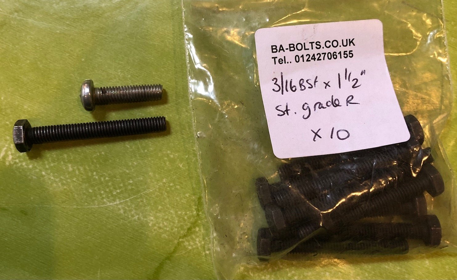

KEF from that era would have used 2BA (British Association). BA fasteners are still commonly used by model engineers.
I offered the following information regarding suitable screws for affixing a B139 in a KEF Concerto in another thread, and it turned out to be correct.
Use a 3/16" (0.188") diameter BSF (BSF = British Standard Fine) screw which has 32 threads/inch.
You could (as EC8010 says) also use a 2BA screw (BA = British Association) which has a diameter of 0.185" and 31.36 threads/inch.
The two screw types are said to be interchangeable.
The attachment shows the original bolt (top) and the replacement bolt.
