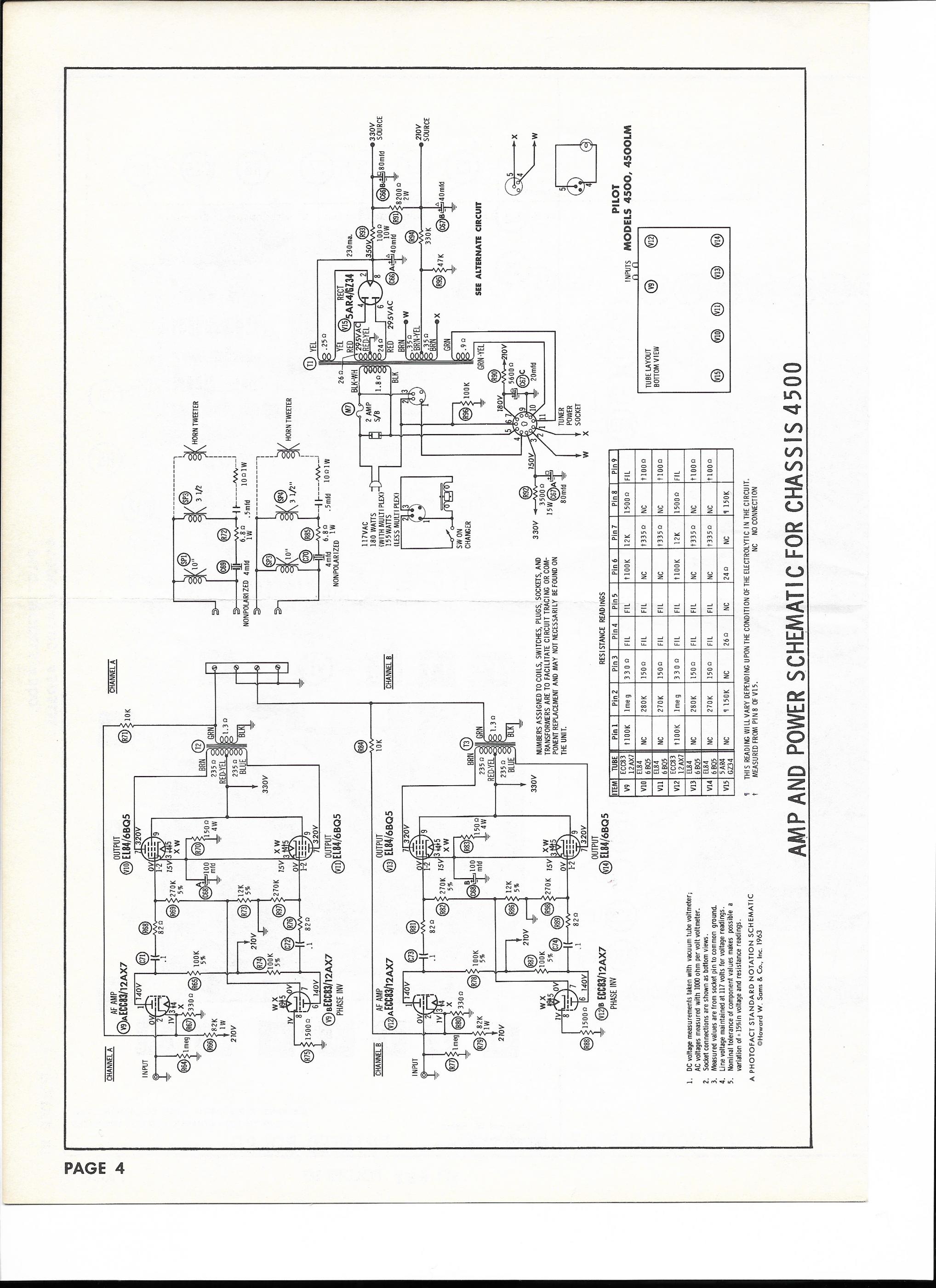

Hi all, reading old post and still confused. The schematic and parts list are attached. When I re-capped this in 2011, I put NP orange dips in place of C71, C72, C73 & C74 which show as polarized. (Amp has not been running except a couple of times to test.) I am having difficulty locating anything close to 0.1 mF polarized, 400V . The search bars on most suppliers sites are pretty useless, but it looks like the only polarized caps are electrolytic and they just don't come that small. There are some Aerovox .1 uf @ 400 v capacitors on Ebay. They are 50s/60s parts. would they work? I' dubious about them.

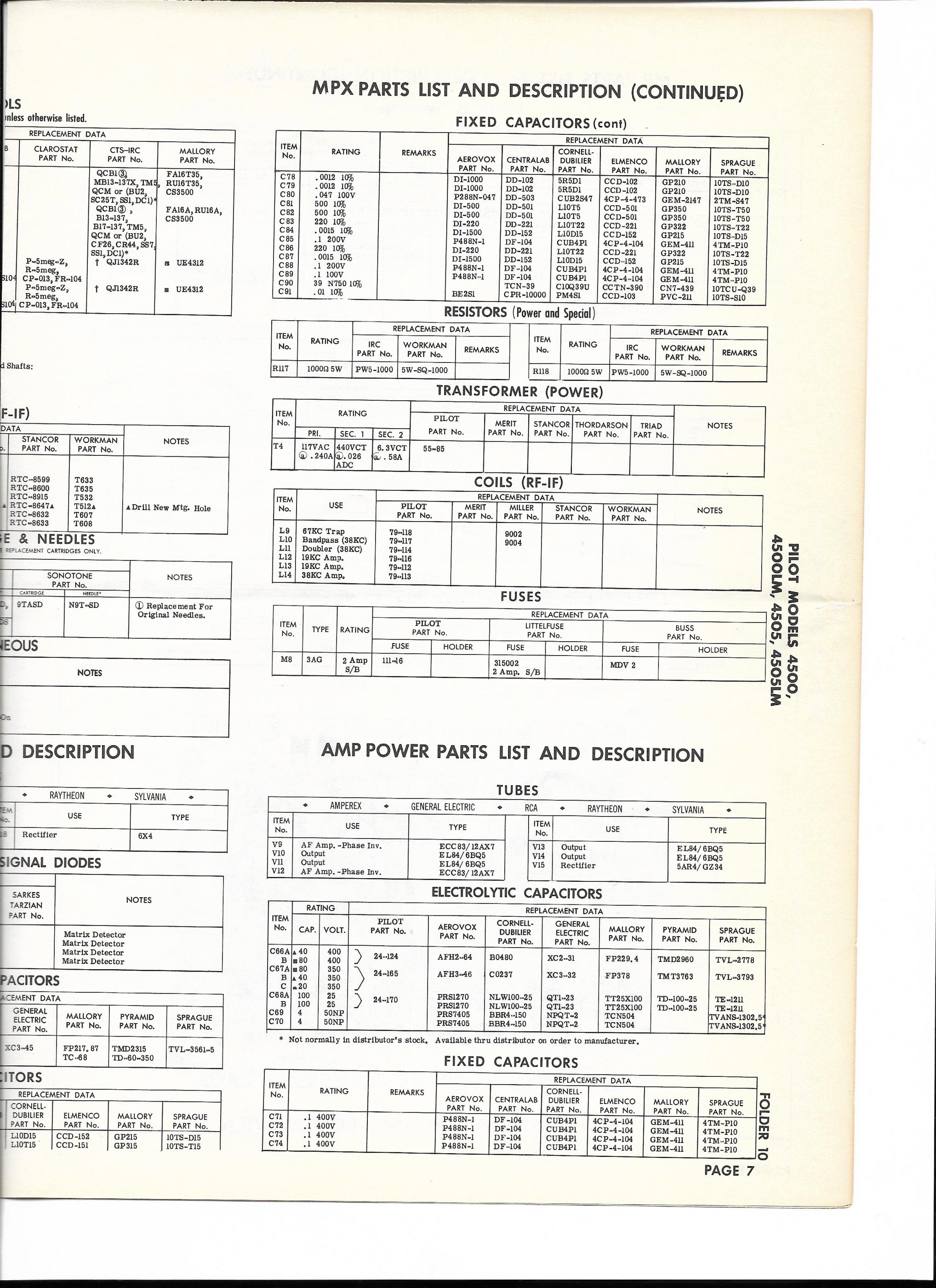

The parts list specifies several brands/types of capacitors that can be used for C71 to C74. I googled on Cornell-Dubilier CUB4P1 with this result (see page 426): https://www.technicalaudio.com/pdf/Electronics_Catalog_Extracts/Cornell_Dubilier_capacitors_1960_REM_24.pdf
The coupling caps for output tubes were never electrolytics ... and are listed and drowned in the schematic as fixed caps ( non polarized ) 0.1uF/400V a very common value .
So it is just a little misunderstanding .
