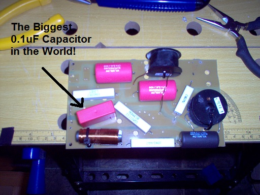

All I can say is that I've BEEN THERE with HUGE and OVERSPECIFIED capacitors! 😀
The below example is a huge 0.1uF 1200V jobbie that I somehow ended up with. Can't fault it of course, but probably overkill...😱
No idea about polarity, of course. 😕
Have you seen a Russian FT3 .1uf? ...its the big silver one 🙂
