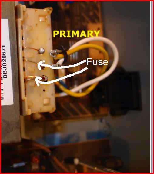

Indeed could be the thermal fuse. There's 230V across the points, but no continuity across them.
I have no idea how to open the transformer to see/look for this thermal fuse... 😕
How does it look like? And what's the function of it? Sometimes we have AC reaching 250V...
It will be buried in the windings (usually non replaceable). You should get a low ohms continuity between L and N terminals. You might "see" the fuse or deduce its location from any extra wires going into the transformer from the existing pins.
If its failed it could be anything from no fault other than the fuse to a short (such as a rectifier or outputs)
This looks like the fuse. It should read zero ohms between these points

Pictures below showing primary and secondary and from top:
There aren't 3 different outputs. It's just a centre tapped transformer the same as the Rotel was. While the service manual doesnt state the secondary voltages, from looking at the power supply capacitors and the voltage rails mentioned on the power amp side, it looks like 25-0-25VAC to me. It'd certainly get the amp working using those voltages.
My guess on why this has failed would be the same as that Rotel - your mains should be 230V but it is actually more like 250V. The extra power could well be responsible for making the transformer overheat and blow the thermal fuse. If you can get transformers rated for 240V primary, it may be better.

The only direct fix for the transformer would be to bypass it's thermal fuse. I would not recommend this. If the transformer has gotten hot enough to blow the fuse, the primary winding could be damaged.
