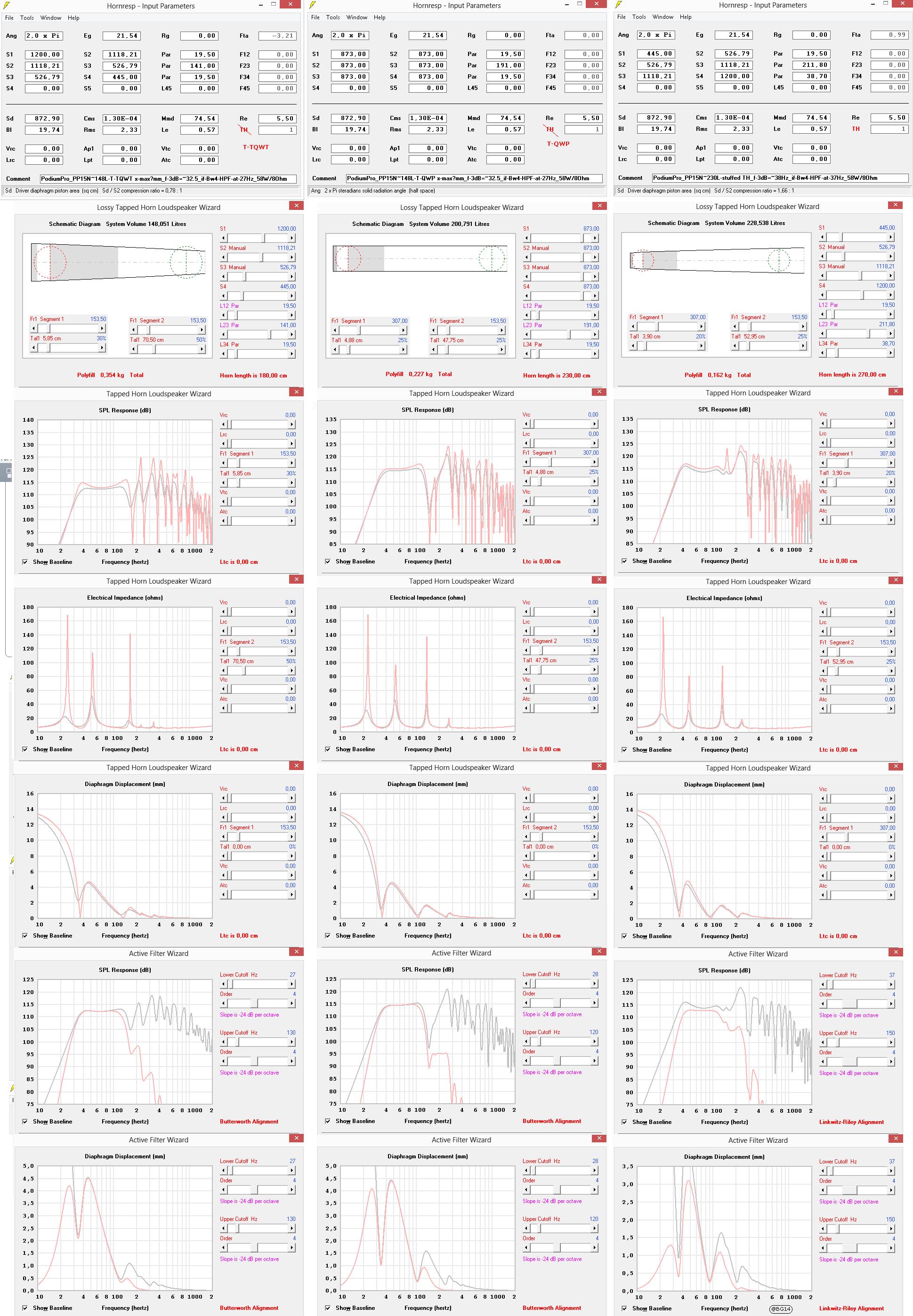

The neodymium woofers. PP10N, PP12N, and PP15N. What about the TS specs makes you say that? I assumed subwoofing capability was primarily an Fs and Vd function, yes?

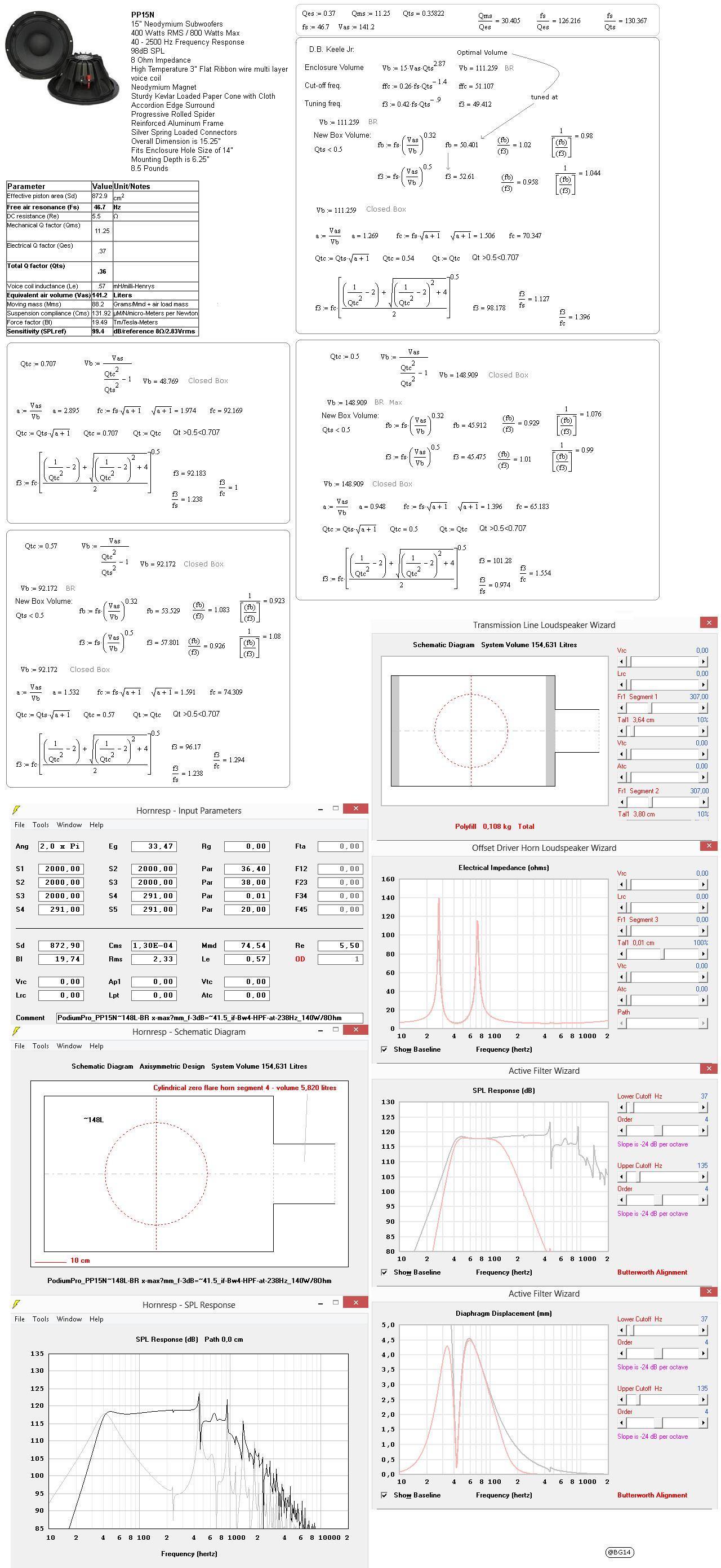

Now i know which ones you're considering, it helps. I'd never heard of them before, so it's always nice to discover other vendors. Most of their drivers Qts are too high, & also their fs for lowish bass duties. Regarding fs, it depends on what you call a bass box. They don't "appear" to have a vented cooling hole on their backs ? But due to their limited power, that "might" not be an issue.
The PP15N would be ok as a bass box, from about 40Hz - 45Hz
PP103 & PP123 are also contenders.
Try & sim them post your results.

Well the Qts of the PP15N is lower than the 3015LF and its Fs is very close.
As for the Kappa Pro, it's too heavy. I'm exclusively looking for neodymium drivers. I even plan to use a fiberglass-foam sandwich enclosure because weight is a huge factor for me. I'm just looking for sub-$200ish drivers that can handle tapped horns or sub-$100ish drivers that I can put two into a BR box.
