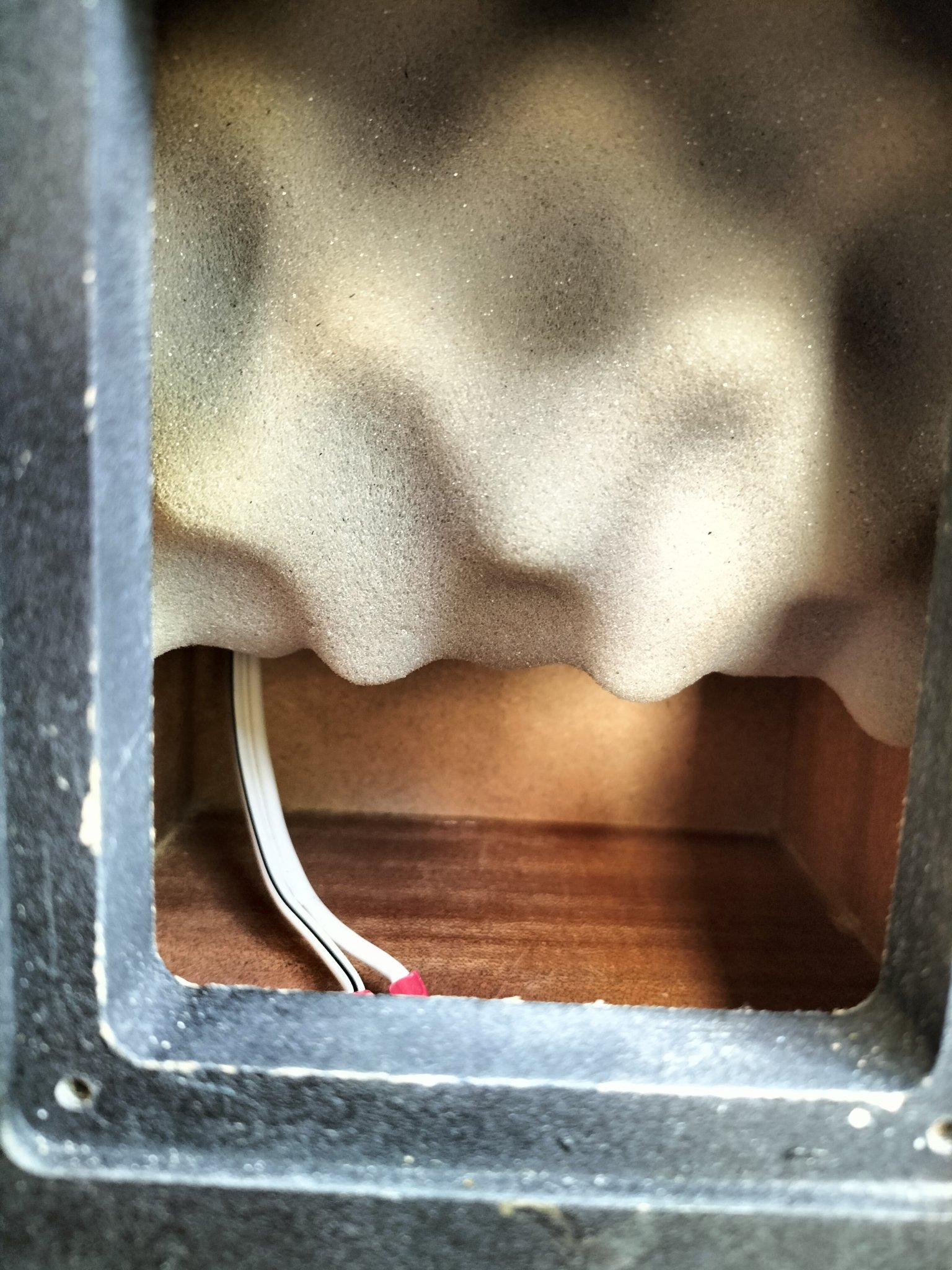

The port is situated at the back of the speaker and is damped with a piece of foam about 3-4 cm thick, an unusual construction for a TL.

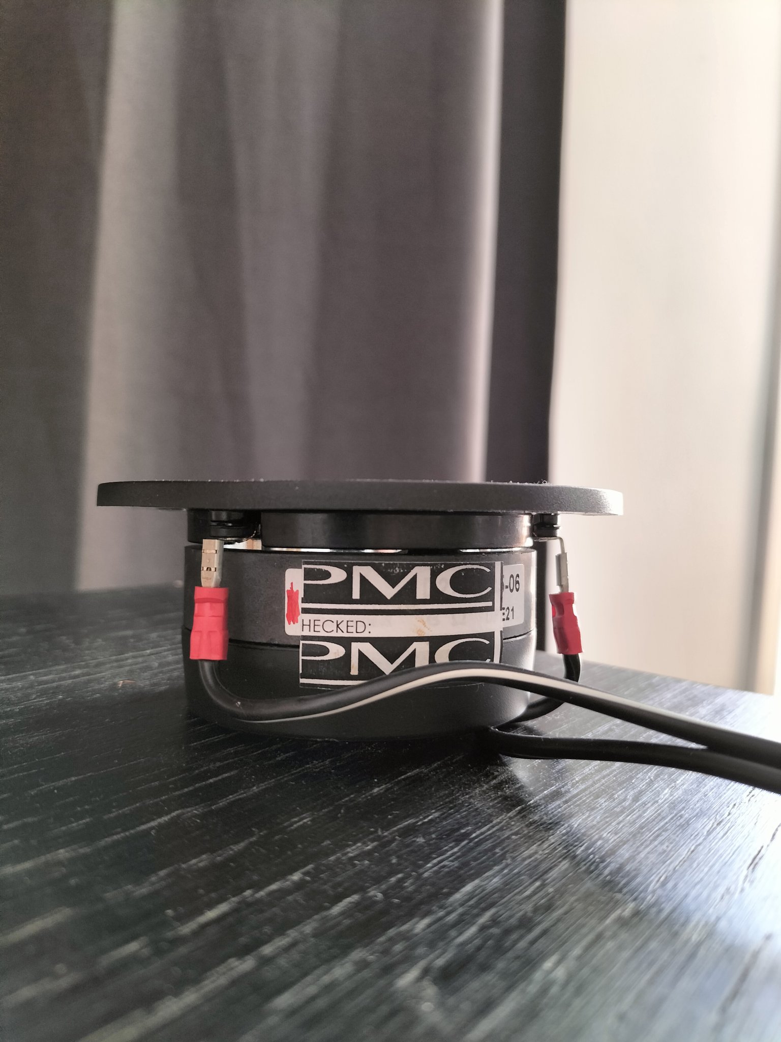

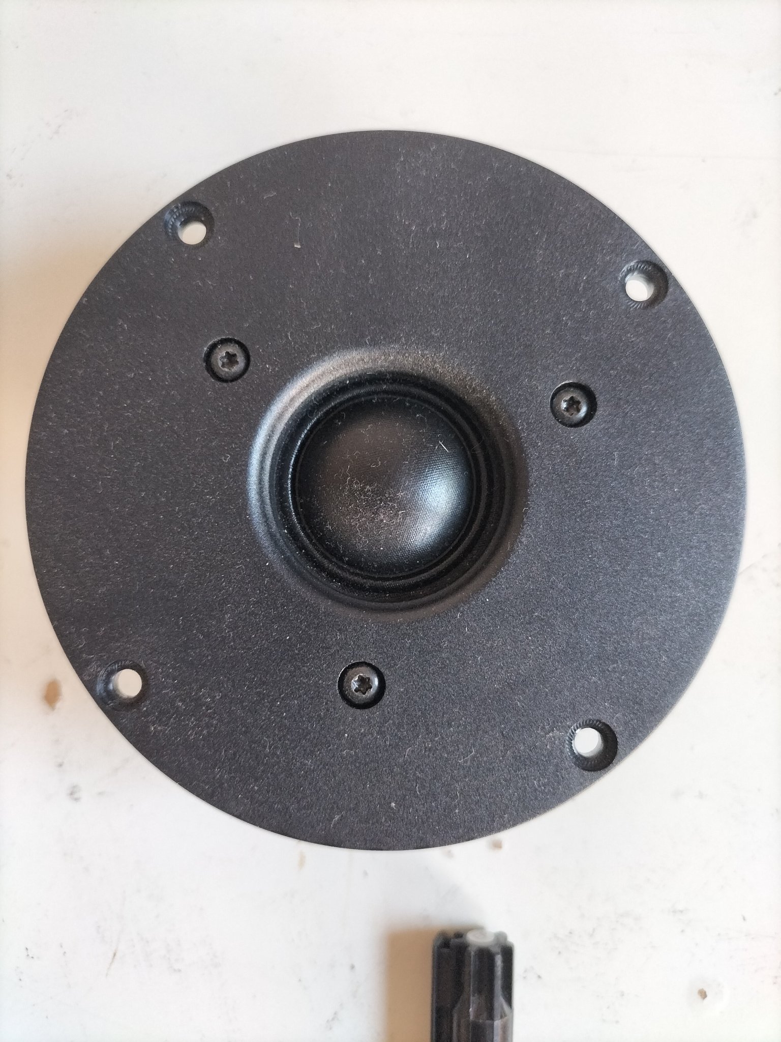

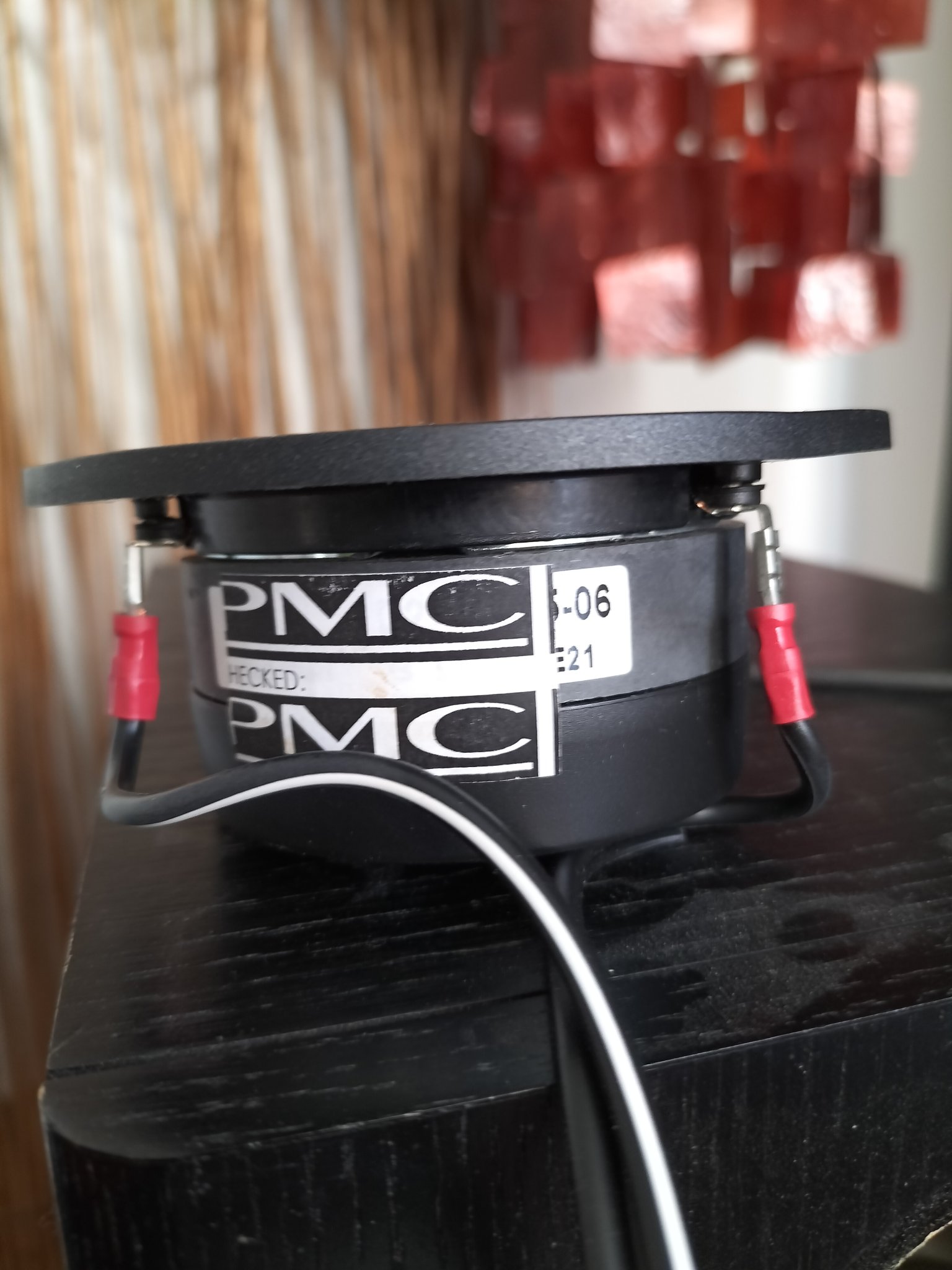

Vifa D27TG-35-06
The Vifa tweeter is still available for about €40,- in Europe.

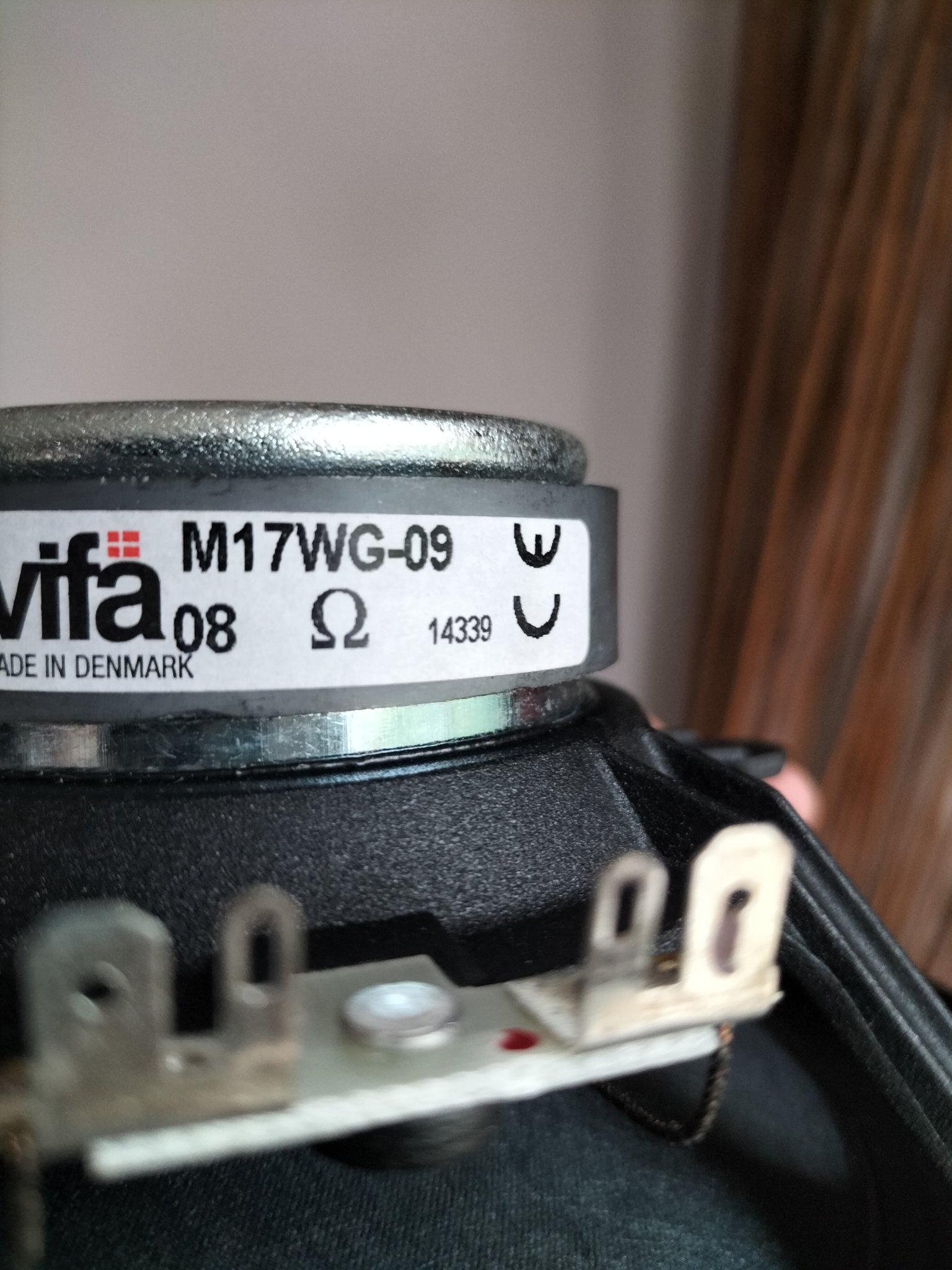

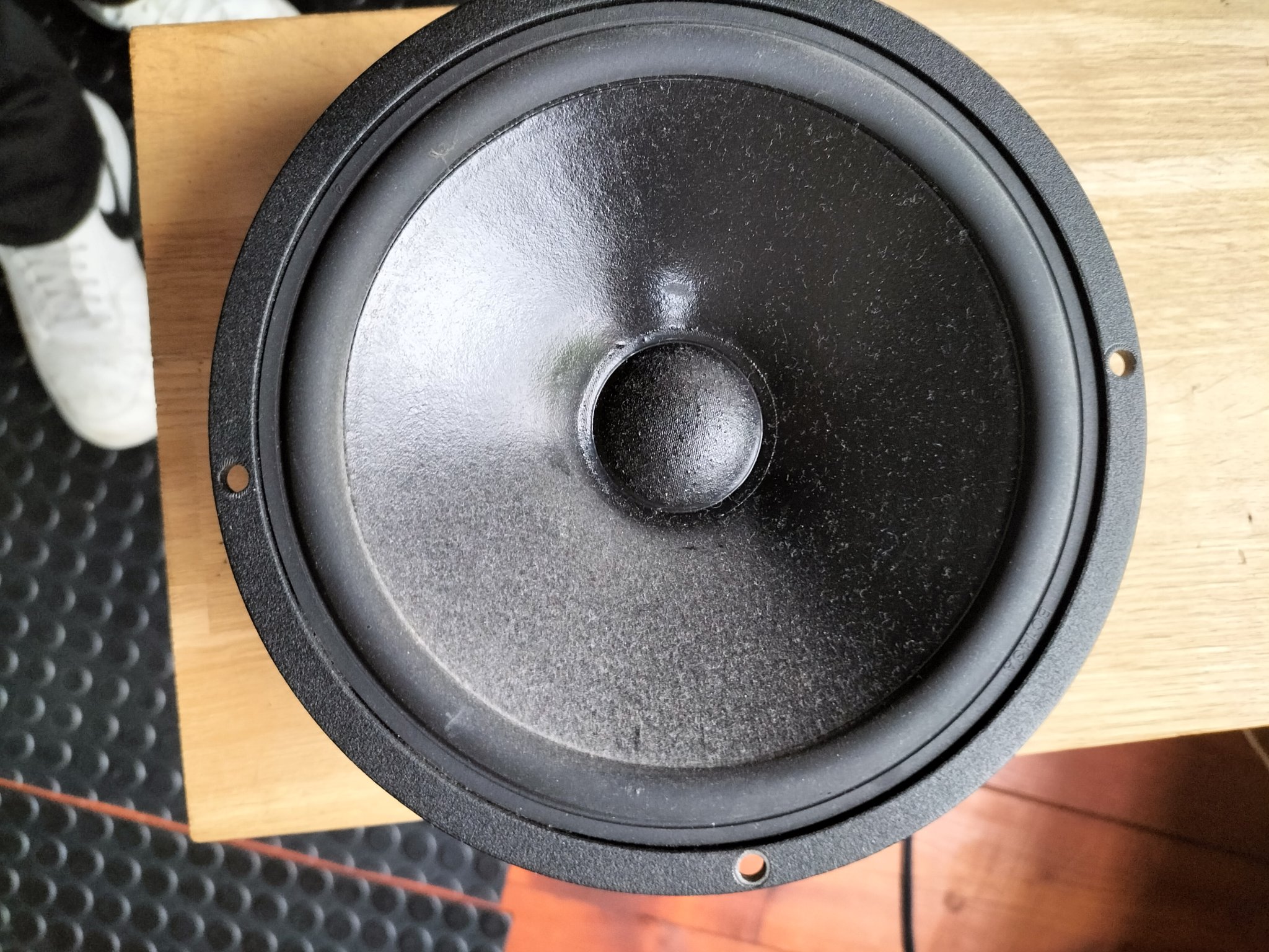

Vifa M17WG09-08 (Out of production, only available as NOS)
I do not know if the drivers used in the TB2 are stock Vifa drivers or custom / modified drivers specifically for PCM.

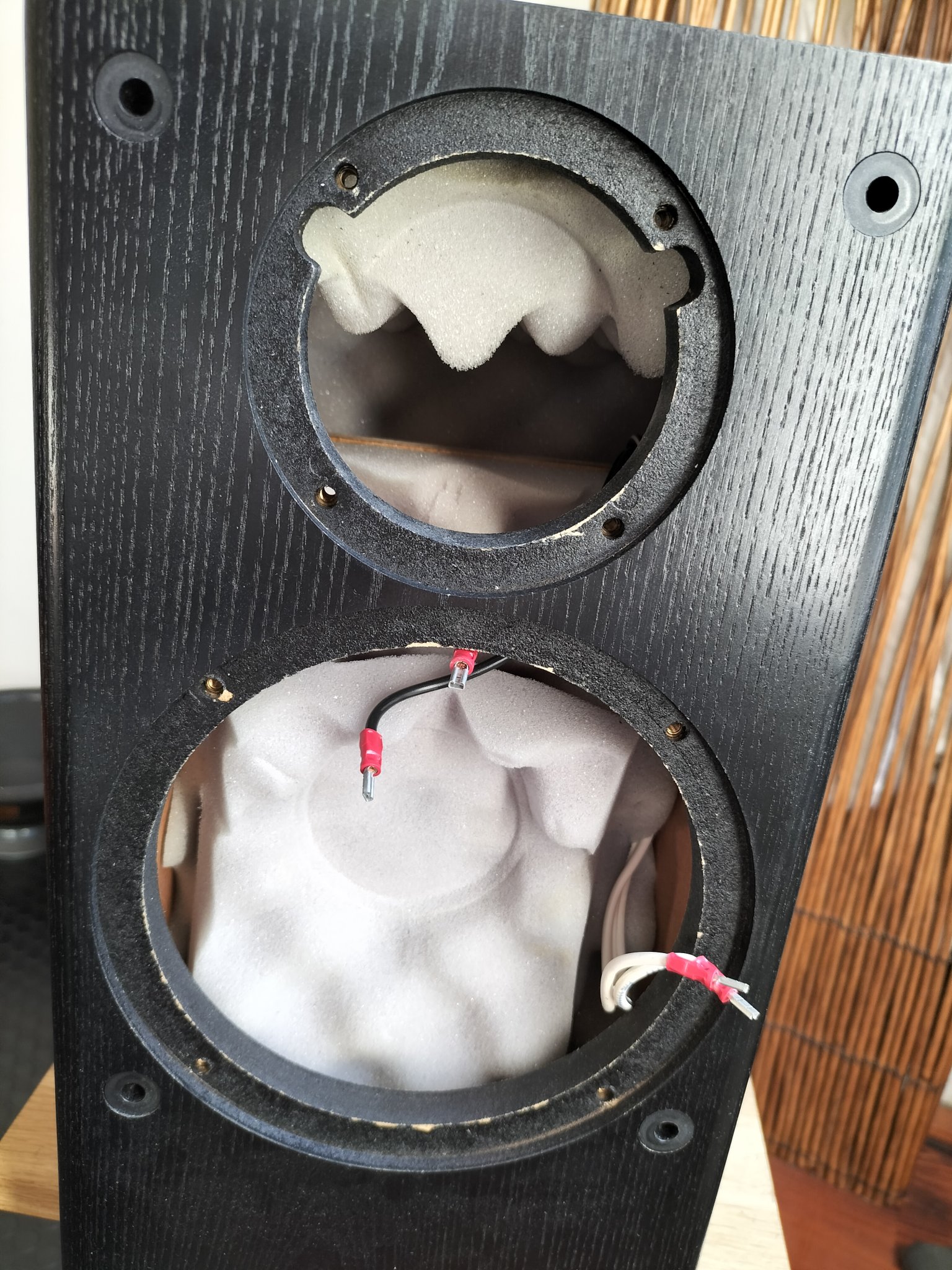

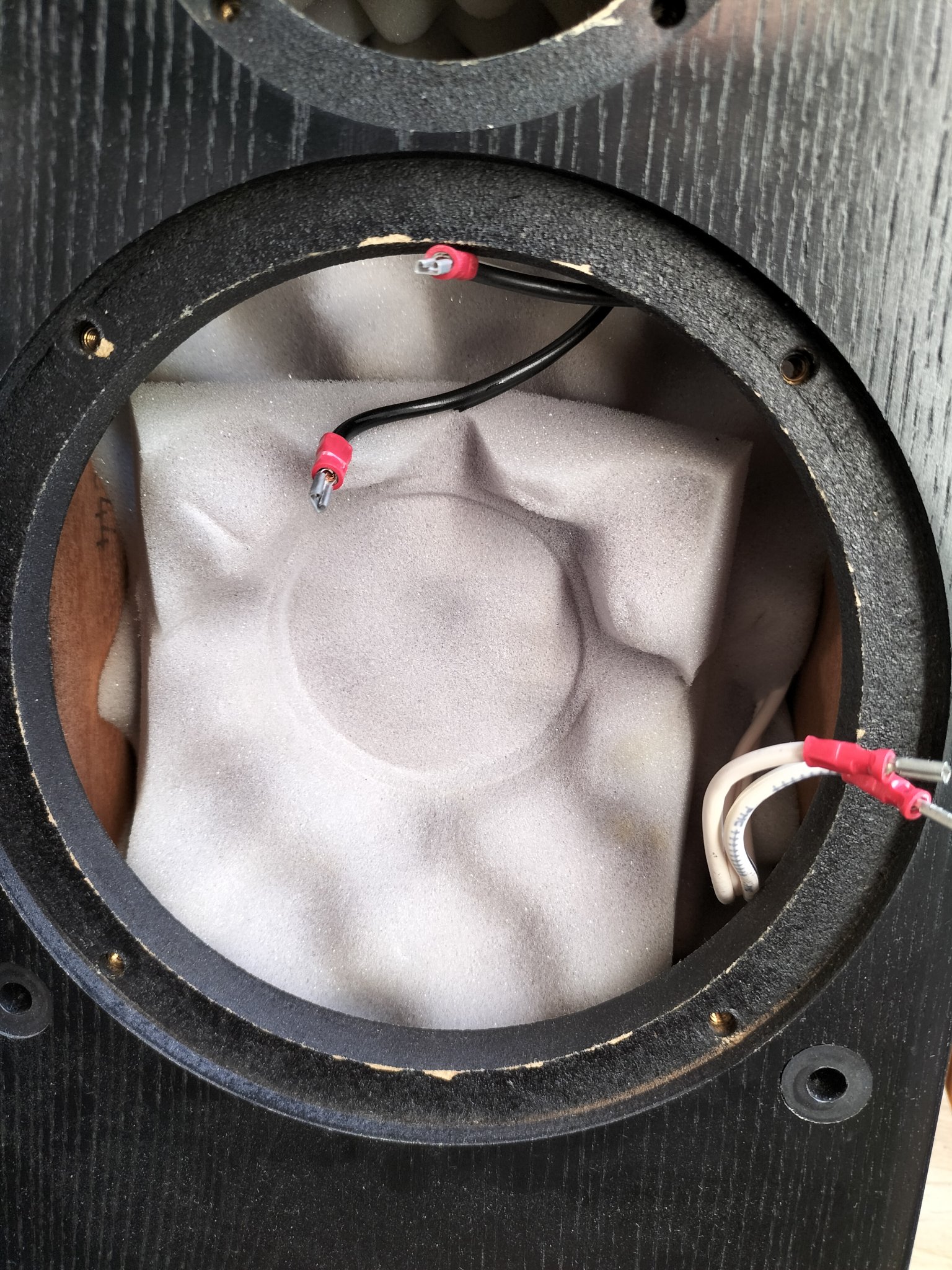

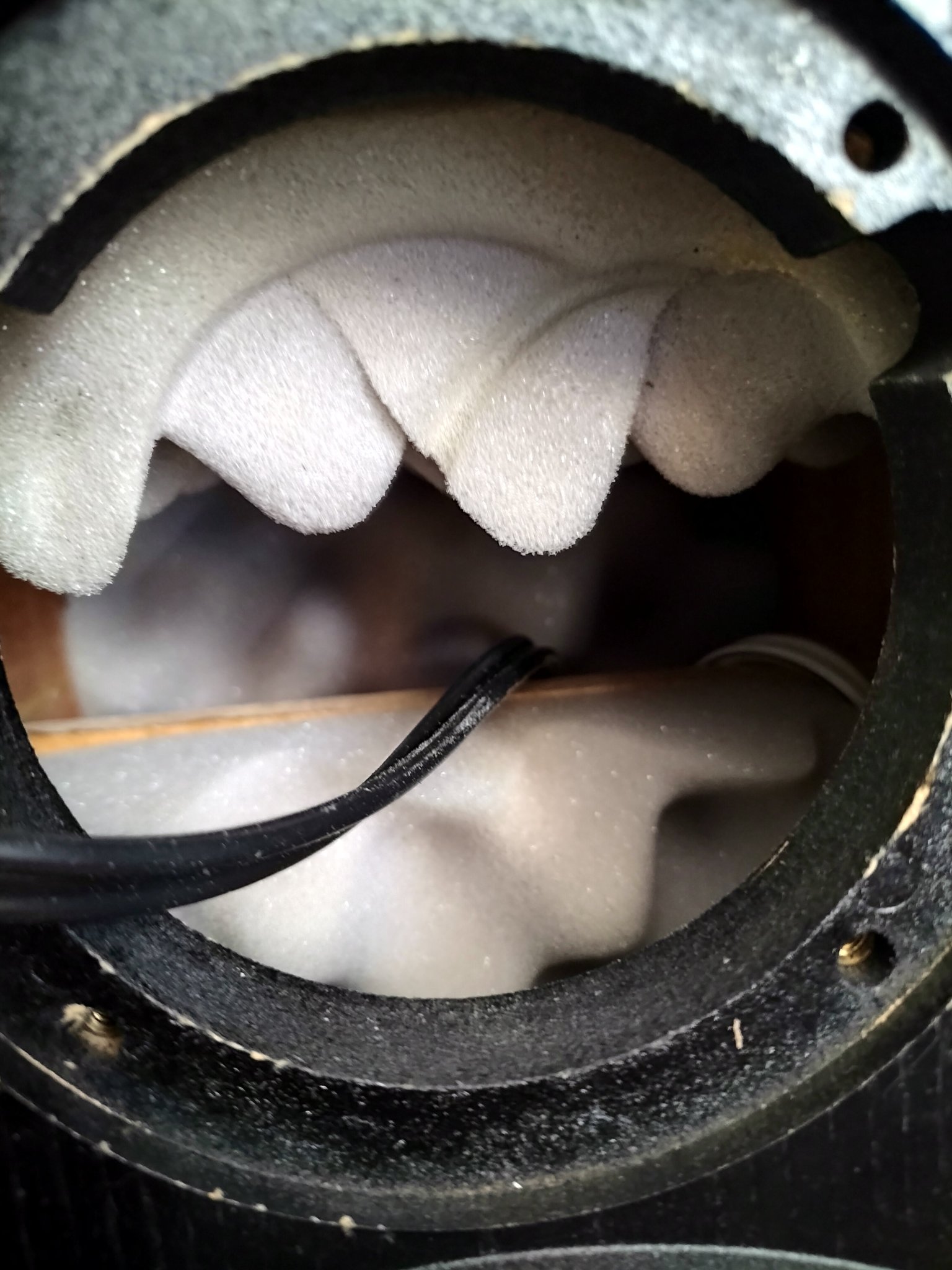

View with both drivers removed. (left) and through the tweeter mounting hole (mid). The top of the first divider is clearly visible here. The line is damped along its entire lenght with the white foam (thickness 50mm). Directly behind the woofer is an extra piece of 25mm thick foam that is actually compressed bij the driver magnet and covers the backside of the driver. This might have consequences for the driver Qt.

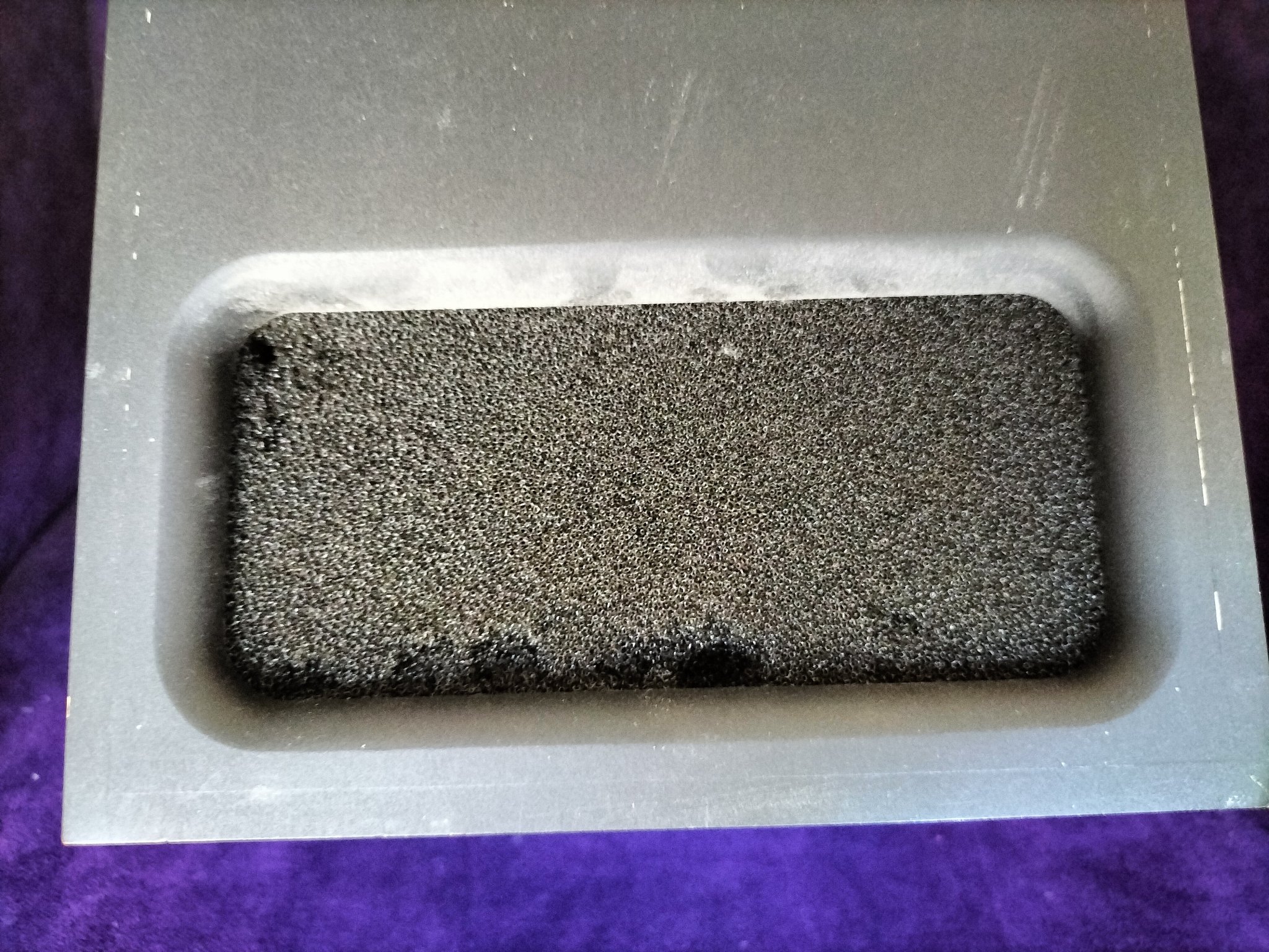

The view through the mounting hole of the connectors on the back of the speaker. Visible is the bottom of the second (and last) divider. The picture right shows the port at the back of the speaker and the foam plug in a bad state.

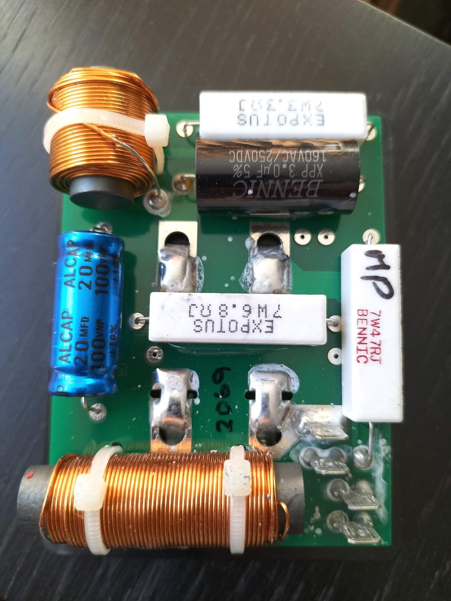

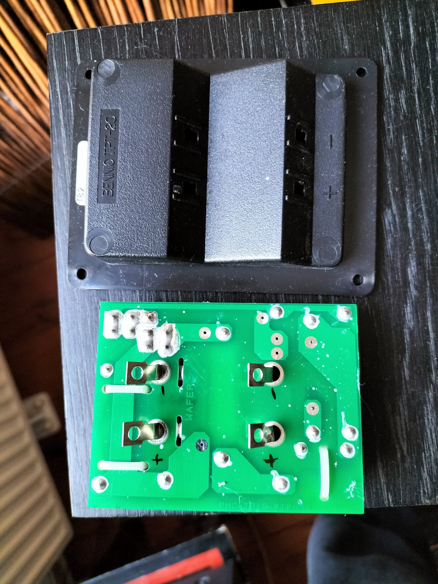

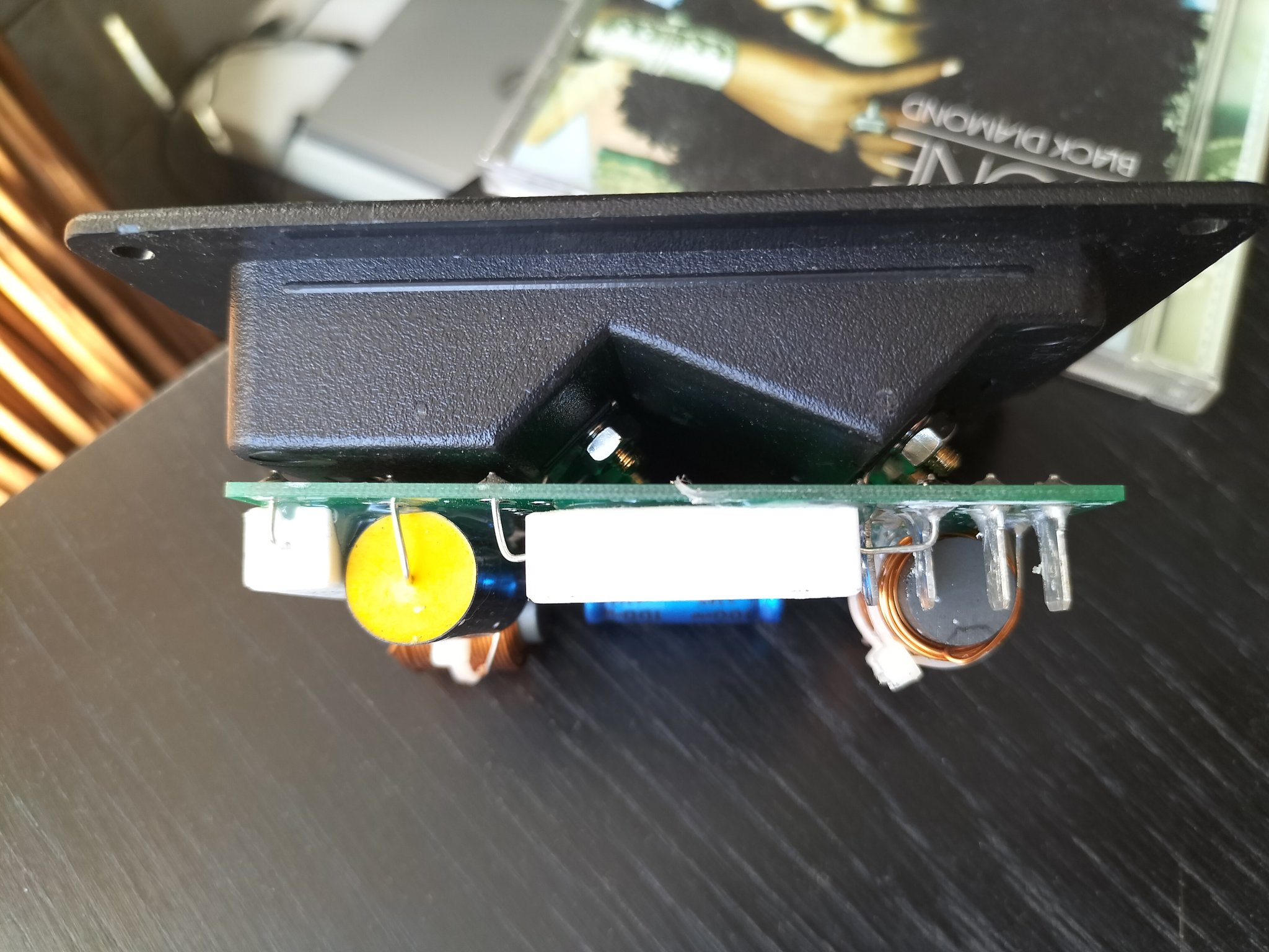

The crossover
The crossover is mounted at the back of the connector panel.

- The foam in the mouth of the line at the back of the TB2's deteriorates over the years. Mine are now basically reduced to dust and need to be replaced. The official replacement foam from PMC is hugely expensive, and I have been looking for an alternative.

- Crossover schematics for the various versions.

Model | Tweeter part nr. | Tweeter model | Woofer part nr. | Woofer model | Remarks |
TB1 | 12415 | Vifa D25AG-05-06 | 12418 * | Precursor of the TB2 | |
TB2 | 12415 | Vifa D25AG-05-06 | 12418 * | ||
TB2+ | 12416 | Vifa D27TG-35-06 | 12418 | Vifa M17WG09-08 - german type designation 17WN125 | Peerless M17WG09-08 loudspeaker database Crossover freq. 3Khz. Different part nr.? |
TB2i | 13999 | Vifa D27TG-35-06 | 12418 | Crossover freq. 2Khz | |
TB2i Signature | 13999 | Vifa D27TG-35-06 | 12418 | Special edition, identical to the TB2i | |
TB2S | 12415 | Vifa D25AG-05-06 | 12418 * | Professional Monitor, 2001. Review SOS | |
TB2S-All | 12415 | Vifa D27TG-35-06 | 12418 | Professional Monitor, Active with passive Xover. Review SOS | |
TB2S-All 5.1 Surround System | 12415 | Vifa D27TG-35-06 | 12418 | Includes the TB2M Center model | |
TB2S+ | 12415 | 12418 | Professional Monitor |
Vifa D27TG-35-06
The crossover
