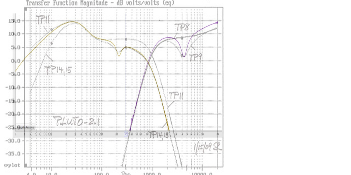

For the active filter/equalisation, I decided to implement the original ASP design in miniDSP platform using IIR techniques (no FIR available yet for this platform). First because the "let's see..." approach, but the integrated DAC and processing sounds very good! The 4 DAC output stages are buffered in my DIY pre-amplifier using buffer stages of an older Pass SE class A design. There was enough space left in the casing to integrate the miniDSP/miniDIGI within this casing. 4-Channel volume control takes place in the 56 bit digital domain before 24 bit DAC's. Should be fine theoretically, but not to loose too much bits when playing at low volumes (18 dB attentuation loses 3 bits), I choose the gain for 0 dB attenuation as "a little too loud".
Unfortunately I have not heared Pluto's with the original ASP, but for now I can hardly imagine that all these opamps can do a better job then this big calculator...
Here's some pictures:
Simulated the 2.1 ASP to obtain frequency response in ASCII format
Digital implementation of ASP, LP section required 2 PEQ and 2 biquads
Digital implementation of ASP, HP section required 2 PEQ and 1 biquad. The delay circuit was implemented as a pure delay.
Tweaking frequency response. Green and purple line are target responses, blue line is actual HP achieved

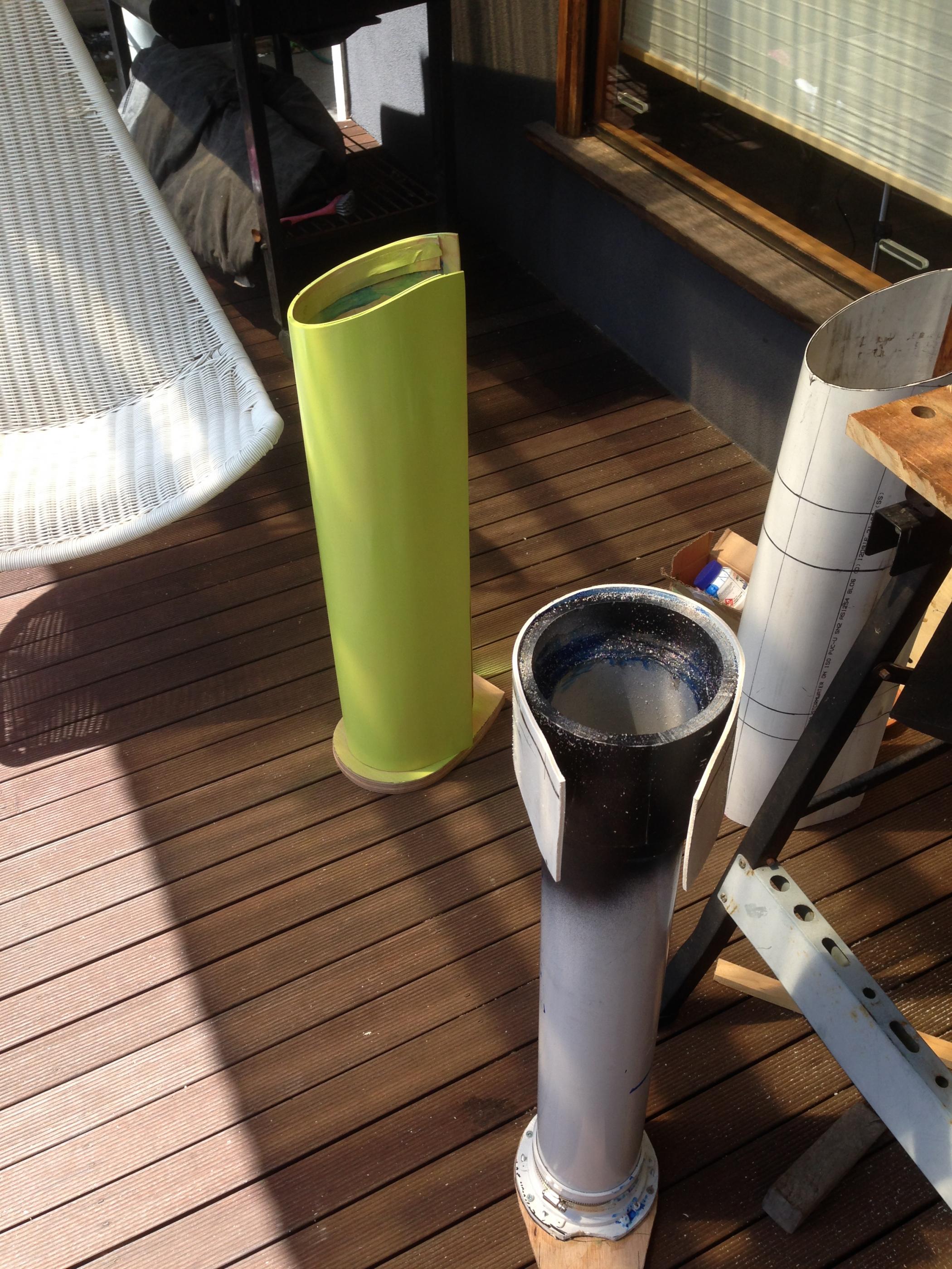

Mechanical
Started as below:
Plywood bars to be epoxied on PVC pipe-coupler
Quick-and-dirty turning lathe to get decent fairing
Unfortunately when finished, I put one of the woofers in and noticed the quite small gap between magnet and PVC coupler. I had recessed the woofer too much! With about 1 cm space around magnet I was afraid for compression effects.
As a second trail, I ordered 2 "Orchidea" flowerpots with quite good fit, but they appeared to be made eof polypropylene, not suitable for glueing, reinforcing etc! Damn! I used the flowerport as mold to laminate with GRP about 4 layers of laminate from the inside. The result was a very tight "Copy1_of_flowerpot":

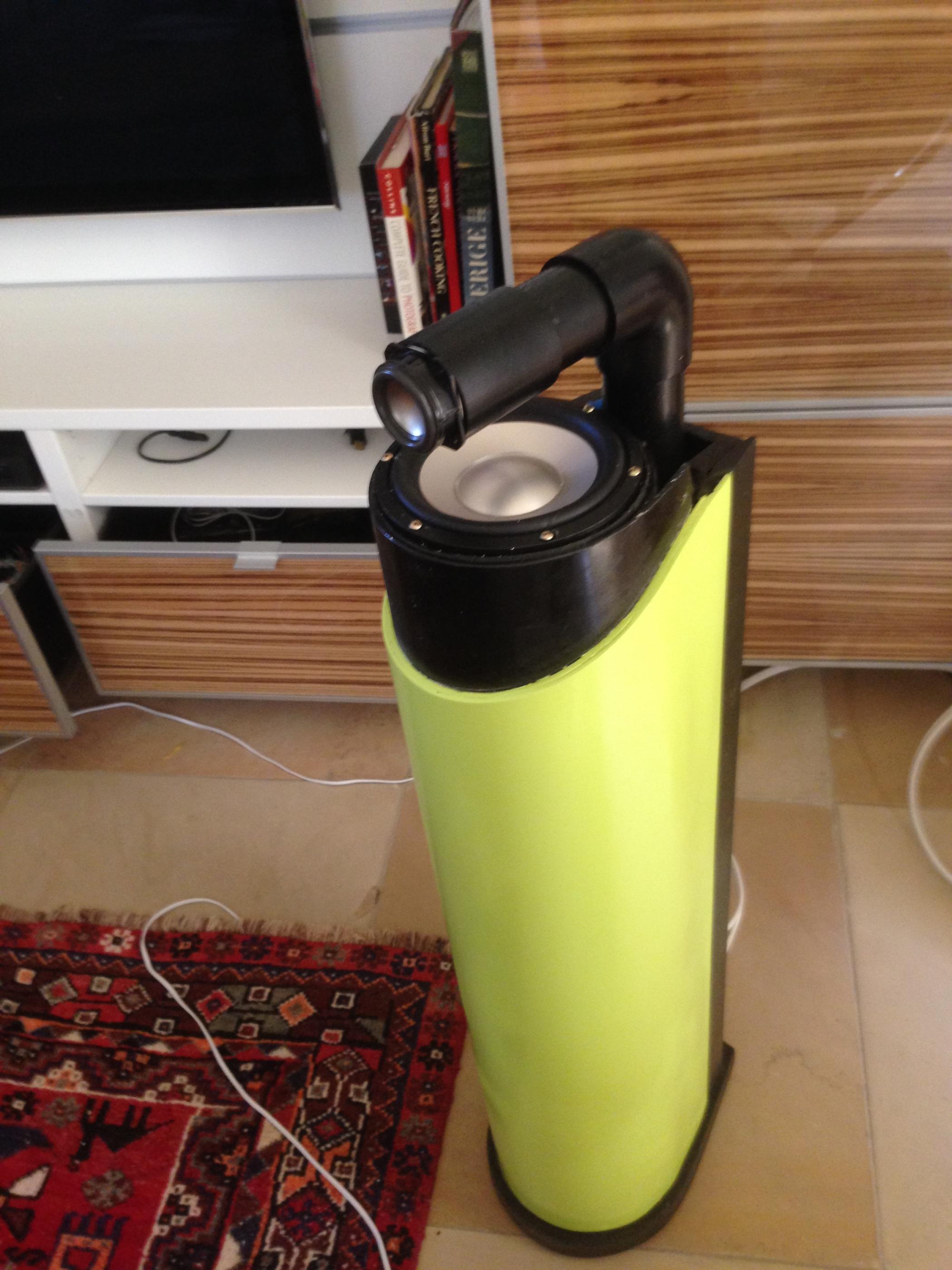

First listening!
Faired and painted
Finished!
Big thankx to you enthousiasts for challenging me and off course to mr. Linkwitz himself for providing understanding, explaining and proving how perception works!
A question finally:
On some female voices, at higher volumes I notice a slight coloration in the upper midrange. Not disturbing (at least for now), could this have to do with distortion of the Aura driver or maybe stuffing? Does anybody have experience with how much stuffing to use in the tweeter tube? Now is quite arbitrary because I found no clear guidelines, I would say I used a loose dot of 7 cm length some 2 cm behind the driver.

I could almost reproduce every part of the ASP mathematically (and directly type-in miniDSP) except for the LP notch and LShelf, as there is no buffer opamp in between in the ASP so the combined transfer function of those is not a simple linear addition! For that reason I had to use a little trail&error to measure and compare the DSP with (PC simulated) ASP. miniDSP is very easy and flexible in that respect, in an hour on-line tweaking I as within 0.5 dB. Your DSP is probably also...

Thanks, they do mix quite nice in the interior indeed. The 90 degrees bends ars high-pressure pvc bends. Sometimes also known as "entrance bows" used to allow entering cabling into protective pvc piping surrounding them. I simply glued them to the straight piping section using acrylateglue (superglue or "second-glue"). This is as strong as the pvc itself as long as the joint is completely flat.
Regards, Maarten
I've never used the Whisper in a long tube, but for automotive use I've found that it's useful to snip the bug screen and put a wad of polyfill right behind the diaphragm. That measureably helps with a ~2kHz resonance that could be the cause of the distortion you hear.

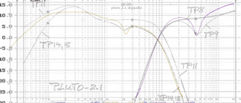

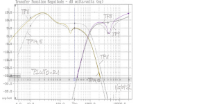

I see a problem with EQ all over. Have a look at attached plot: minidsp response based on your xml vs Linkwitz original drawing.

Hi Bernt,
No, amp is not built in. But I think it can be fitted in the back in place where tweeter tube is. As I understand tweeter tube doesn't need to be that long.
I realised that minidsp was clipping when I made first measurement. Here it is again, your xml compared to Linkwitz plots.
