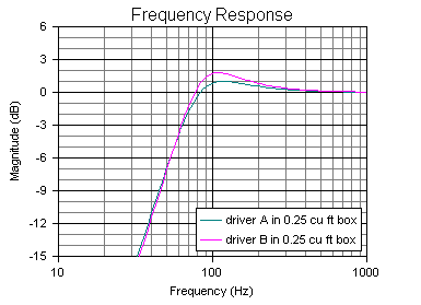

Qwestion wrong stated!
First of all, I apologize for not previously reported to thank you for your kind answers but I had personal problems with higher priority.
however, the question was raised wrong, I want to draw a graph of the relative frequency response of speakers in an arbitrary case like this one I attached here.
But, as I stated before, I do non recall correct formulas to calculate relative SPL for some particular frequencies (like 10Hz, 15hz, 30Hz, 100Hz or any other one). I hope this is more clear.
We are all using some of available simulation softwares, but none of them gives quick simulation for more box volumes simultaneously (6 of them for one driver in one graph).
That is my intention.
Thanks for your time,
Vedran
