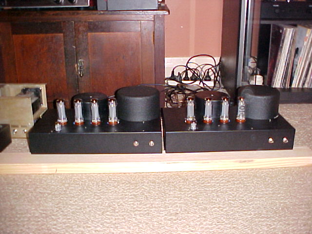

I've built up the bog standard Menno VDV amps.
12AU7 commom cathode amp, direct coupled concertina splitter/driver, matched quad "Winged C" Svetlana EL34s with the PAT4006 output transformer Ultralinear connected.
The O/P Tranny has response to greater than 250kHz and so it will be no surprise to many of you that I have a problem with "squegging" - bursts of HF on on edge of the signal.
I have managed to cure the problem in two different ways
1) fitted 1K 2W metal film stoppers to each screen connection (there were no resitors in the screen connections previously)
OR
2) 100pF cap from screen to grid 1 of each EL34.
Any advise on which is the better method gratefully received.
Ian
P.S. I lean toward 1) simply because it will help protect the output tubes - rail is +485V

Grid stoppers to the screen grids (100R - 1k) is almost always needed to stop parasitic oscillations and to limit dynamic screen grid current, with an added benefit; your EL34's will last much longer! 😉 Parasitic oscillations can manifest itself by arcing seen near the screen grid in the tube itself.
After that other methods of compensation can come into play if needed!
Wayne 😉

Final results
I settled on 1K resistors in series with each screen connection.
This worked well.
I have now converted the amp to triode mode - the 1K s did not need any modification to suit triode mode.
Ian

Will borrow the digital camera tonight and take a pic.
Ian
