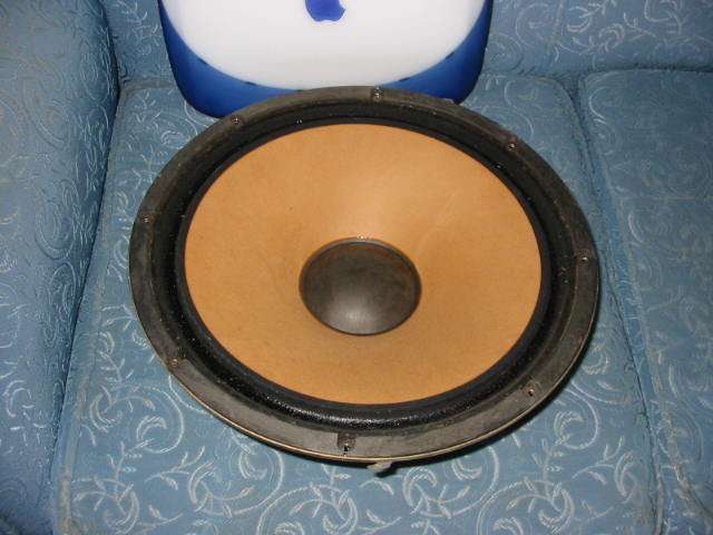

anyone ever see a large format driver with a cloth/fabric roll edge??

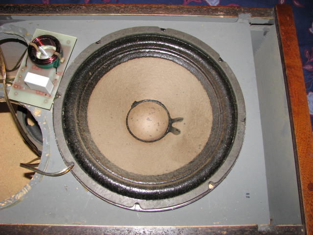

Does 15" count as large format? The Akai on the left has a inverted roll treated cloth. I've also included 10" CTS units but I'm guessing they don't qualify.
