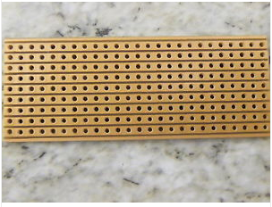

I'd like to share my very good experience with a Stripboard / Veroboard layout software package called VeeCAD. It helps you place and route components on a prototyping board called Veroboard (Europe) / Stripboard (US). See image 1 below.
Among all the software packages I investigated, I chose VeeCAD because it had these features

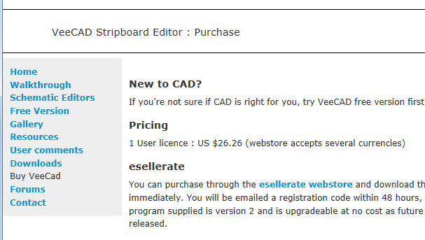

Everything went smoothly and I was able to construct and debug the board in a single day. In my opinion it's a screaming bargain at $26 and it lets me design and build something in one day; whereas waiting for an inexpensive PCB from a Chinese fab takes 8-10 days.

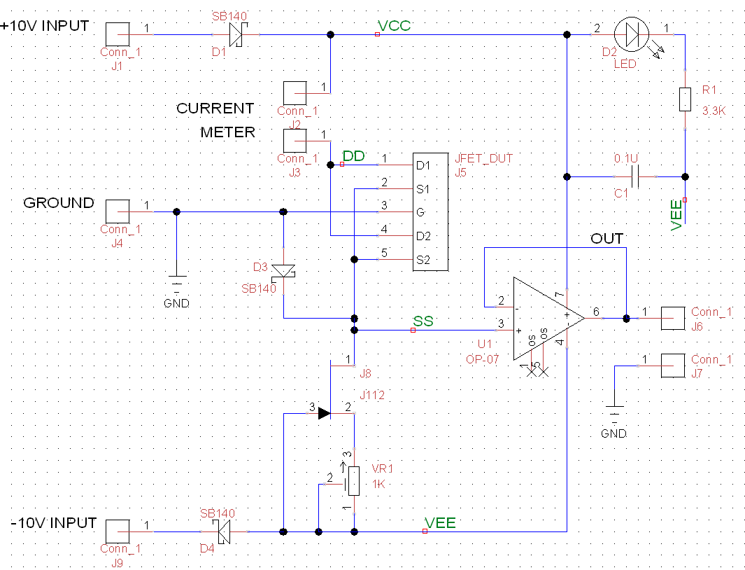

- Connectivity comes from a Schematic diagram (some s/w doesn't have schematics)
- Large presupplied library of schematic symbols and PCB footprints
- Can create and add your own symbols & footprints
- Autorouting
- Works with Windows 7-10
- Supports non-Manhattan jumper wires
- Supports arbitrarily large board dimensions
- Low price: USD 26.00 (!)

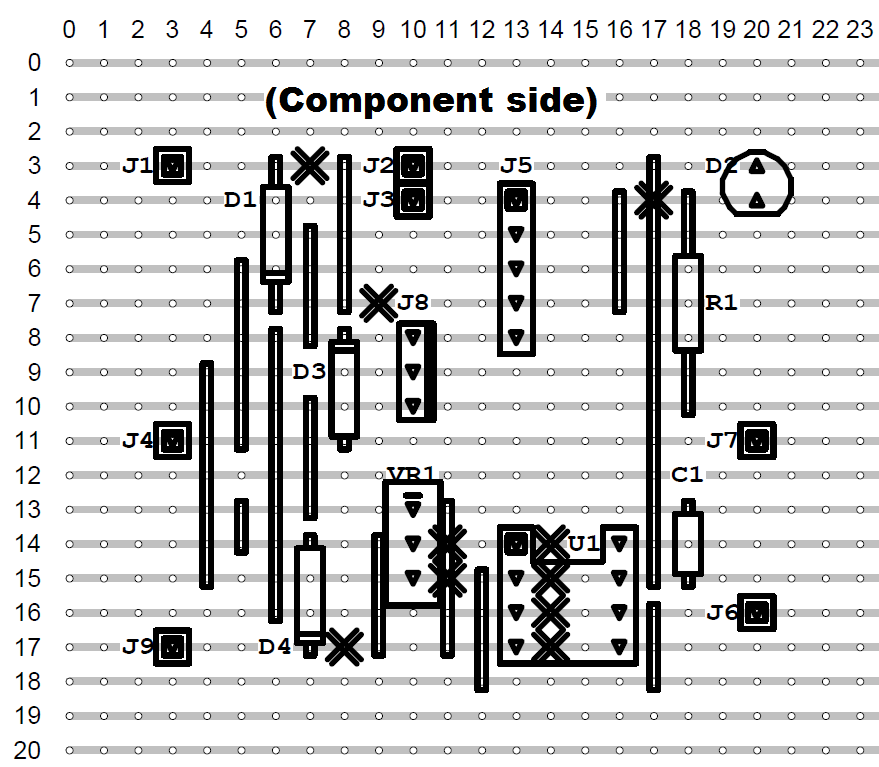

Does it auto place and route or just route?
Is it easy to hand route to improve the auto routed design?

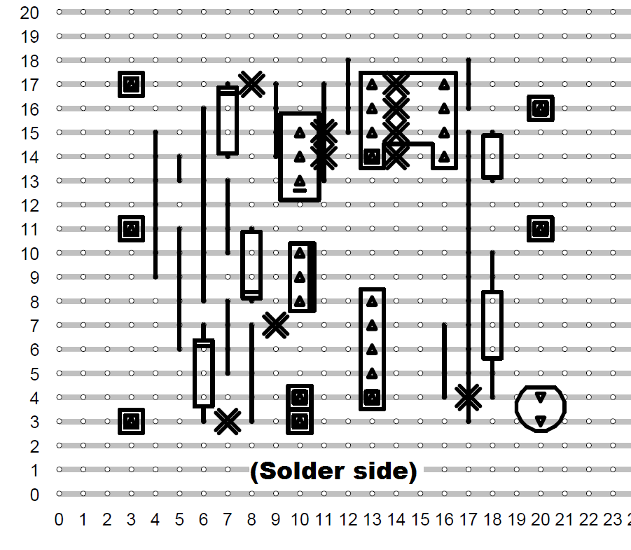

I hand-placed Cheapomodo, because I wanted to get a low inductance path between the MOSFETs and the transformer connector, and then I ran the autorouter. It wasn't difficult but I was a beginner so it took me an hour to do everything. I expect that on my 7th board it will be very easy and very quick.
It's $26 software so adjust your expectations accordingly.

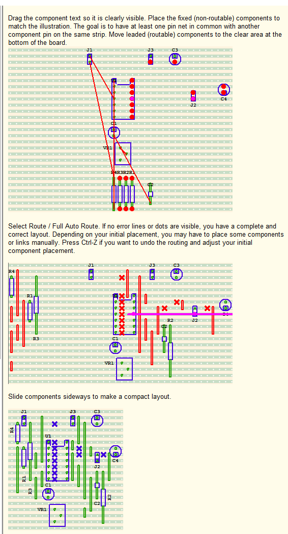

Here is what the Help file has to say. They are using the word "routable" to mean "stretchable". An axial lead resistor / diode / capacitor is stretchable: you can bend its leads so it spans 4 holes, or 7 holes, or 11 holes, etc. You can stretch it. On the other hand some components have fixed position pins. DIP16 is one example. Radial lead electrolytic capacitors are another example. In the route shown, there is a 3 pin trimpot whose pins are a fixed and not stretchable. "Jacks" (connectors) too.
Click the white cross at bottom left to see the image full size.

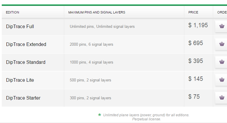

If you want to use Veroboard (Only pads, no strips), it is easy and preferable to use Diptrace with all its advantages with the grid set to 0.1 in. You can later change to a PCB without having to re-enter.

I personally prefer KiCad (free open source software) for full PCB layout. For Stripboard / Veroboard layout, $26 seems like a better deal than $75 or $145. Besides, when I buy from VeeCAD I am supporting a lone wolf hobbyist, rather than a commercial business. I prefer to support hobbyists when possible.

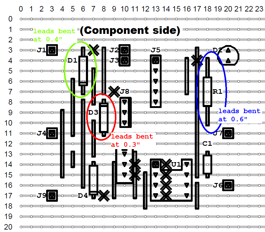

You'd need to teach your software how to cut a strip when it wants to subdivide a full-board-width strip into several electrically independent nodes. I have chosen to limit myself to making cuts AT drill holes, but others with steadier hands than mine choose to cut BETWEEN drill holes, which improves layout density. But it's hard to do and the result is prone to solder bridges.
You'd need to teach your software how to make and use stretchable footprints for axial lead components like diodes and resistors. Any given resistor might have its leads bent to fit into holes that are 0.4" apart, or perhaps 0.5" apart, or 0.7" apart, or 1.2" apart, etc. You'd need to teach both the autoplacer piece of the software about stretchable footprints, and also the autorouter piece of the software. So it can experiment with different layout placements and routings using different footprint choices.
You'd need to teach your software that the jumper wires on the component side of the board are insulated, and therefore they can cross without shorting. In effect there are an infinite number of "layers" of jumper wires.
You'd need to teach your software that N wires and/or component leads can be inserted into a single drill hole, but (N+1) cannot. Some Veroboard users have decided that N=2 is acceptable, others use N=1. I am not aware of anyone putting N=3 wires into a single drill hole but maybe some crazy person in Serbia uses AWG32 wirewrap wire for hookup?
I'm sure there are other differences; these are merely the ones that popped into my head after 15 seconds of thought

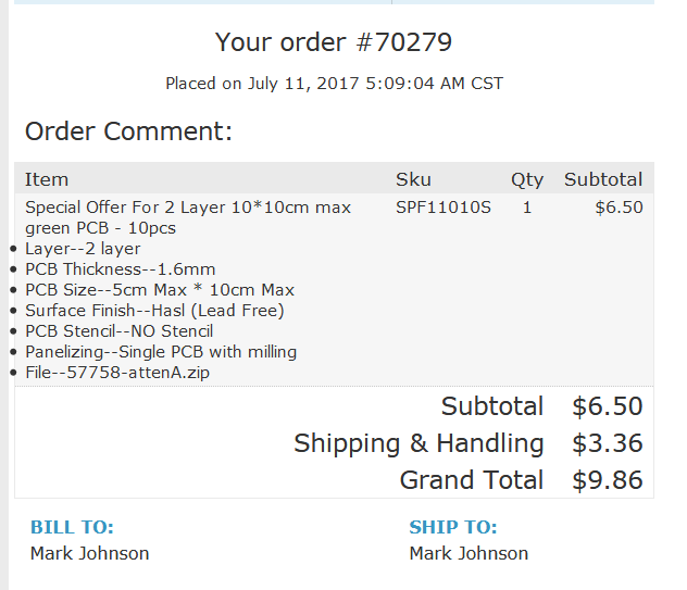

Funny, I just ordered from the Chinese PCB fab called Elecrow, two hours ago. For ten double-sided PCBs, 5cm x 10cm, I paid USD 9.86. Receipt below.
The design has a full ground plane on the bottom layer and a wall to wall ground pour on the top, with lots of stitching between, for the lowest possible inductance ground network. It wasn't a good candidate for Veroboard 😱 I don't mind waiting for international shipping on this PCB, it's not mission critical.
I found them through the wonderful website http://www.pcbshopper.com which I recommend to everyone who will listen.
