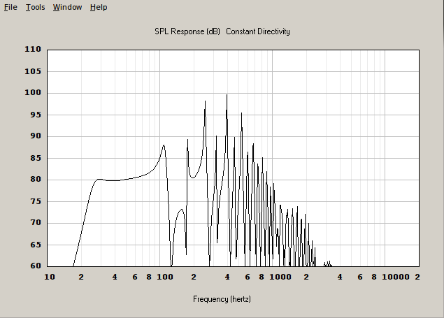

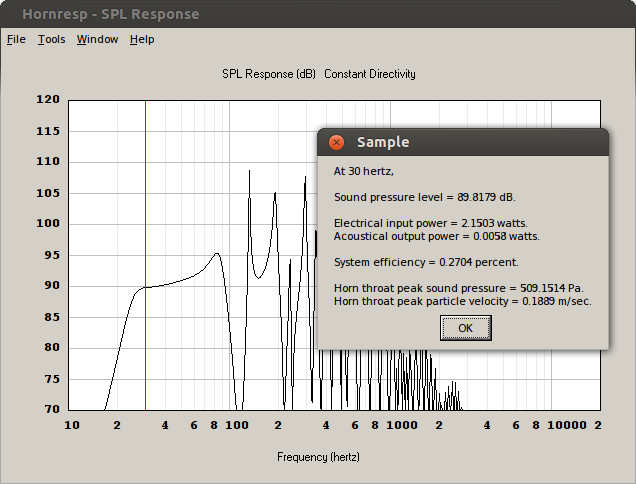

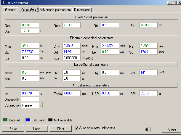

Hi everyone, I have a nice woofer laying around (salvaged from a fried Tannoy TS8 sub) that I would love to put to use. The TS parameters are measured using added mass method (pic). WinISD believes that this driver will hit 30hz in a 40l reflex box but then after fiddling with HornResp I managed to get a response I like (pic), which intrigued me as horns have a nice reputation.
Can someone more qualified inspect this horn and point out any possible flaws and/or its fesibility compared to BR? Perhaps it could be optimized in terms of size and/or performance? My goals are <~50l volume and working band 30-80hz or so
Thanks in advance,
K.

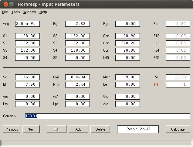

Code:
ID=29.00
Ang=2.0 x Pi
Eg=2.83
Rg=0.00
Fta=-0.22
S1=128.00
S2=152.00
Con=20.90
F12=0.00
S2=152.00
S3=192.00
Con=278.20
F23=0.00
S3=192.00
S4=188.00
Con=20.90
F34=0.00
S4=0.00
S5=0.00
L45=0.00
F45=0.00
Sd=176.00
Bl=7.50
Cms=3.86e-04
Rms=2.44
Mmd=39.00
Le=0.90
Re=3.20
TH=1
Vrc=0.00
Lrc=0.00
Ap1=0.00
Lpt=0.00
Vtc=0.00
Atc=0.00
Pmax=100
Xmax=5.0
Comment=TS8 BH

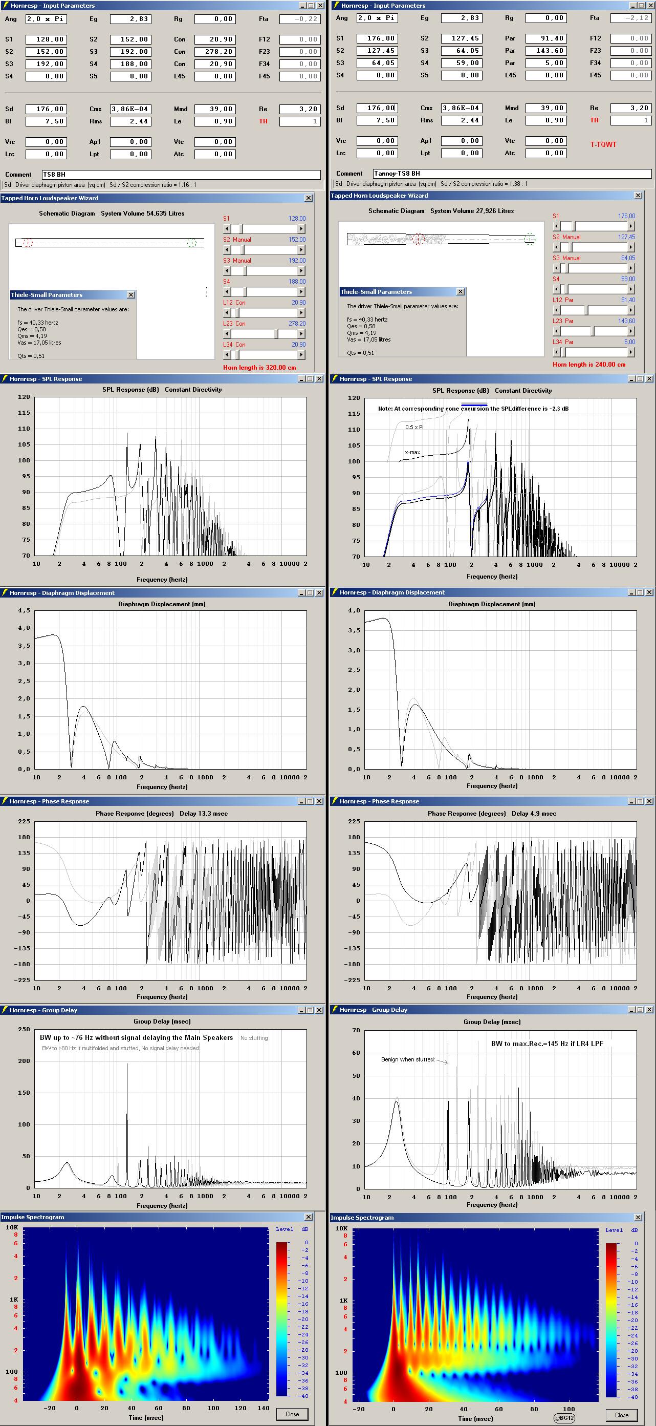

Hi K,
Have a look at this:
b🙂
PS: FYI,Added a Scandinavian more potent sub suggestion using IMO great drivers from another nearby Baltic Country. 😀

My God that was quick, thanks a lot for this eye opener! This tqwt to be in a completely different league at almost half the volume... Any tips for the actual folding/implementation?
Regarding the other driver, it does seem very impressive but I guess it will have to wait for a bigger listening room and more tolerant neighbors 🙂
P.S. How do you put all the graphs together so quickly and tidily?

You know 'Practice makes perfect' 99% is just cut and paste..For the moment I think you should browse this forum for folding tips, there are quite a few.
I posted the other suggestion in order to put 'Baltic' driver manufacturers on the DIY-Mapp.
I understand your concerns regarding the need of a larger room and worries of what neighbor would say if this sub is cranked up above 100 dB.
b🙂

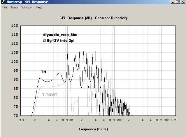

After playing some more with different designs, it seems that while tapped horns are somewhat inferior in performance to T-TQWT, they are also a lot less sensitive to minute parameter variations. I mean, just a couple cm on any dimension in bjorno's design leads to huge resonances. Unless of course HornResp is exagerating stuff. Any input on this is welcome, especially bjorno.

Yes, for 2-2.5 octave 'sub' apps, a TH is a better bang/buck solution IMO, especially since it's more tolerant of driver specs variation.
HR doesn't exaggerate per se, it just doesn't account for any acoustical losses due to friction, construction material's damping, etc.. Build it out of thick, highly polished steel though and I imagine the measured response would be much closer, especially WRT HF 'ringing'.

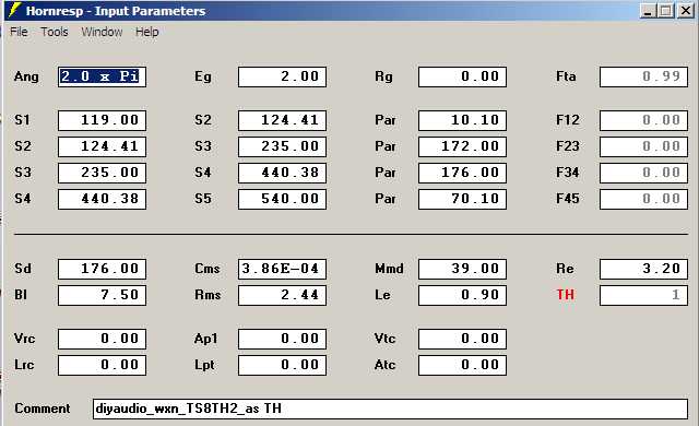

I played around with HornResp a lot and I think I found the optimal first build for me. It seems to have respectable response, reasonable tolerance to parameters and way simpler to fold than a T-TQWT. You know, one can always build another subwoofer 😉
Attached are the data and simulated graphs, any comments are welcome, I am one phone call from ordering the panels for this horn.

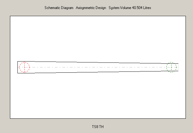

Hi wxn,
Your example in Post #12 is a typical T-TQWT (in Hornresp you use TH to model this), the folding depends on the final form factor you want to achieve. Looks good to me.
I'll attach a quick comparison of your driver in T-TQWT (40.5L) or TH (126L).
