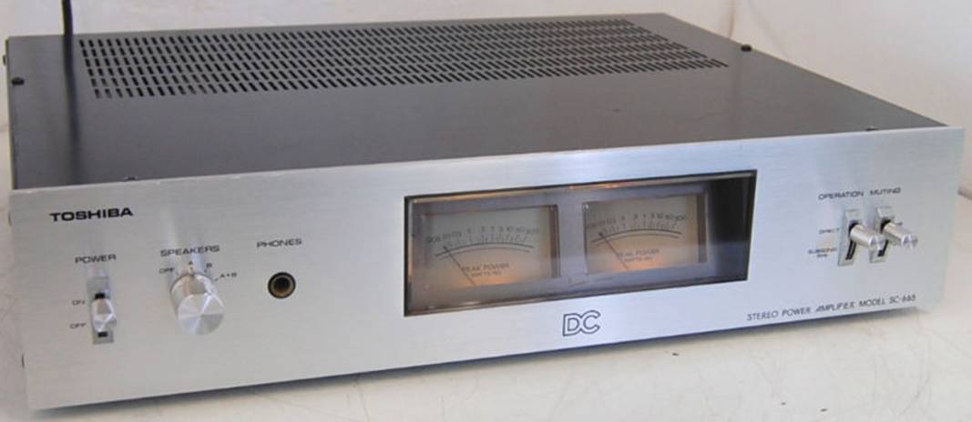

can i offer any help .... The unit is not actually Toshiba ( i think ) i think its actually Tensai but i may be wrong ...schematic seems not easy to find but i will keep looking
in between is there anything i can do ? amplifier like that should be a walk in the park to repair

this is the closest i can get ...you may down load from here
All the best
sakis
www.eastelectronics.gr/images/Toshiba SC530.pdf

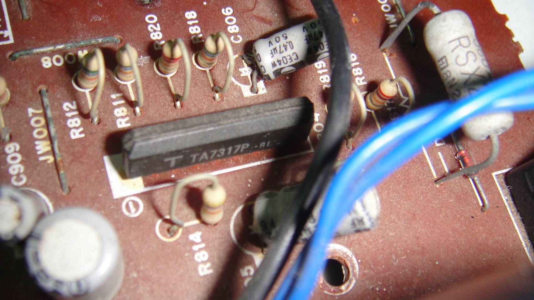

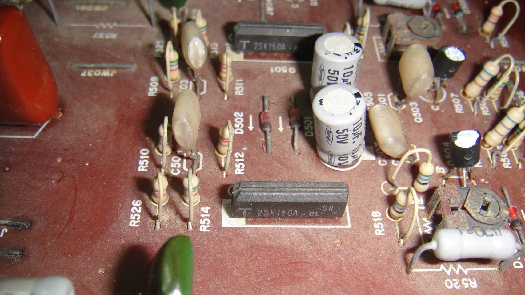

Very kind from you Sakis
The guy does not speak english...he lives in an island.
I will try to help him...he has DC in the output, the positive rail in the output, i have asked him to check all transistors, diodes, resistors and capacitors...ALL checked...none damaged.
Now he has suspections about the input dual Fet, then he asked a friend that can travel and bring these fets to him.
I will continue to help him till he fix or give up.
