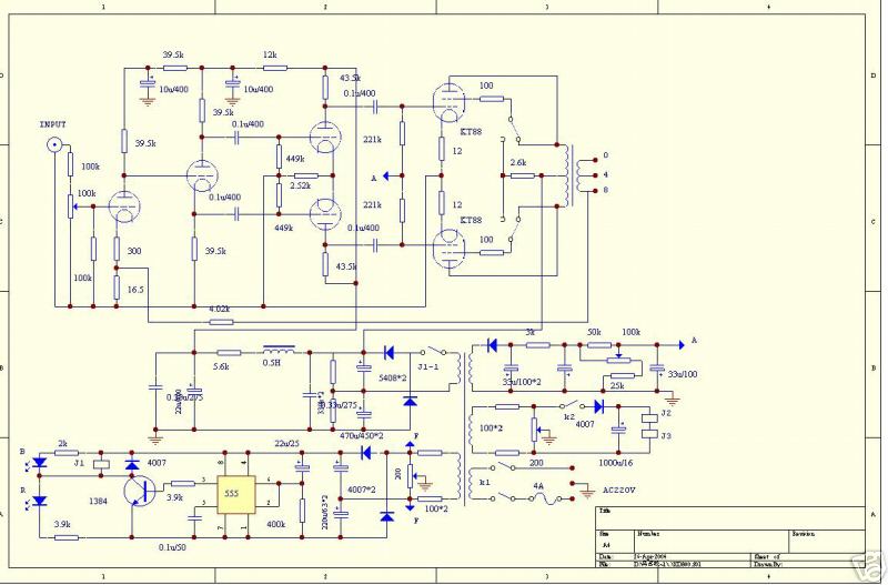

Thanks Skorpion,
Hififactory,
The circuit is not the same as the Music Angel EL34 so some of my comments above are not relevant.
Actually its a YAW.n "Yet Another Williamson". There is more information on upgrading the Williamson design around the net than you can probably get through in a year.
Make sure you are running in Triode Mode for a start. On the switch which selects Triode / Tetrode Mode the position which is quieter (but more refined) is the Triode position. You CAN switch between the two with the amp running BUT its perhaps not a good idea to do it at full power.
On the schematic bottom right hand side you will see a 100K potentiometer and "-> A" this is the output tube bias adjustment.
Just one adjustment for both tubes so it important to use matched pairs. You would want to do both channels so its best to buy a matched quad. Each KT88 has a 12 Ohm resistor in the cathode.
Exactly 1 volt across a 12 Ohm resistor means 83 mA bias current and I am guessing that that is the correct bias setting.
Check first - measure the high voltage at the KT88 anode. For 35 Watts dissipation divide 35 by the high voltage reading to give the bias current to set. Multiply that current by 12 to get the voltage reading across the 12 Ohms cathode resistor and then adjust the bias potentiometer to give that reading. For long tube life you may want to set for 32 or 33 Watts rather than 35.
The value of the KT88 grid 1 resistor is 221K Ohms and this means that you should NOT run more than 35W anode dissipation even though the KT88 is capable (with smaller grid 1 resistance) of a maximum of 42 Watts.

It looks like the Power Supply Board is common to both the EL34 and KT88 Amps in which case the bias adjustment potentiometers are the one closest to the front of the board (one channel) and the one closest to the back of the board (the other channel).
