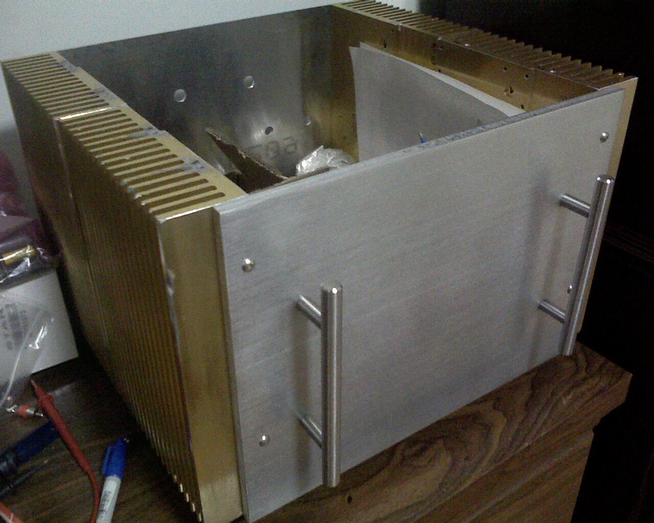

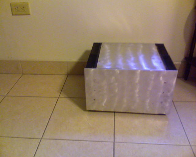

You should try the F5. Meets most of your requirements. Depending on the mosfets used, it can sound bright or more mellow without loosing the highs.
Hard to find something more simple and has short-circuit protection.
You can get boards in the USA or EU.
Heat sinks are fairly large. Mine are 2"x12"x18" (inches). See photos.
I wouldn't go smaller than that size.
I also think the Mini-A is a nice amp, but not as good as the F5.
I believe because of the speed and clarity of the F5, the stereo image is more etched in space. And if you do it right, it is so quite and with a very black background.
Having built two F5s with different parts and they both sound slightly different, but the clarity is always there.
Good luck and have fun!!
Vince

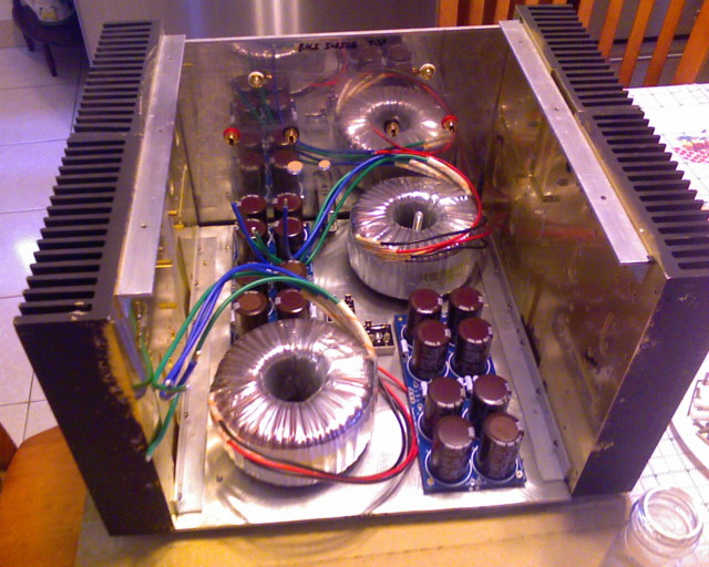

An aleph would do it easily enough. Build a mini - aleph at the lower voltage rails and single outputs. Bias it up until you're heatsinks are at the edge of your comfort level... I used irfp150 as it's basically two dies in one package, and +/- 19v rails to reduce total dissipation.
Drives my Abby clones nicely. 🙂
I use an Aleph too. Mine is the Aleph 4 but that is quite a complex build due to matching of 24 Mos-Fets.
http://www.kk-pcb.com/ would give you a little insight as to the various options, there are far more.
These are all Class A designs, they all involve huge heatsinks and massive Power Supplies.
The Aleph 3 is a relatively easy amp to build as long as you grasp the idea of matching the Mos-Fets.
