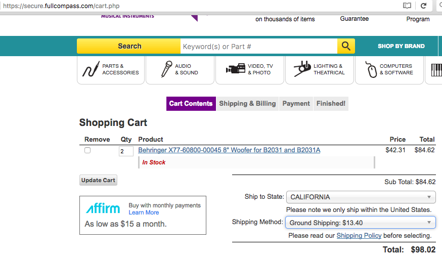

I don't think I really need to duplicate the sound of the original. If I wanted a proper tuned, balanced, and flat monitor I would definitely go for off the shelf. I am just looking to salvage these for non critical listening, while still getting the best sound I can, without going to to much trouble.
If that's and official replacement driver, I'd definitely go for it. I wouldn't be surprised if you couldn't find something "suitably equivalent" from Solen for the same landed price. With the loonie currently "surging" towards $.82 , they're almost affordable. At the very least, I'd give them a call, and ensure they're familiar with the appropriate commodity code for raw speaker drivers to ensure you don't get busted for duty, and also whether they can ship via USPS, to avoid the Fedex or UPS brokerage fee surprise.
Too bad they don't ship outside USA....
missed that little detail - too bad
yes, something less than perfect be the likely result of something that "fits in the box"
Yes unfortunately that won't work. I will have to settle for something less than perfect.
No friends with a PO box across the border?
jeff
HelloYes unfortunately that won't work. I will have to settle for something less than perfect.
This looks reasonably close for ported enclosures but might be worth buying 2
I checked, they ship up to Canadia😉 BUT you might call and see if they use USPS.
