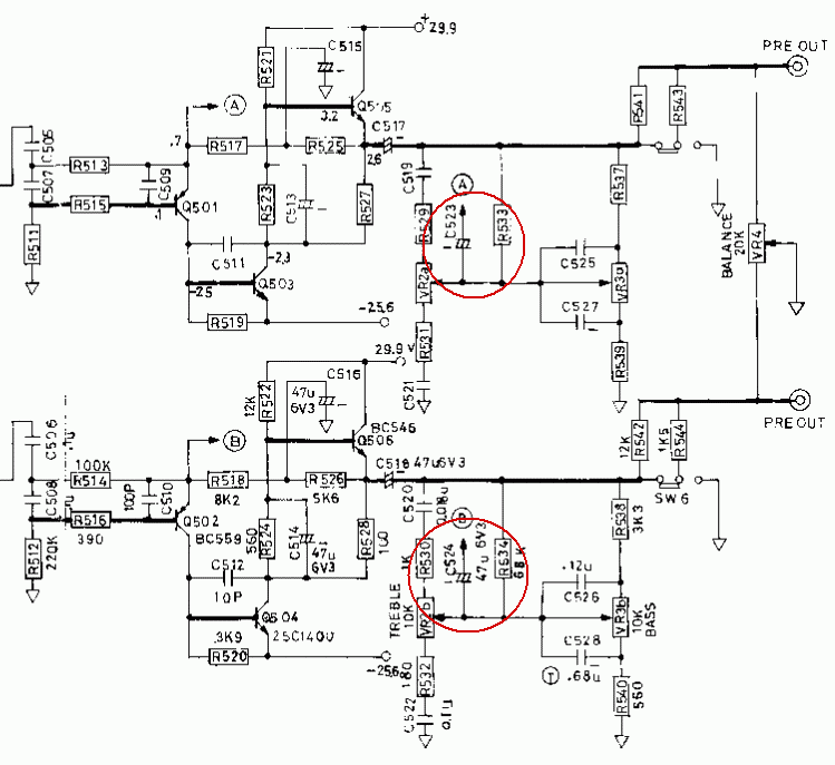

Hi there. I need your help. I need to know the values of two electrolytic capacitors in my NAD 1020 Pre-amp. They are located on the board about 1 inch behind the treble pot. They are marked C533, and C531. Thank you for your help. John.

Are they missing or something ? No markings on the originals ? Lineups link shows only one as an electrolytic, but I think I can make out some kind of text on there. C531 = 0.12 mfd ??? and C533 = 4?? could that be 0.47mfd or 4.7 mfd. You certainly won't harm anything if you get it wrong. 0.47 is a value that could be an electroylitic but it's small.
this is the preamp section of NAD 3020 ( http://www.tcaas.btinternet.co.uk/index-4.htm )
There are two R531 and R533, but no capacitors with these numbers.
The values is in the lower channel. some values not easy to read.

Mooly, Lineup, The schematic you sent me Mooly is close to the 1020 but it ended with C528. It appears that the pre-amp section of the 3020 is not exactly the same as the 1020, but close. Lineup, Your schematic shows C531, and C533, but does not give values. Oh, these are Caps, not resistors. My grand daughter decided to grab these and play with them outside, and I can't find them. But thank you guys for your trouble, I really appreciate it. Maybe someone will have the schematic for the 1020. Again thanks, John. 😀

I made a NAD 1020b pre-amp clone long time ago, so I got pcb scans and all values of the components, but did not find the original 1020b schematic, but as I compared with other models of NAD integrated amps, the schematic is quite similar or equal in some parts.
So this is what I wrote for C:
C533=47microF/35V
C531=47microF/63V
This is from the original 1020b I made a clone and still listen on it.

Are these the same 47uF caps as C524, C523 in my posted schematic?

But, I think no, because if C533 and C531 was for the purpose and place where is signed red in your posted schematic than this caps should be the same voltage and for that purpose" for the feedback" usually is no more than 10 volts., and i wrote in my paper that c533 and c531 47 micro farads both but 35 & 63 volts so I am guessing that this caps are in other place , not the place you marked..

in the meantime when uploading this image I found my old papers and found there that this C533, minus pole connected to anode of D505 and R550, so this caps is for the mute option perhaps and C531, but now this is not important.
Line up I also found the same purpose caps you red marked in this NAD1020B that caps are C525 &C526.
So now I hope everything is clear, and John again I hope I helped you, because the values of the caps I gave you is 100 % true.
