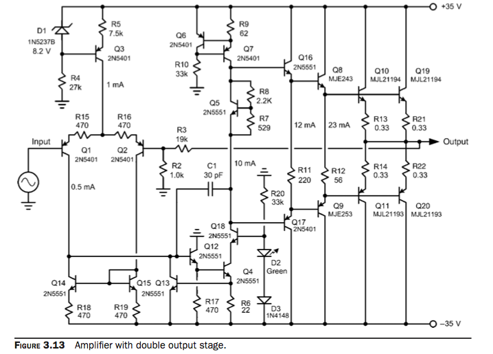

I was looking for a reasonable amplifier to build for a multi channel system. I like Bob Cordell's book and so decided to try and build an amplifier he goes through in there but I'm having some issue with it on the bench. This is the Cordell amplifier:

Attached below is my schematic.
Now, these are the problems I'm experiencing:
1. I have 7V of DC offset at any supply voltage from +/-12 to 30V.
2. If I raise the bias current above about 30mA the current draw from the PSU will suddenly raise to about 1A with some oscillation on the output with 7V offset.
3. I do get a good looking output signal however the gain is small and will start oscillating on the negative half above about 2Vpp on the output.
I can tell you the input transistor base (Q2) is at 0V and the base of Q3 is at 1/20 of 7V.
The tail current for the input stage is 1mA (the designed amount) and the legs have approx 500mA in each.
The VAS has the designed 10mA running through it.
I see the large DC offset reflected in the VAS too.
That's about it at the mo. Please if anymore information is needed I'll get it. Any help would be fantastic!
Thank you!
There are some parts missing from the attached schematic.
There must be some resistor at the input. The DC blocking capacitor missing from the feedback network.
This amplifier is simply not useful.
OK now I checked the pdf too. Add the DC blocking capacitor series with the 1kohm feedback resistor. It will solve the DC offset.
C5 was not in the original schematic.
Sajti
That circuit is for educational purposes, and lacks certain practical refinements.
See p. 76 of the 2011 edition. Resistor R2 requires a series 100uF NP capacitor
to lower the DC gain to unity. That should lower the offset considerably.

Designing a stable, direct-coupled power amplifier with 0VDC offset is difficult.
Usually a servo or a unity gain capacitor in the nfb loop is necessary.
Using matched input devices, thermally coupled, does help.
A practical and reliable amplifier will look much different from a textbook circuit.
Each design is unique, and can take much time to bebug. A finalized version
of this circuit did not seem to be in the book. It's very likely that there are
multiple issues that need attention before the textbook circuit will work properly.

See fig. 3.16 for starters. Adding these functions should help at least some of your problems.

The input transistor's base current flows to ground through 100.47 kohm of resistance. The transistors are biased at about 500 uA each and their hFE is between 50 and 240, typically 100 (see http://www.mouser.com/ds/2/149/MMBT5401-889782.pdf). Hence, one would expect a typical voltage drop of about 500 mV, but it be anything between 200 mV and 1 V. Amplify it 21 times and you can easily get 7 V of offset.
A capacitor in series with R14 will reduce the offset roughly 21 times, because the DC gain is reduced from 21 to unity. With the capacitor added, you can reduce R15 to 18 kohm or 20 kohm such that R15 + R19 ~= R13. This will reduce the DC voltage across R15 + R19 and if the input transistor's hFE's match, the drop across R13 due to Q3's base current will then cancel the drop across R15 + R19.
The only thing that doesn't quite add up is your claim that Q2's base is at 0 V. It can't be unless the amplifier is switched off.

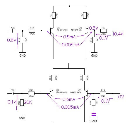

> I do struggle to see how I get 7V of offset at the output just from not having a cap in the feedback path.
Just figure the actual resistance, current, voltage, gain relations around the loops. Simple networks. No great accuracy needed here. NO SPICE NEEDED! Matchbook and a few fingers. See Attached. I rounded the hFE of a '5401 to "100" and got an error some higher than yours. Smells like your '5401s are hFE~~140, which is OK by the datasheet.
> mismatch in the input transistors?
No; mis-match of base REsistors.
Analysis below assumes perfect match. Mis-match will cause an additional error. But if you make Q2 base resistor "small", resistor drop is small, and mismatch error will be small. If you additionally put the _DC_ gain to unity (the cap), the errors will not be multiplied by the audio gain (makes them 21X bigger).

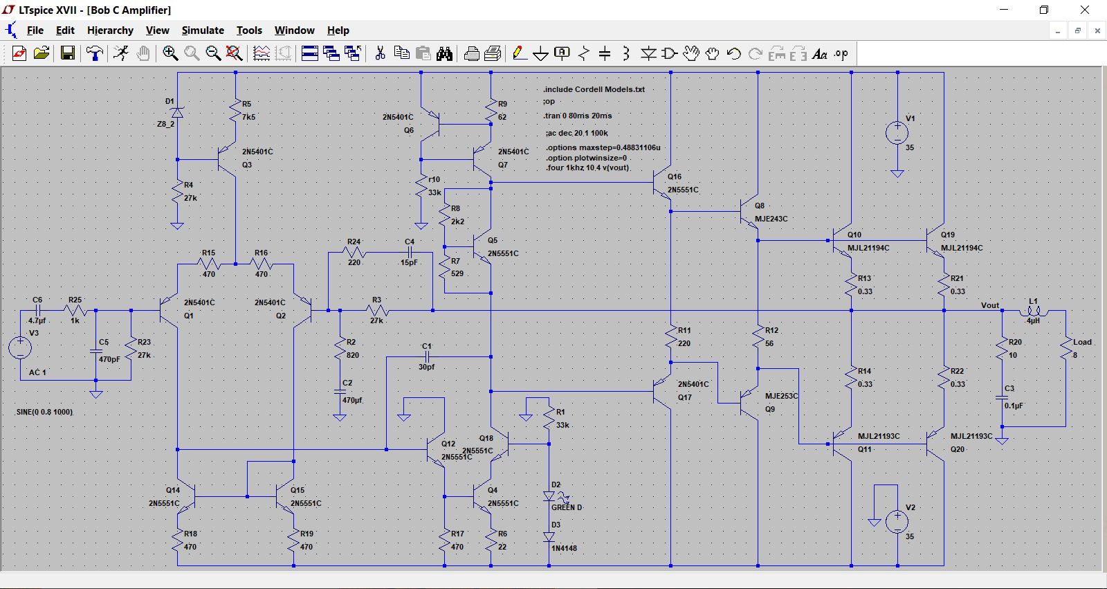

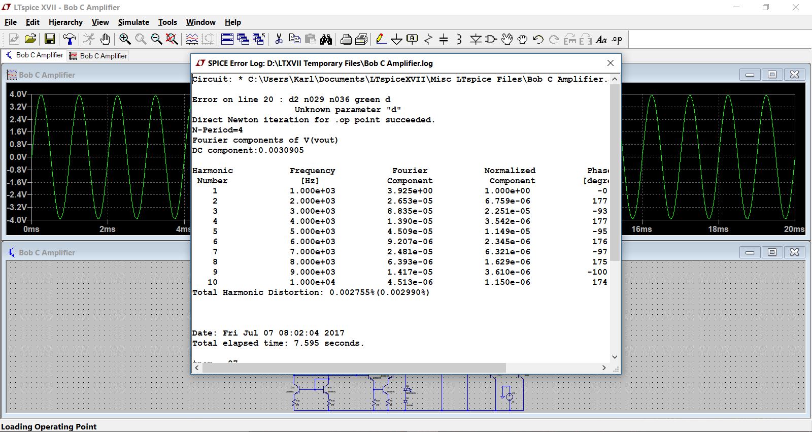

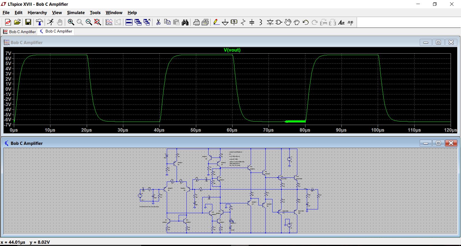

I had a play with this and have attached the .asc if anyone wishes to continue. I made a few quick changes but found the stability might need looking at more closely. The last shot shows something going on but whether it is an artefact of the sim I wouldn't like to say. However other tweaks I tried also showed stability issues (such as decoupling the vbe multiplier).
