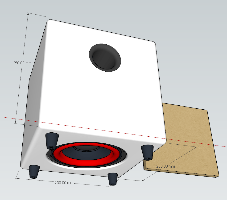

-Box size: 25x25x25 cm made from 15mm MDF (30mm board at bottom for stronger driver mounting)

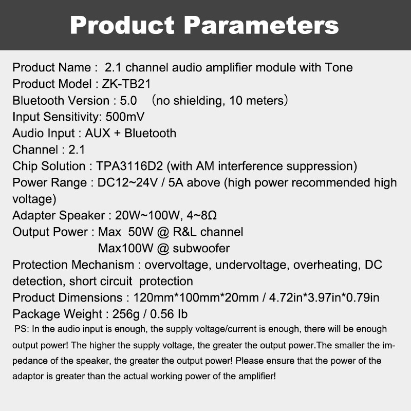

-Amplifier: ZK-TB21 TPA3116D2 Class D (32-pin original)

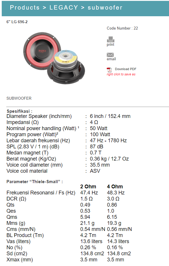

-Subwoofer driver: 6-inch Legacy LG 696-2 (parameters are attached)
-Ventilation port: 5 cm diameter with a 16 cm long port

1. How much power supply wattage do I need for this setup? Is using 19V 2.37A = 45 watts enough?
I have this adapter from an old Asus laptop charger with a DC port.
2. With these subwoofer specifications, is running at 2 Ohms better than 4 Ohms?
3. Is my box design suitable for achieving a soft and deep bass character? I will place the subwoofer under my computer desk.
4. My subwoofer box design is inspired by the Audioengine S8, but dimension-wise, I followed the Audioengine S6, which has a 6-inch driver and similar box dimensions around 25 cm. Is this good get smooth and deeper bass profile?

If this is a subwoofer that you're going to use as part of a multimedia system for your computer, then 45 watts should be more than enough, unless that subwoofer driver is really inefficient.
Do not run that driver at 4 ohms. The paper suggests that to get 4 ohms you should connect only one voice coil of that dual-voice-coil driver. Don't do that. It's a DVC driver that's 4 ohms per coil, so design for either 2 ohm or 8 ohm use.
As for the box, use a box design program like WinISD to see how the driver will perform in the box that you're planning to use.

The smaller woofer you propose to use has an Fs = 48Hz, Qts = 0.86, and Vas = 14 litres. Its Thiele–Small parameters seem to make it unsuitable for use in a small vented box such as the one you are thinking of using.-Subwoofer driver: 6-inch Legacy LG 696-2 (parameters are attached)
