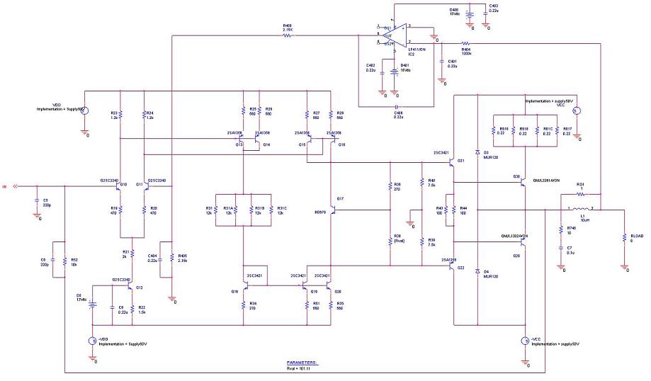

I'm going to attach the complete schematic...maybe can be usefull.
What do you guys suggest me to do after having checked all the semiconductors and capacitors?

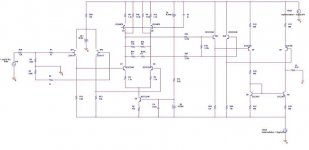

Do you guys suggest me to plug just the pre part and not supply the output stage and see what i get out of the pre-section (checking with the scope and signal generator at the input)?
here is the pre stage...
